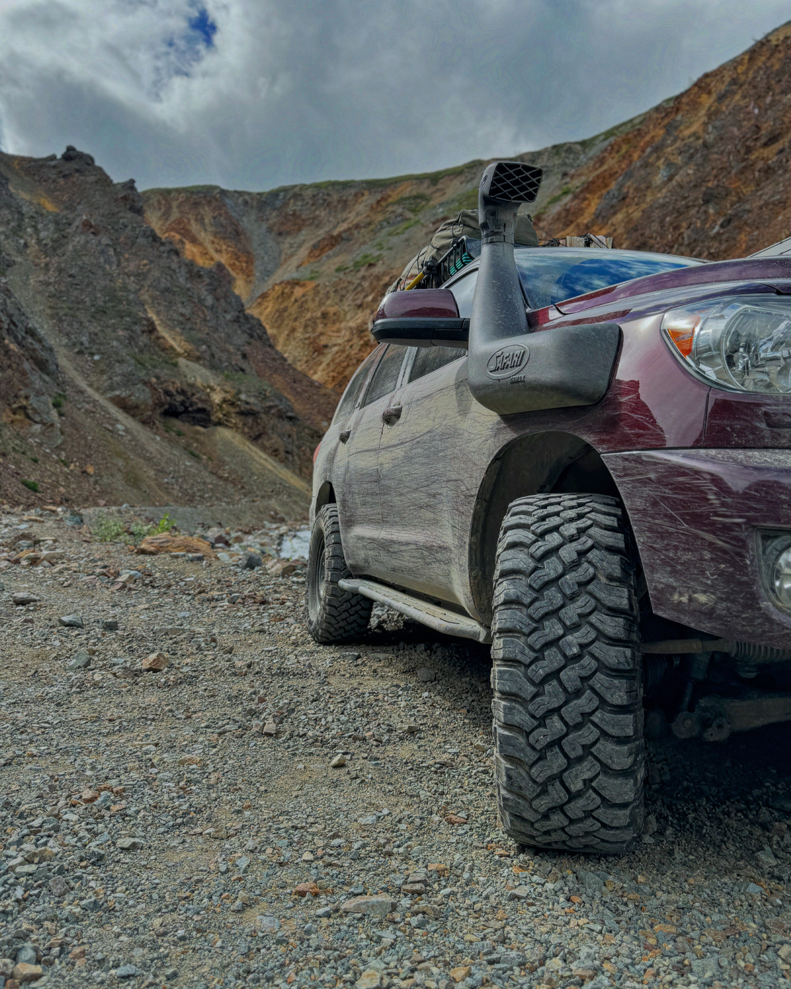

  • ARB safari SS88HPE snorkel (install video here):

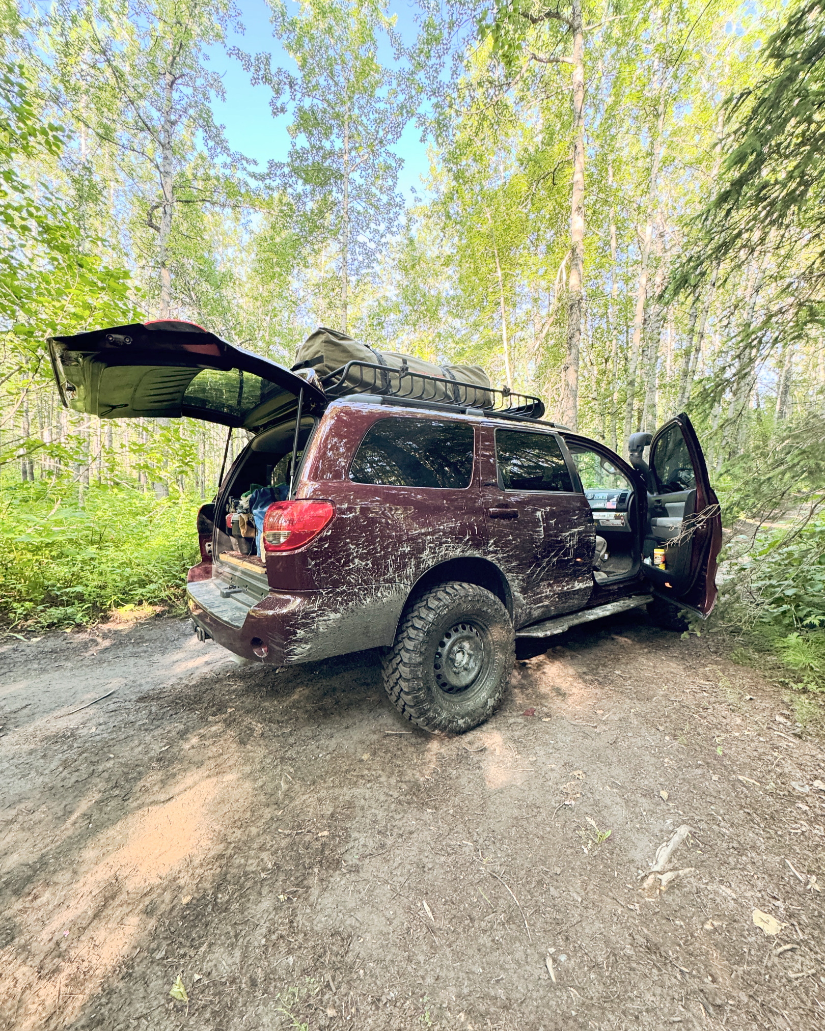

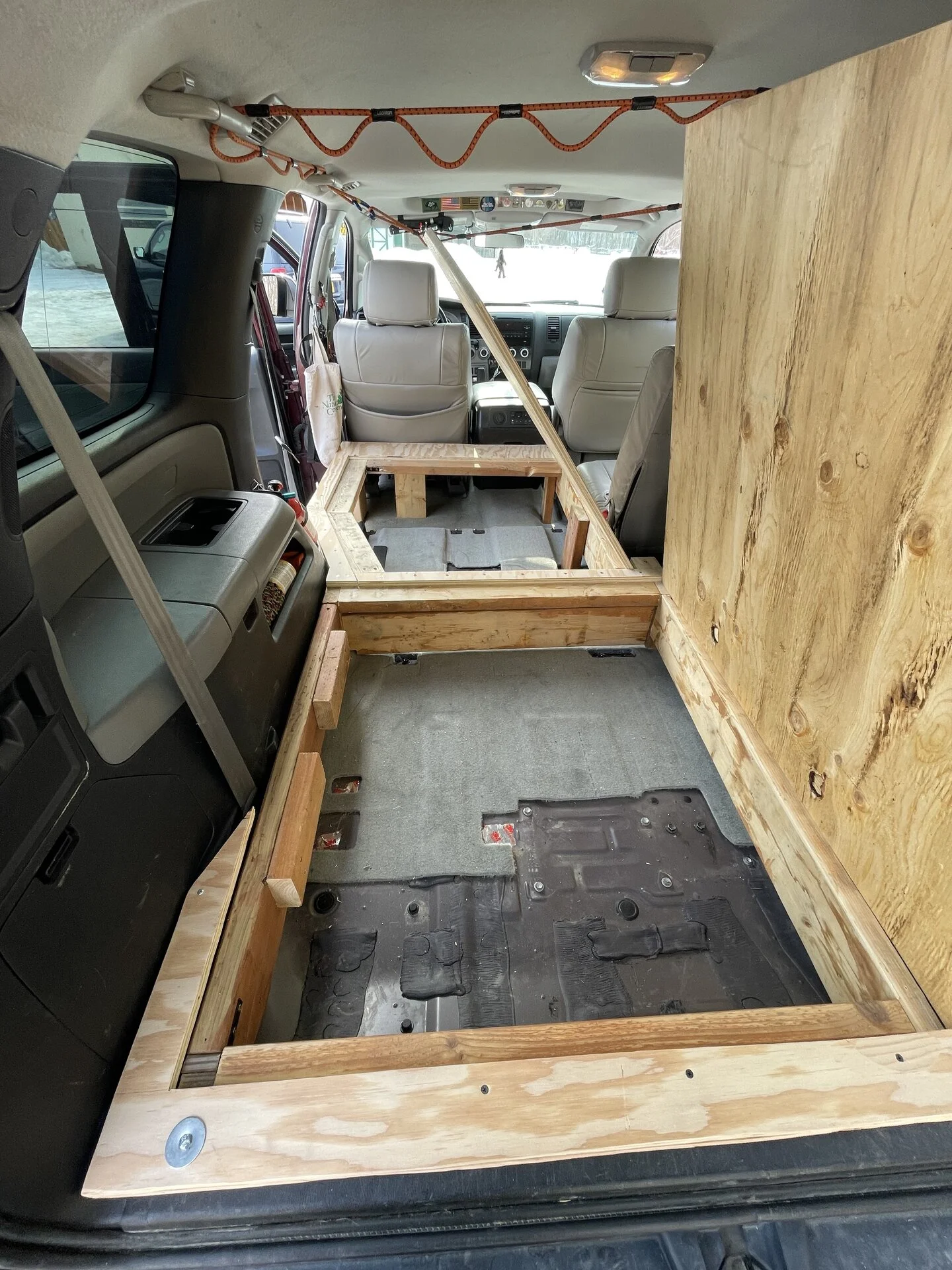

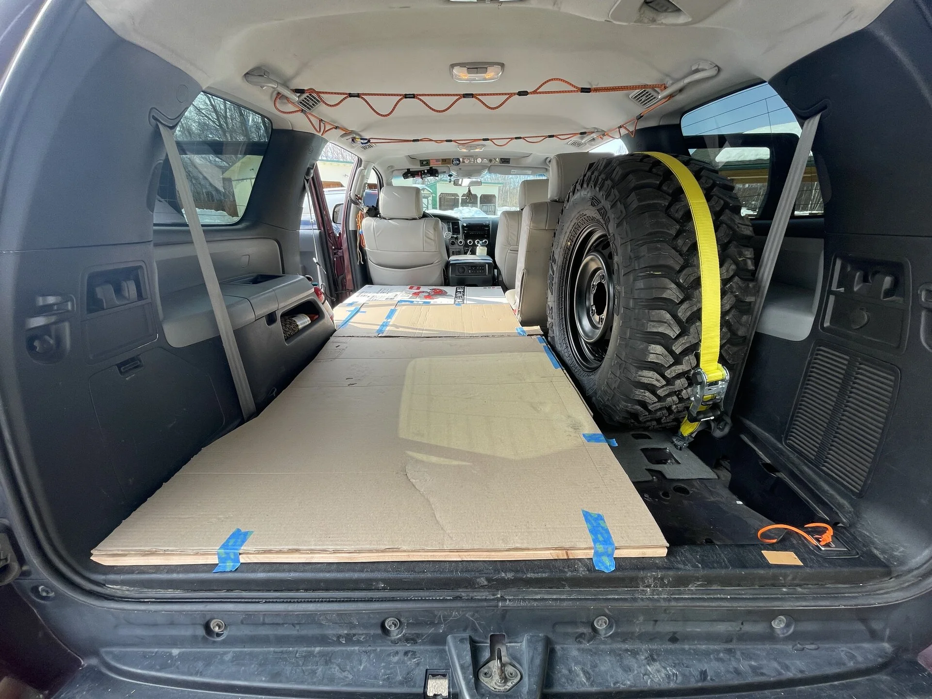

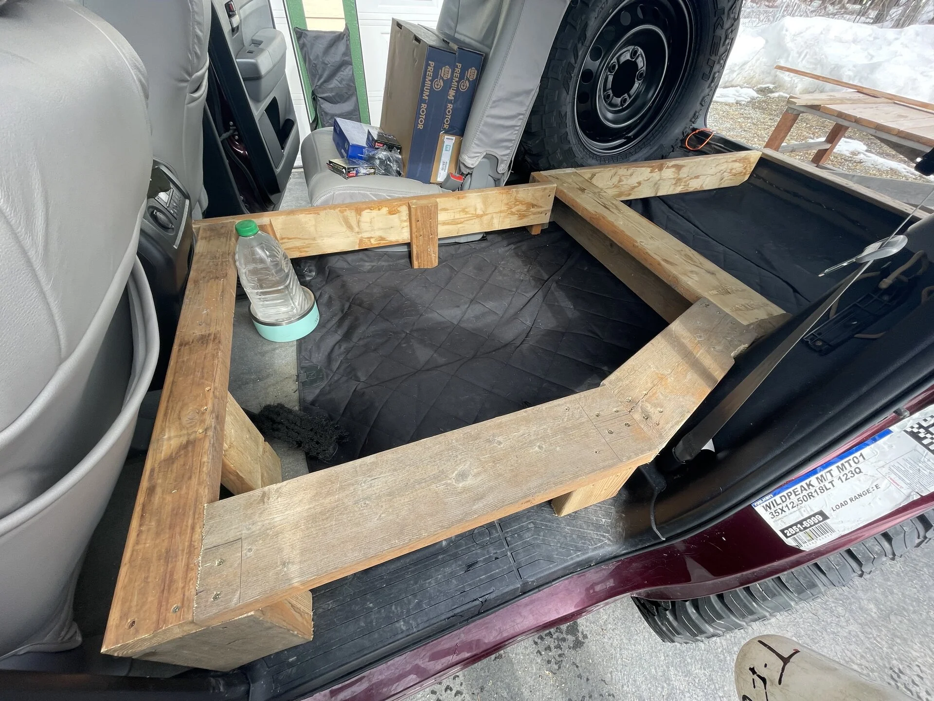

Some pictures of the rear box set up. Was a little challenging because after the seats were all out the floor went through like three different heights from the back to the front. Finished product has been great - couldn't imagine it without all this storage now.

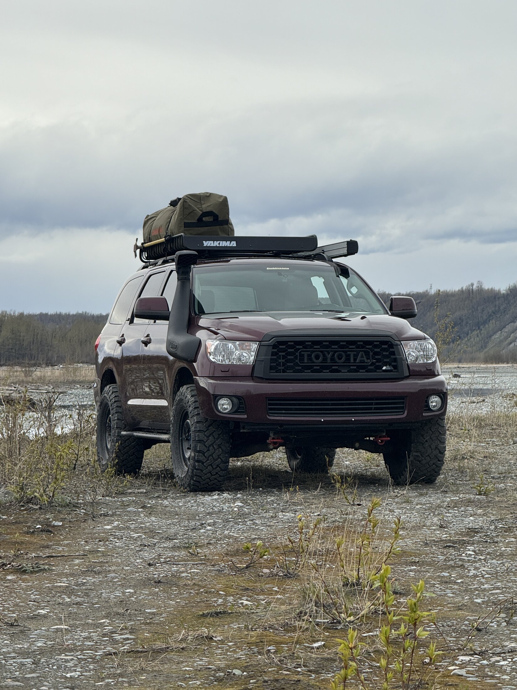

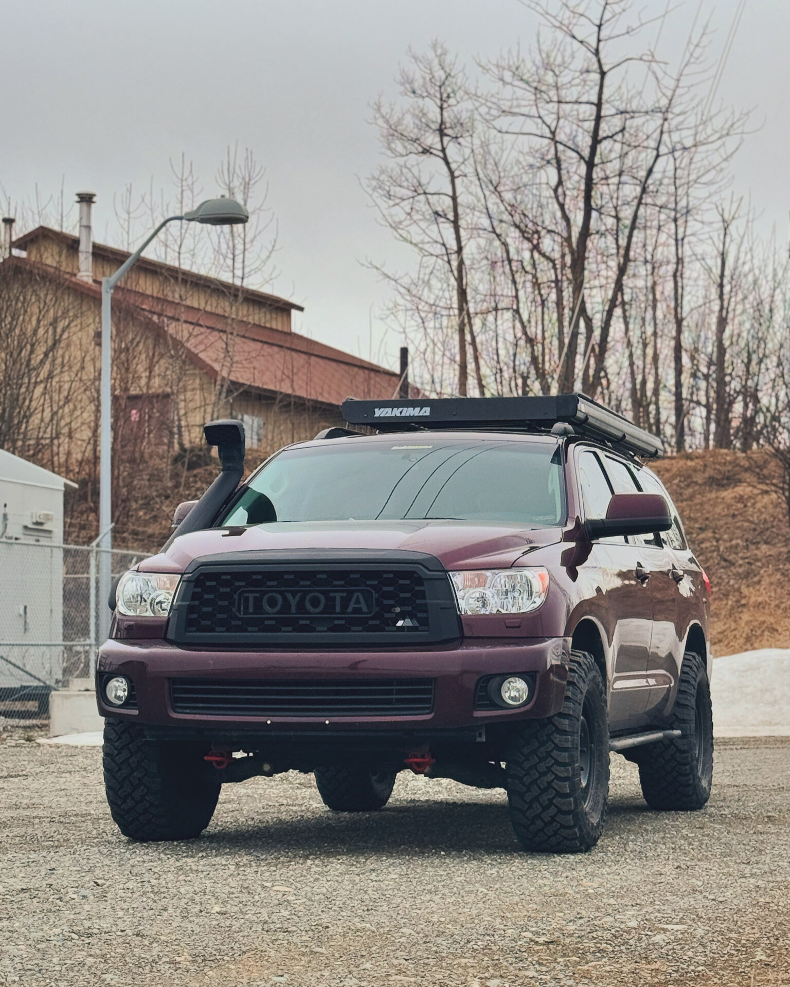

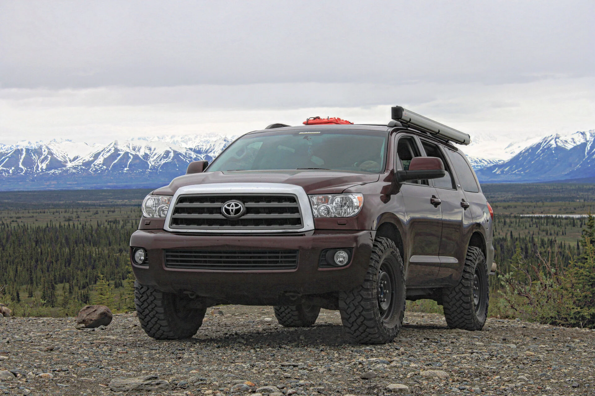

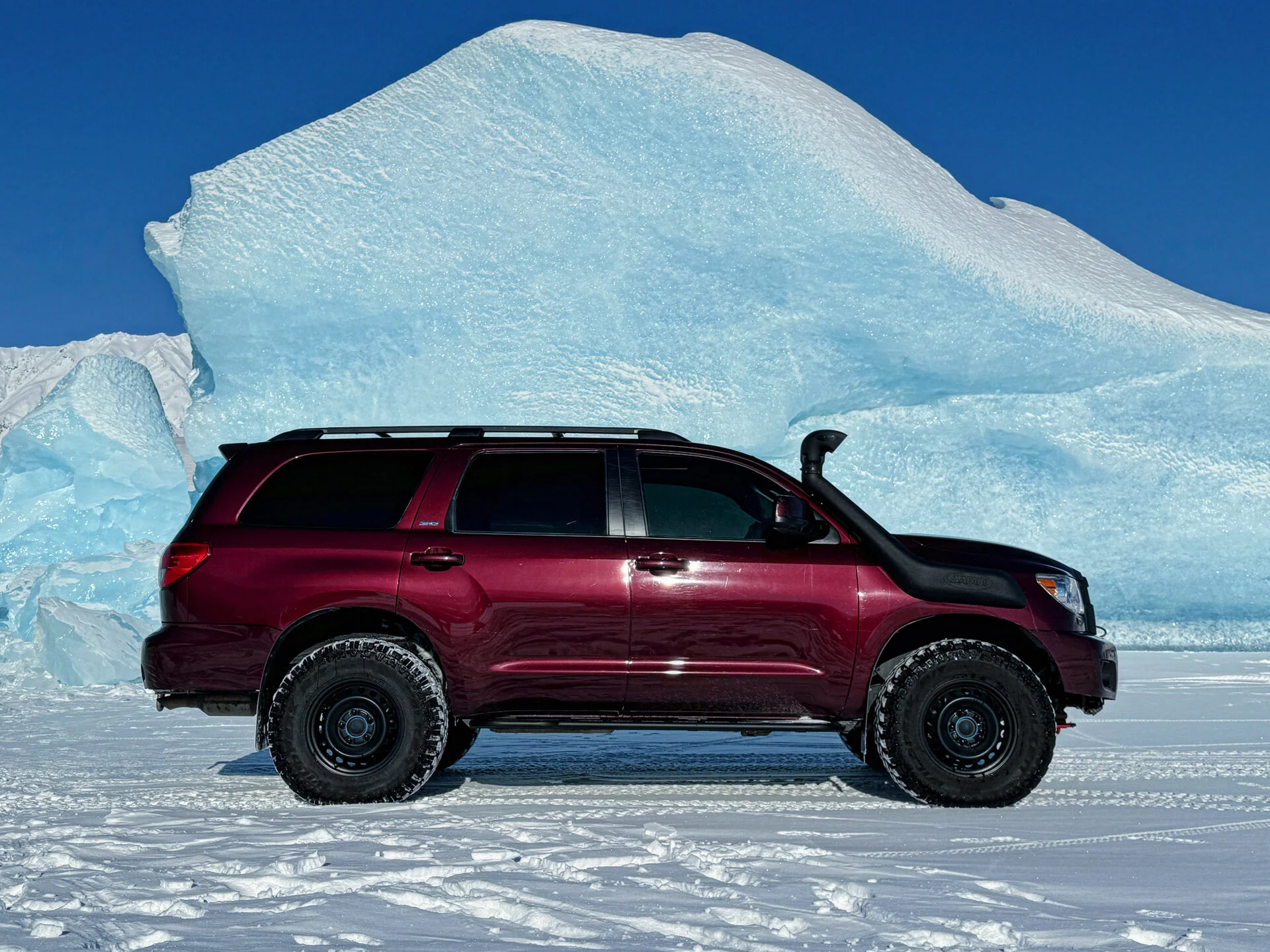

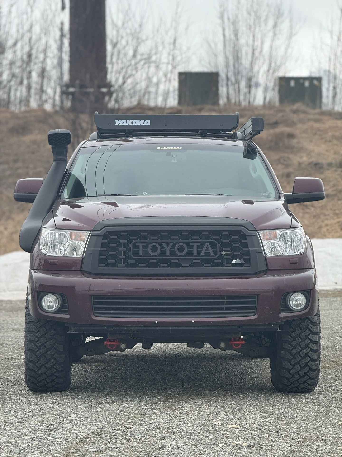

Got my mega warrior mounted up for the summer season this week, and the camping kit dialed in. Plastidipped the awning and the front emblem just for kicks. Should be seeing my skid package from Tandem Offroad at the end of the month, will be looking forward to throwing those underneath (especially the fuel skid) for some peace of mind.

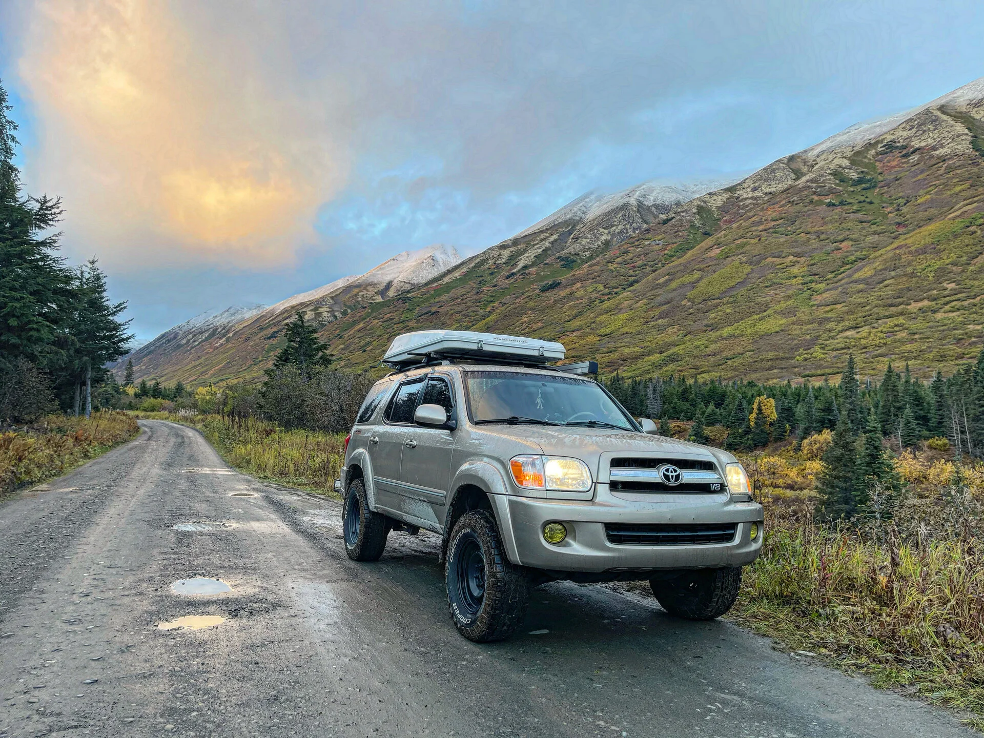

I just bought a 1g Sequoia to use as a daily so I am looking forward to keeping this thing in the shed and ready for adventures. Some updated pictures from today:
Thanks for posting some pics and specs. I have the same color Sequoia, stock aside from Bilstein 5100's though. I have been threatening to try my 315/70's on black Icons on there off the Tundra, after seeing your truck I have to do it now.
Throw them underneath and let us see them! 315/70/18 is a really cool tire size, especially for guys running OEM rims since the measured width on the tire is usually 9”. Glad to hear there is another purple tree out there!
That 1st gen will serve you well. Easier to work on, ultra reliable, better fuel economy...just lacks the sex appeal and the working hatch handle, Lol. Loved mine, it's what drove me to buy another.

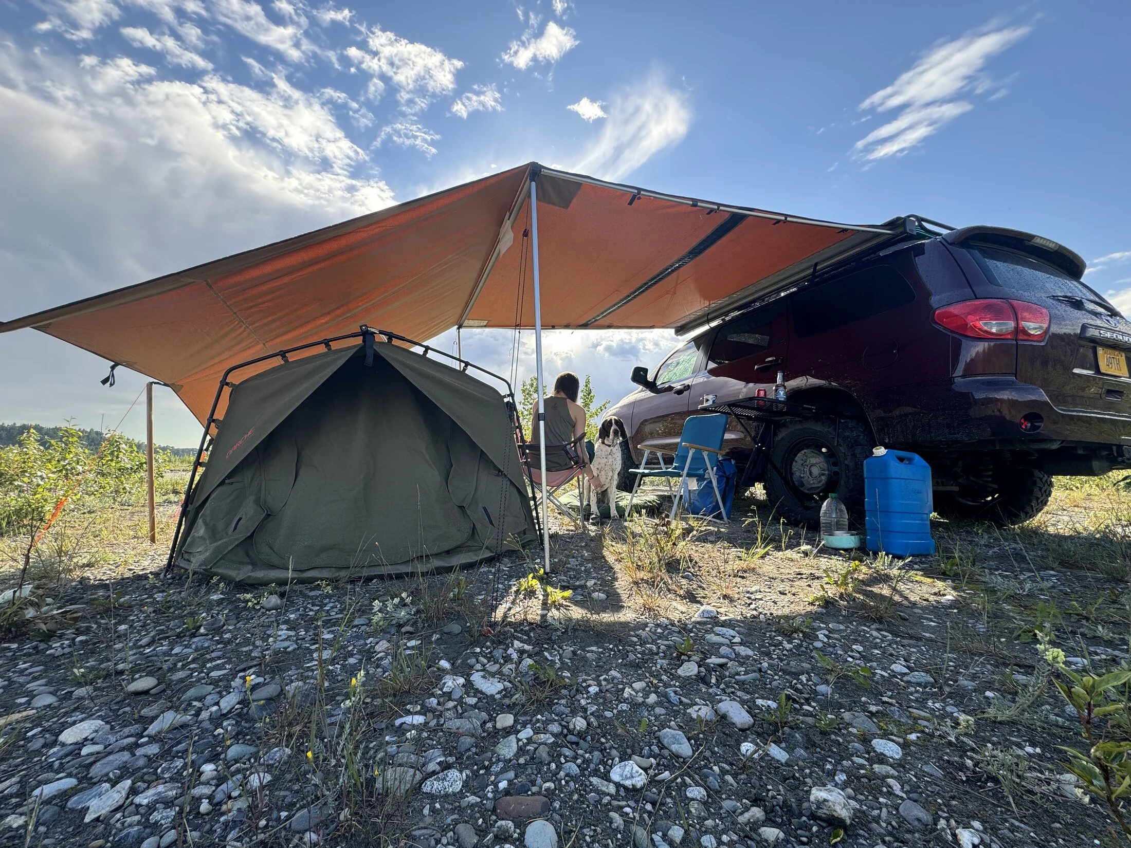

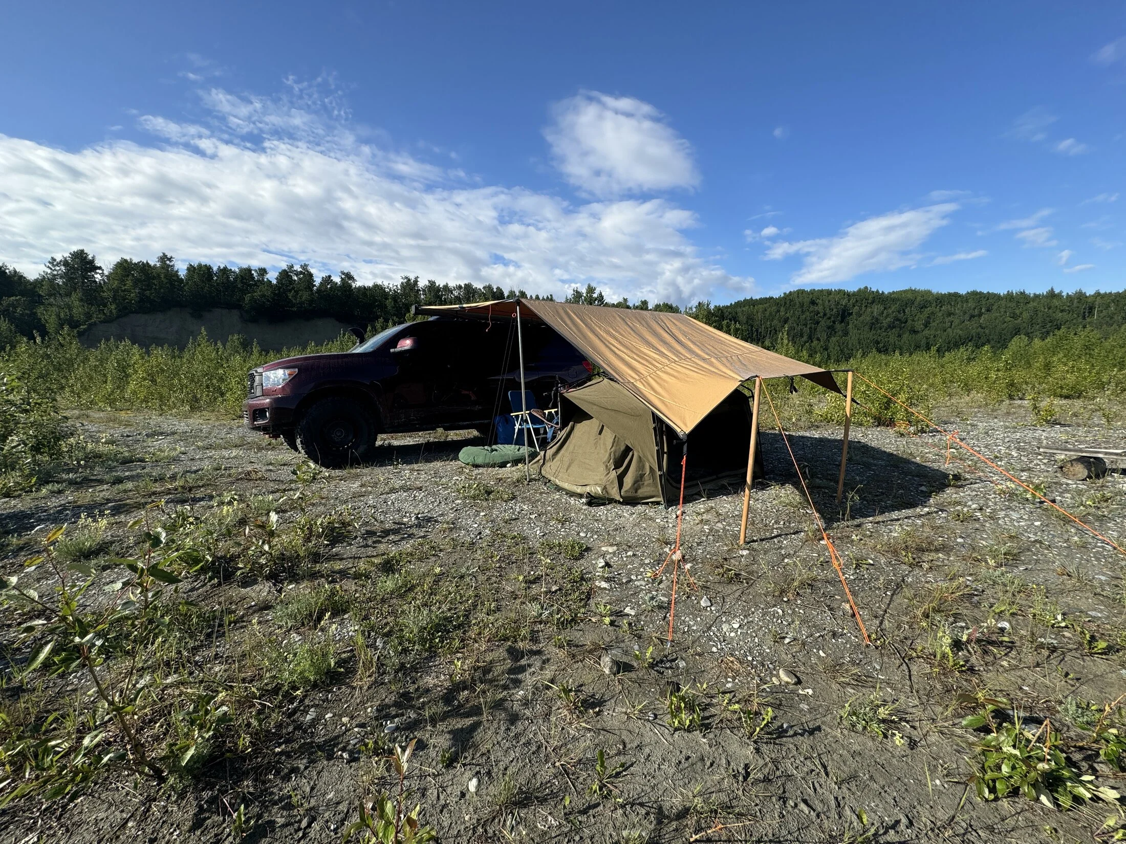

Some stuff from this summer. Running a Darche swag for the season. That combined with the ARB awning has been exceptional. Got the tandem skids installed as well, a good kit but took awhile to get to me. I think it was just a single run, anyone looking for skids may be better off going with RCI.

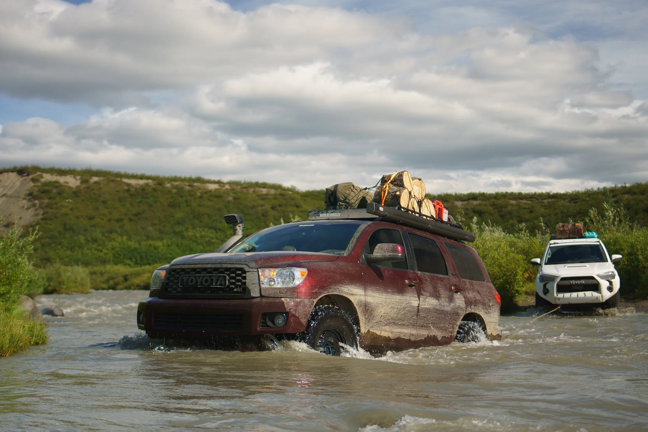

Been a solid summer. Only issue was a starter going out after 850 miles of hard water crossings and dirt roads.
Your passenger looks way more calm than mine during a water crossing. Doesn't matter whether it is 4" deep or 24" deep, my wife does not like driving through water.

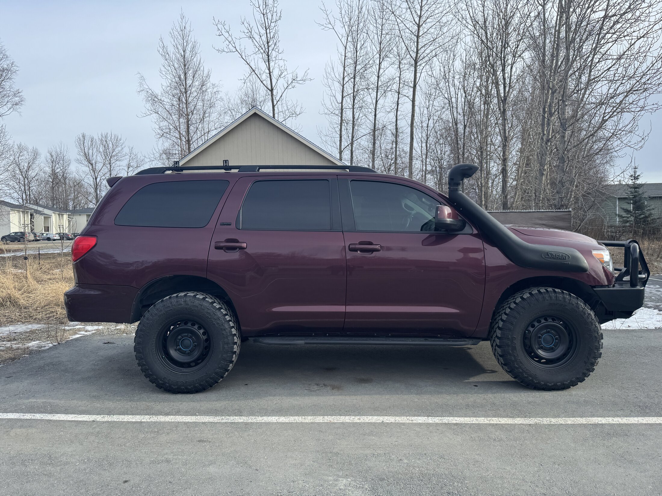

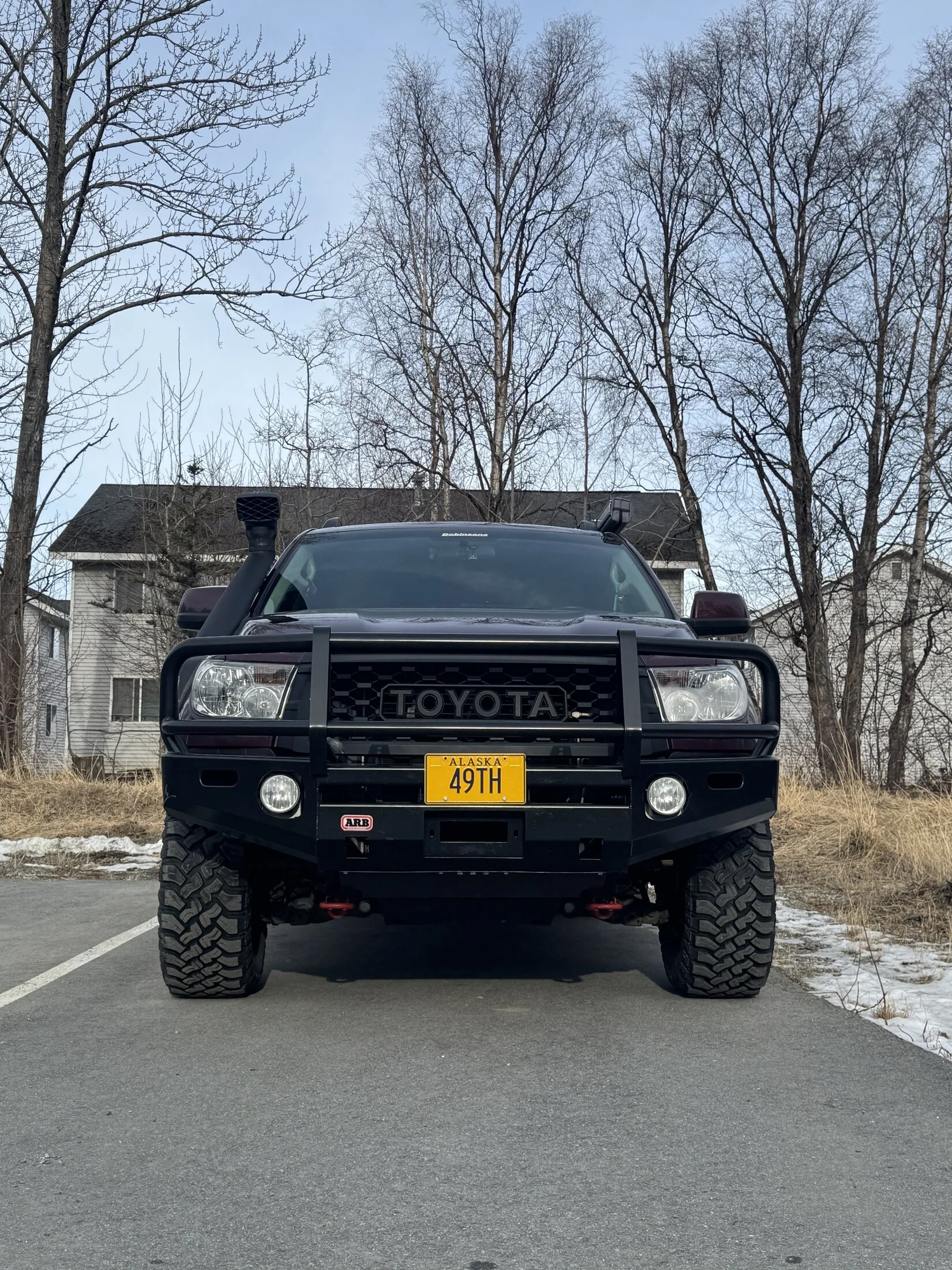

Got the ARB slapped on there. Been dreaming of picking one up for years and it finally came together for me. 5.29s, rear Auburn and front Eaton locker going in at the end of the month. LFD crossbars on order to run - not a fan of the bulky roof racks. Should hold the swag, maxtrax and shovel nicely.

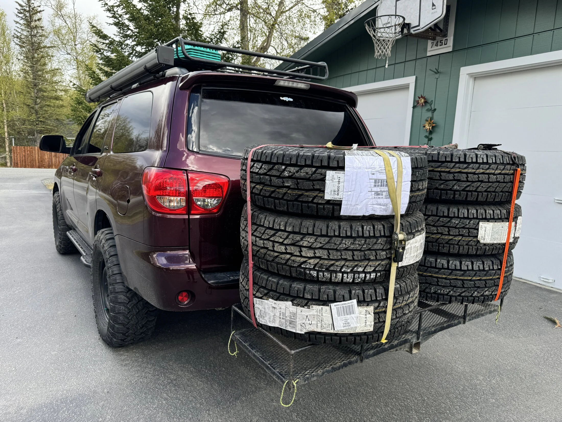

285/75/18 cooper stronghold at’s on order, looking forward to ditching the spacers and getting skinny for the summer season. I figure losing the MT traction can be made up with the lockers, and I’m looking forward to dropping around 20 pounds a corner.

That ARB is looking good! Looking at your Sequoia I'm starting to think I need a snorkel, But....then again, I know that I'm not fording rivers with a small lift and 35's. There is too much electrical to worry about if water gets in the cab. I took it through some stuff that was at least 12-14" in spots during hunting season, that's likely as deep as I plan to take mine.
Yeah if it doesn’t make sense, I wouldn’t sweat it. The intake is already pretty high on these even without tires and lift. We get into stuff 100’s miles from home and I just wanted that extra insurance policy. From what I’ve seen the door seals are pretty good at keeping out water, but I’m definitely not parking in a river (ideally..)
