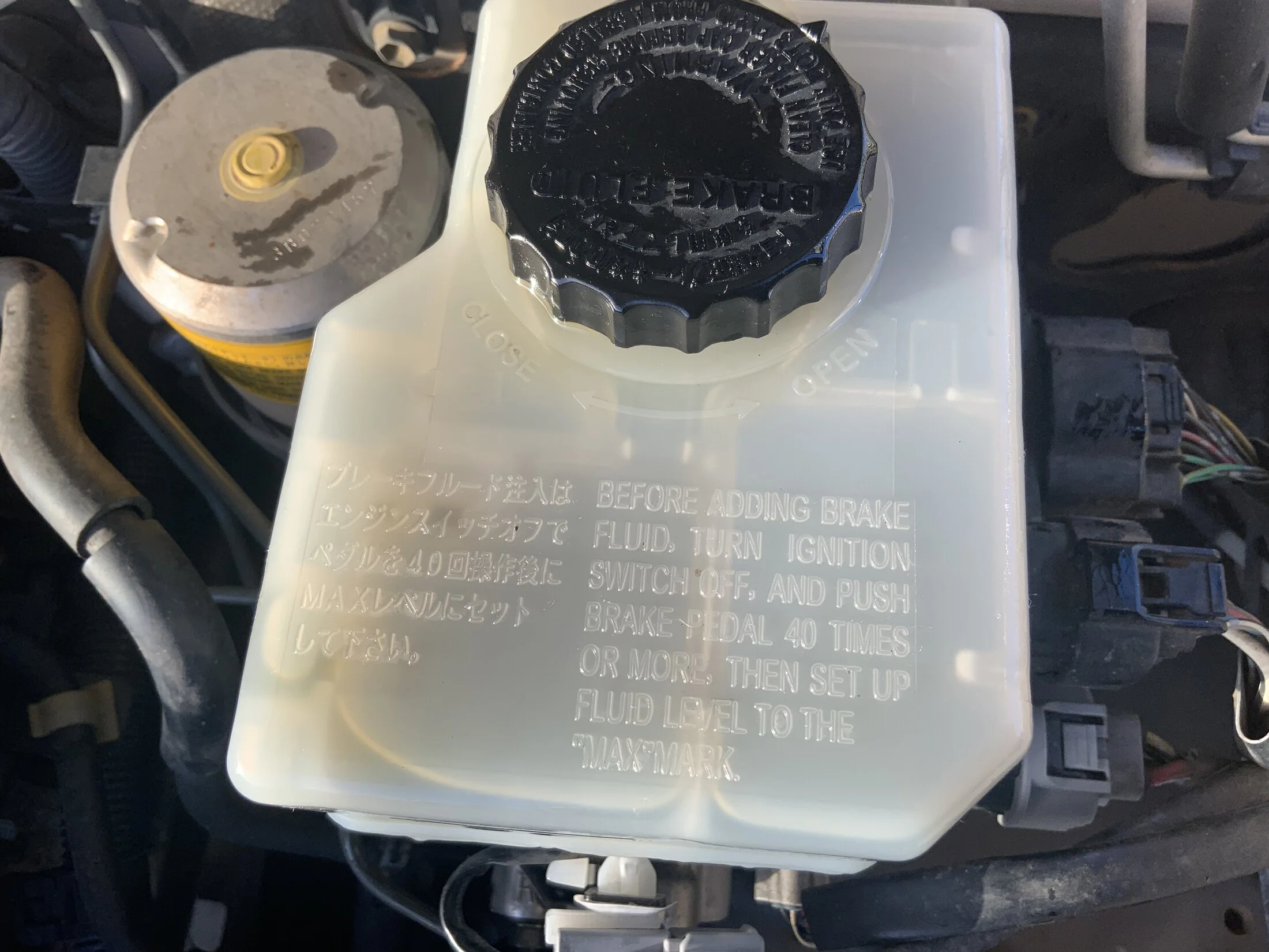

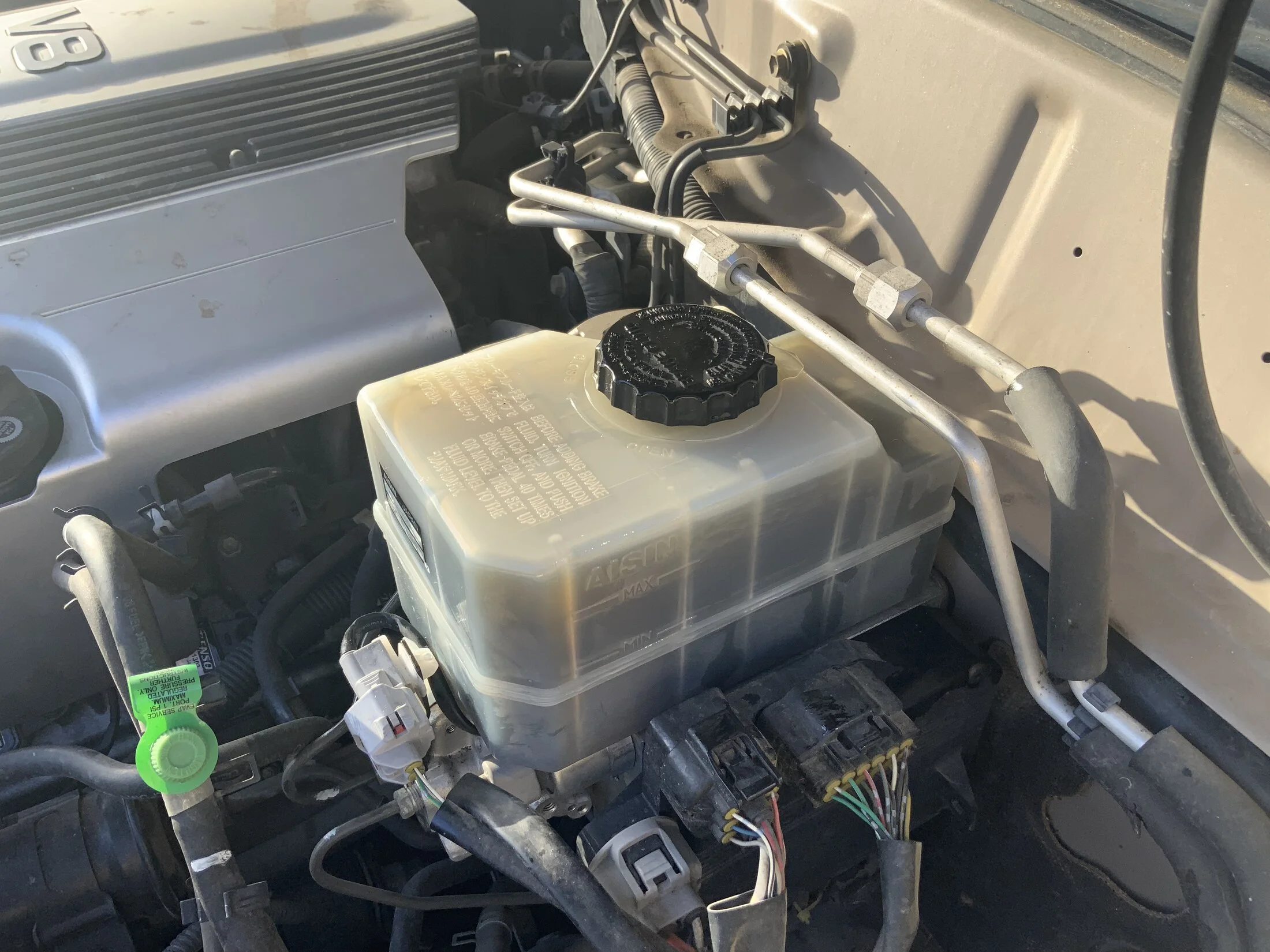

I had the Toyota dealer do a brake flush two days ago. I just went out to look at the booster pump w/master cylinder. It was filled to the top well above the max fill line. The top of the fill tank says to pump the brakes 40 times with the ignition off prior to filling the tank to the max fill line. I had my wife pump they brakes and fluid starts coming out off the tank cap within 5-10 pumps.

Yep not surprising unfortunately. You may want to return to that Toyota dealer and point out the fact that it does not even appear it was flushed by the color of the fluid in the reservoir. Or maybe send pics so you dont have to drive there. Good luck...
Thanks for the followup. I would take a photo of the fluid leaking out, write up a sheet with this story and photo, and go see the service manager at the dealer and suggest they train the techs more carefully. And whatever you paid for this 'flush' should be refunded. As @leveeguy said, your fluid should now be clear, too.
The reservoir gets stained. Thats probably fresh fluid if you were to bleed and inspect color in a clean container. This has been documented before.
