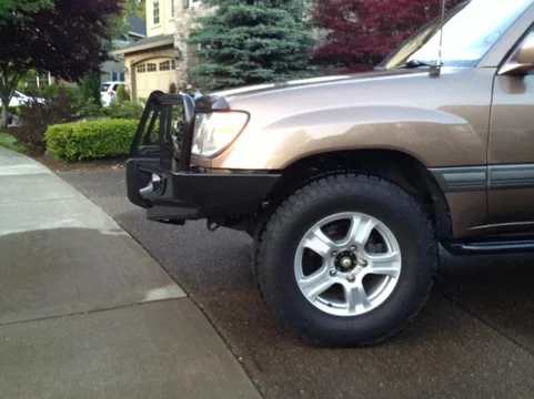

It just pops off. I use an old chisel to get it started. Bad pic, but I run without plastic covers. You can see the gold to cap I the center. Don't have any on the phone with it removed, but when you pull the cap there should be a snap ring on the cv shaft. But again, only go to this effort if the hub end of the cv is sliding in/out if the hub. image-741416217.webp
