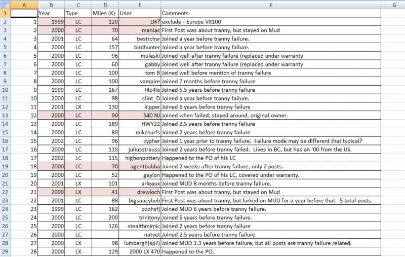

Thanks for the replies, keep 'em coming guys. We're 0 for 14 right now.
Well, there you have it. There is never a good time to have a $3.5K repair but most have failed close to home, or close to tow capabilities. I look at it this way. In order for worst case scenario, I'd have to be wheeling when it fails. Tranny load doesn't seem to affect it, so the probability of a failure seems to be pretty independent of activity - like wheeling or towing. I've put roughly 30K on my rig in 2 years. I've logged some miles off road - just did 20 miles Monday - but all told, my "in the boondocks" time is a small percentage of my total miles, maybe 2% by mileage, realistically. So I'm still facing 5% chance of a $3.5K repair, but only a (0.05)*(0.02)=.001 or 0.1% chance of a long hike before the $3.5K repair. Not what I expect from Toyota, but not up to the Chrysler level yet.2) What do we do with the data? ... By your data, I have a 1:20 shot of needing to spend +/- $3,500 in the next 2-3 years.
We're stingy?edit: how valid is the population data for the 2000 MY? your 5:1 statement got me thinking. if you look at just the LX subset then the 2000 failure rate is in line with all A343F years. is there perhaps a polarizing force that draws a MUD member to LC's?
Working on that now....how many of the reported failures are 'senior' members vs people with their first post an trans problem?
Yeah, I don't know about that. All my numbers I lumped the LC/LX's together. There "could" be a difference, but AFAIK they use the exact same transmission, no? And I get the "feeling" with no data to back it up, that there ARE more LC owners on MUD than LX owners. If we can prove that, can we vote to kick Loud off the island??could the 5:1 ratio be that in the pre-MUD population LC's are a) more likely to see trail time or b) more likely to see a load (gear/trailer) in their years prior to MUD membership? if so there could be a positive correlation between heavy use and failure rate. and at least one of my PO's had a trailer brake. great.
