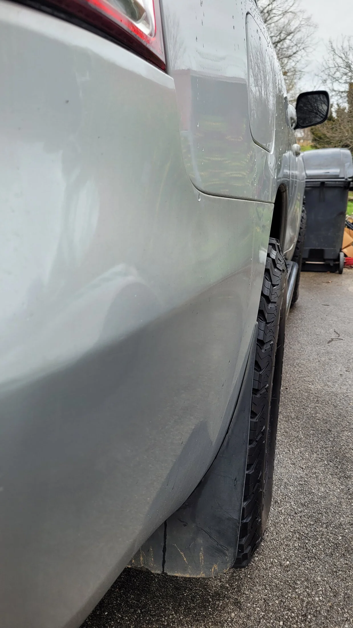

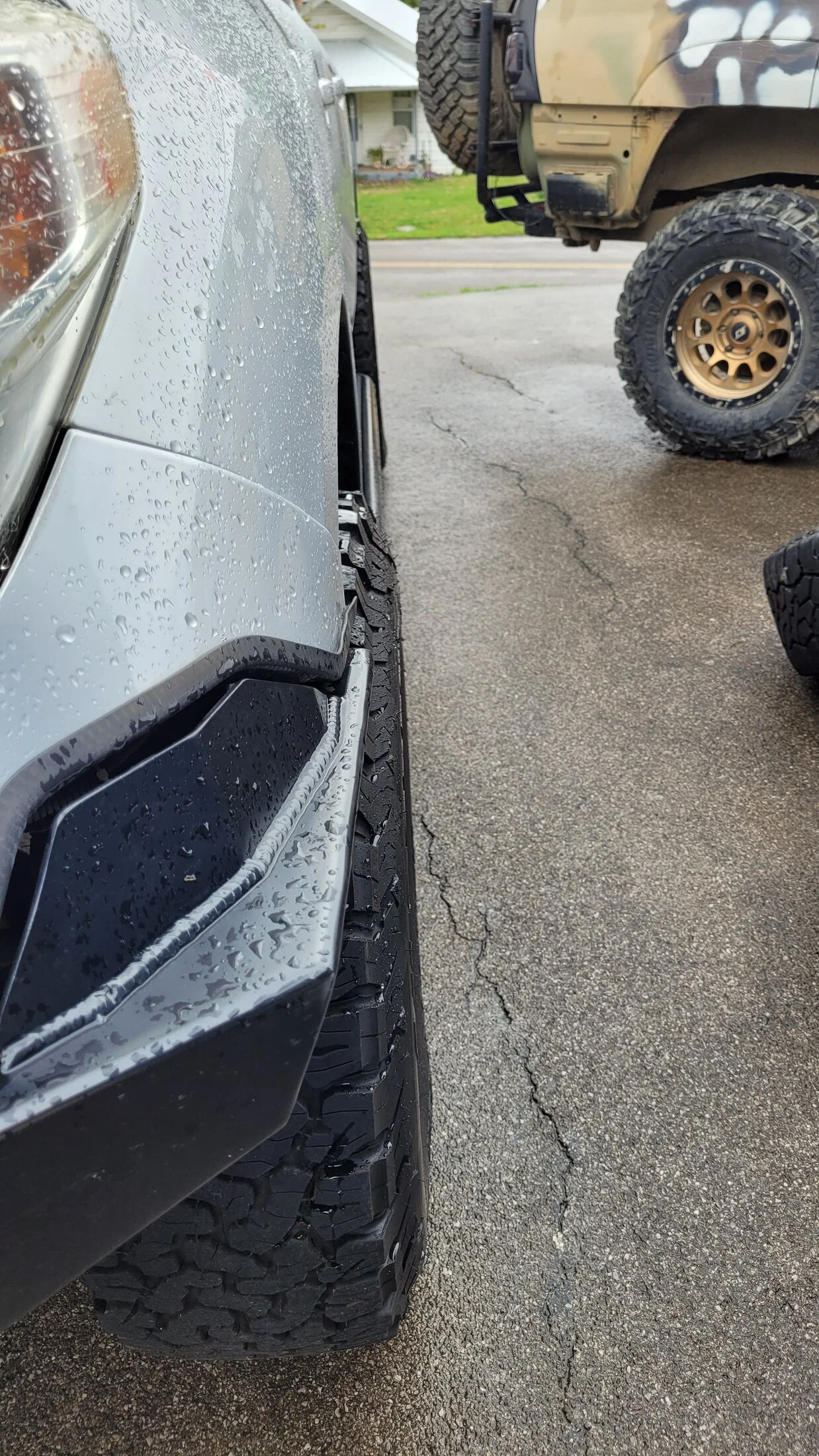

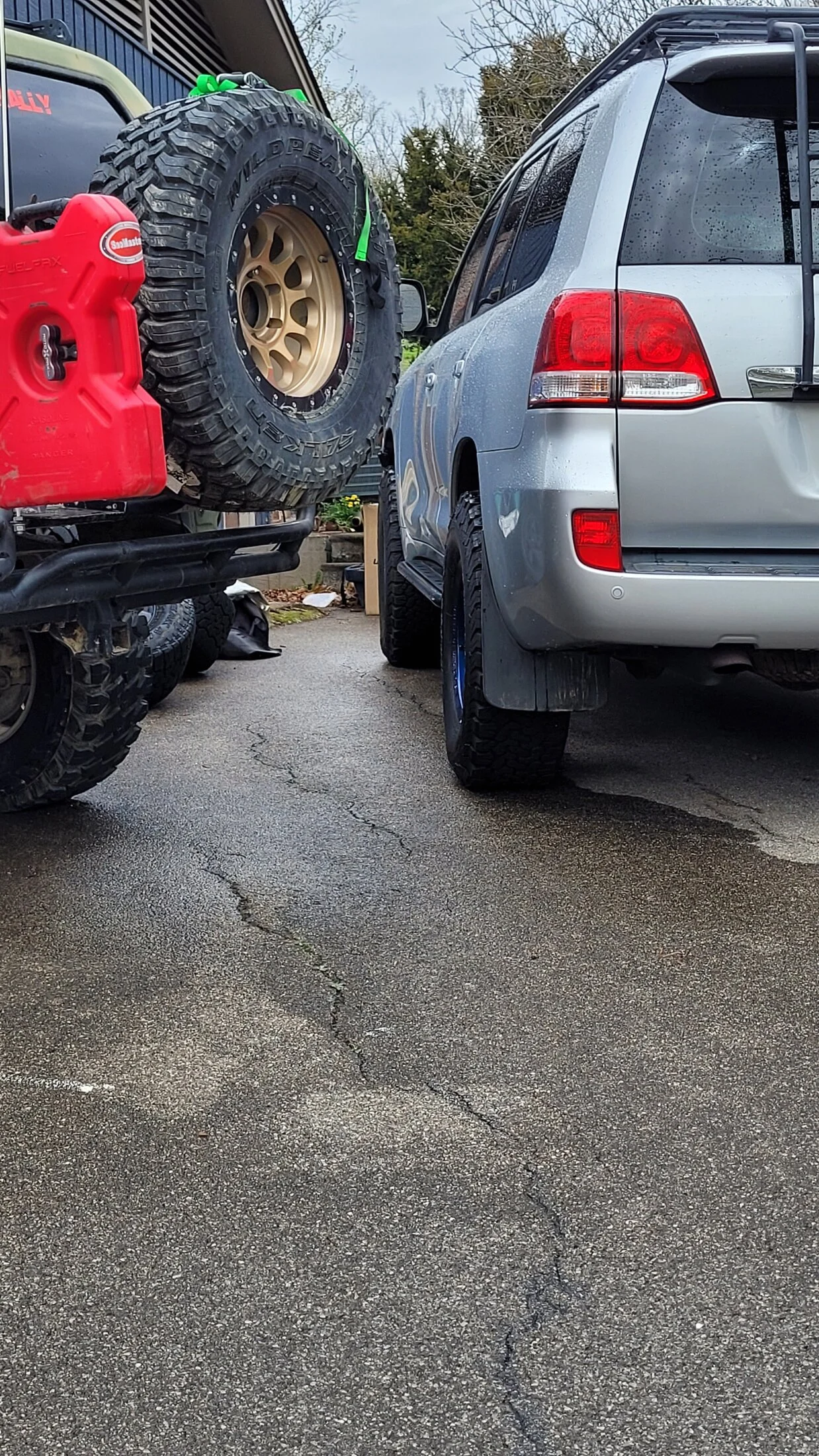

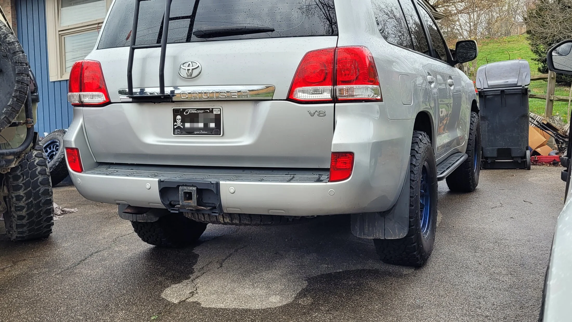

This is 37x12.5 at +28 offset. Pulled and rolled fenders.
