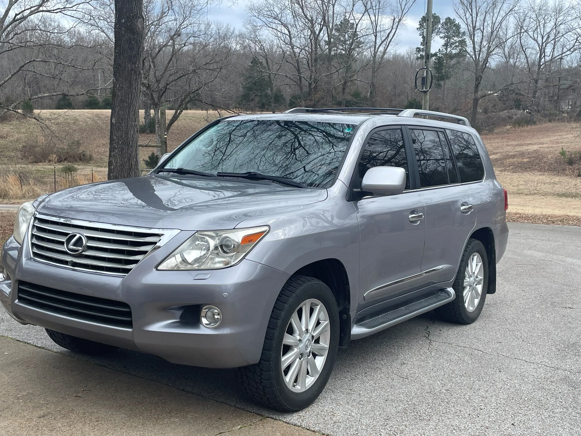

This post may or may not get punted - seemed appropriate enough - I don't have any details in front of me (which is why they're not in the classifieds yet), but I am selling my 'farm' and therefore losing a sh!t ton of storage space. I have a set of 20" factory LX wheels, from an '08, with decent AT tires (I think they are Nitto's) on them (no TPMS) - anyone willing to come to Oxford, MS can have em. I also have a set of Chrome 16" factory LX wheels, from an '01 (Chrome is beat up pretty good - no tires) - same drill, if you have a need, come get em.
This post may or may not get punted - seemed appropriate enough - I don't have any details in front of me (which is why they're not in the classifieds yet), but I am selling my 'farm' and therefore losing a sh!t ton of storage space. I have a set of 20" factory LX wheels, from an '08, with decent AT tires (I think they are Nitto's) on them (no TPMS) - anyone willing to come to Oxford, MS can have em. I also have a set of Chrome 16" factory LX wheels, from an '01 (Chrome is beat up pretty good - no tires) - same drill, if you have a need, come get em.View attachment 3883286View attachment 3883287
Post this in the classifieds. There’s a decent contingent of folks from MS on here.
