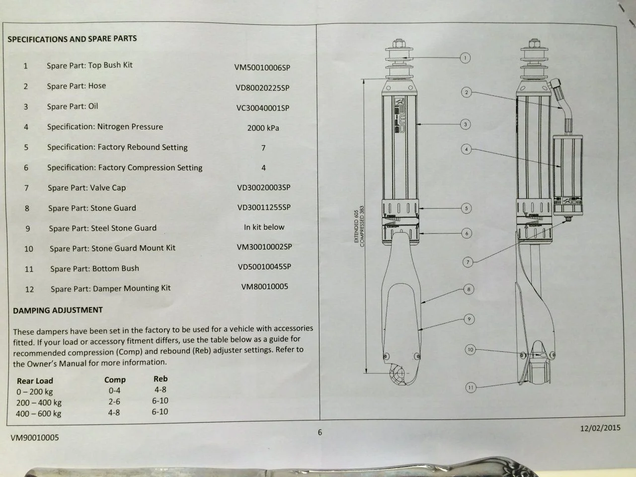

One factor I consider is the instructions that come with ARB installs of both rear coils and front pre-load suggestions.
For example:
For BP-51 adjustment of rear units:
Note in lower left what it suggests for an additional load of 600kg
600kg alone = 1,322.77 pounds
In front, they suggest various preloads for diesel engines + bumper and winch, etc.
But anway... i would think an overloaded suspension setup would pose the greatest danger/damage possibility...and highly doubt the axles or other structures would have trouble handling more.

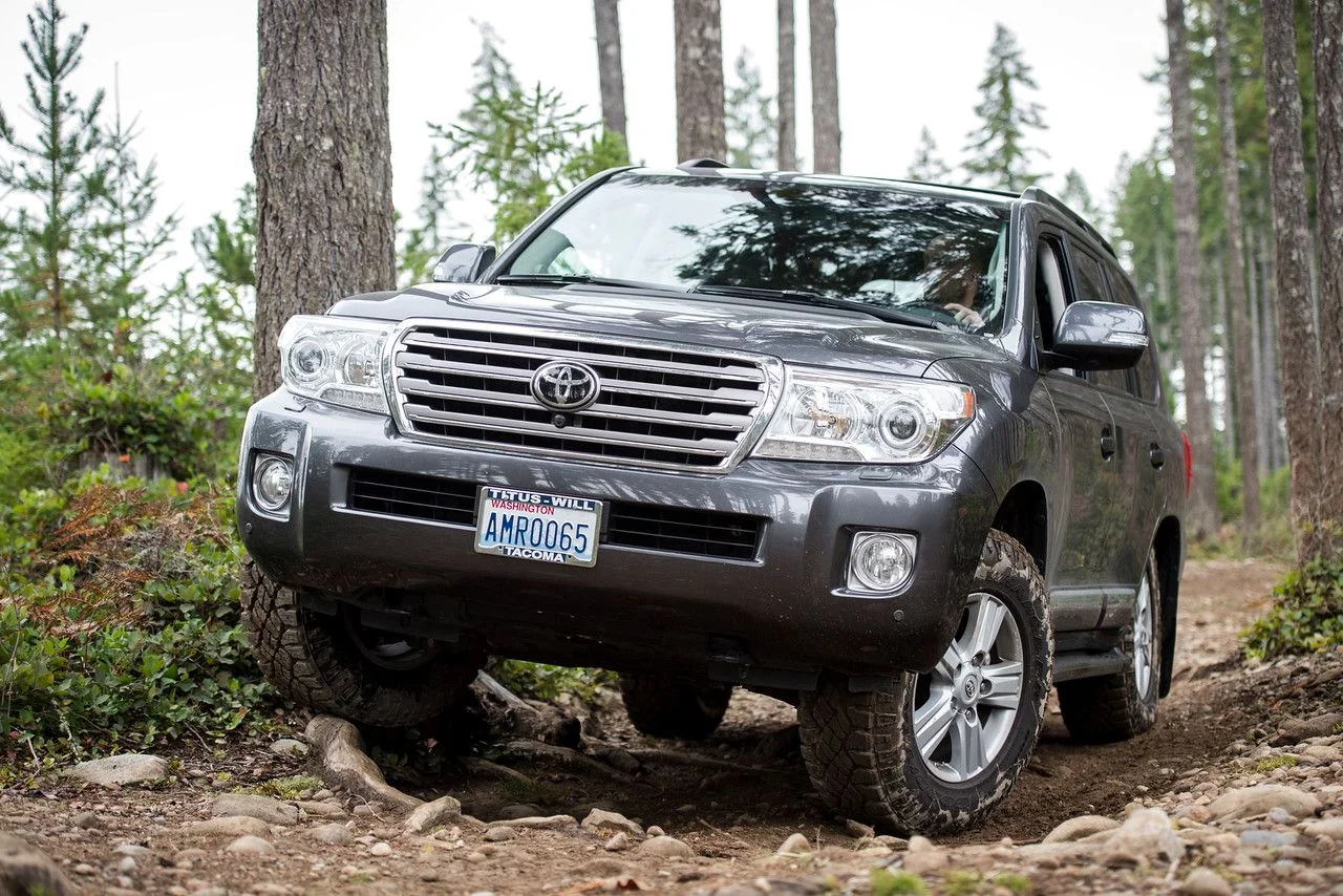

We ran that size in the Goodyear Duratracs for about a year, only rubbed when ya turned the wheel full lock, and barley rubbed at that! That's my daughter Em chillin after a long hike...

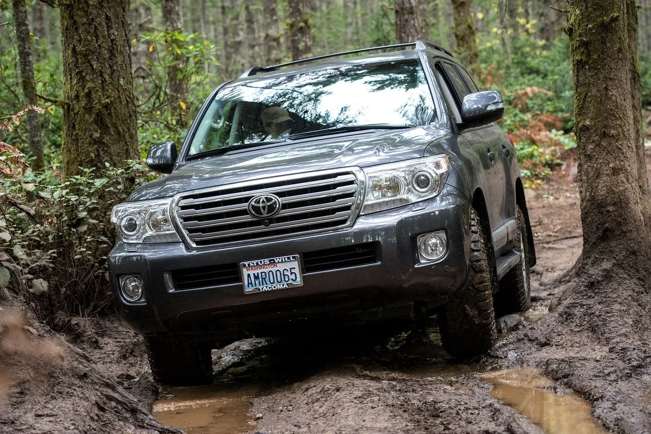

couple more random pics with the 275/70 R18's for ya!
We ran that size in the Goodyear Duratracs for about a year, only rubbed when ya turned the wheel full lock, and barley rubbed at that! That's my daughter Em chillin after a long hike...View attachment 1471422

Thanks for the props on the pics and glad I could help steer ya into the best rig on the planet! For me the road noise of the Duratracs over stock was very minimal, but I'm use to running mudders so maybe my opinion on road noise is warped:) Thanks again for the props man, slap some 275/70's on that rig and hit the trail!
