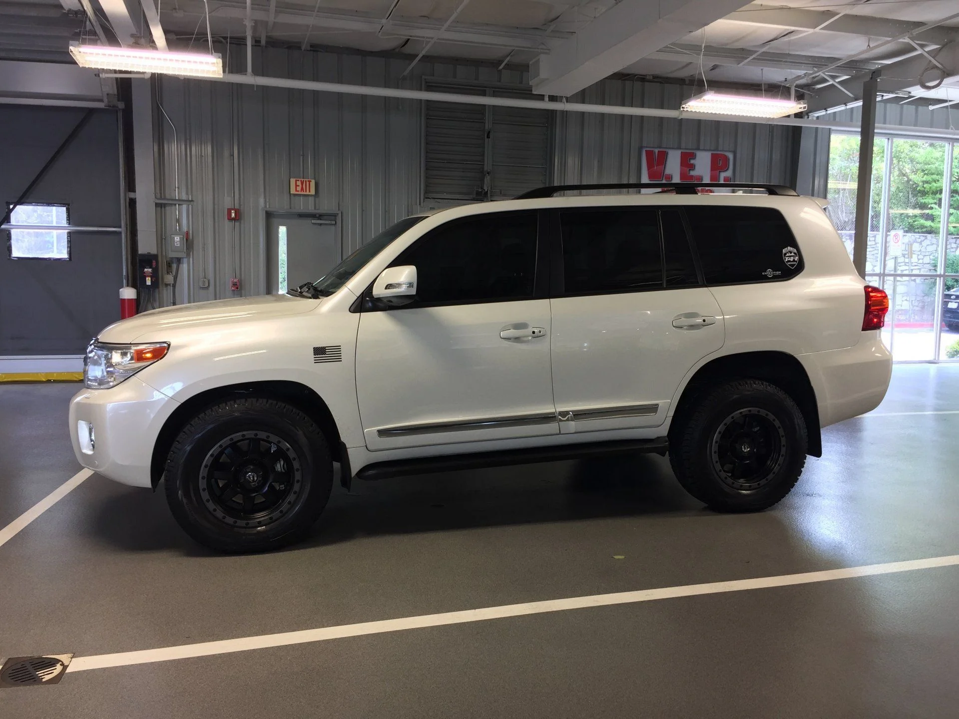

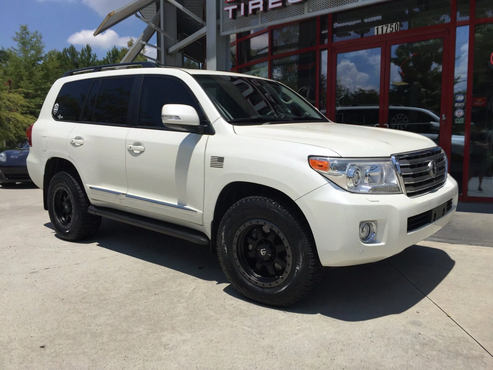

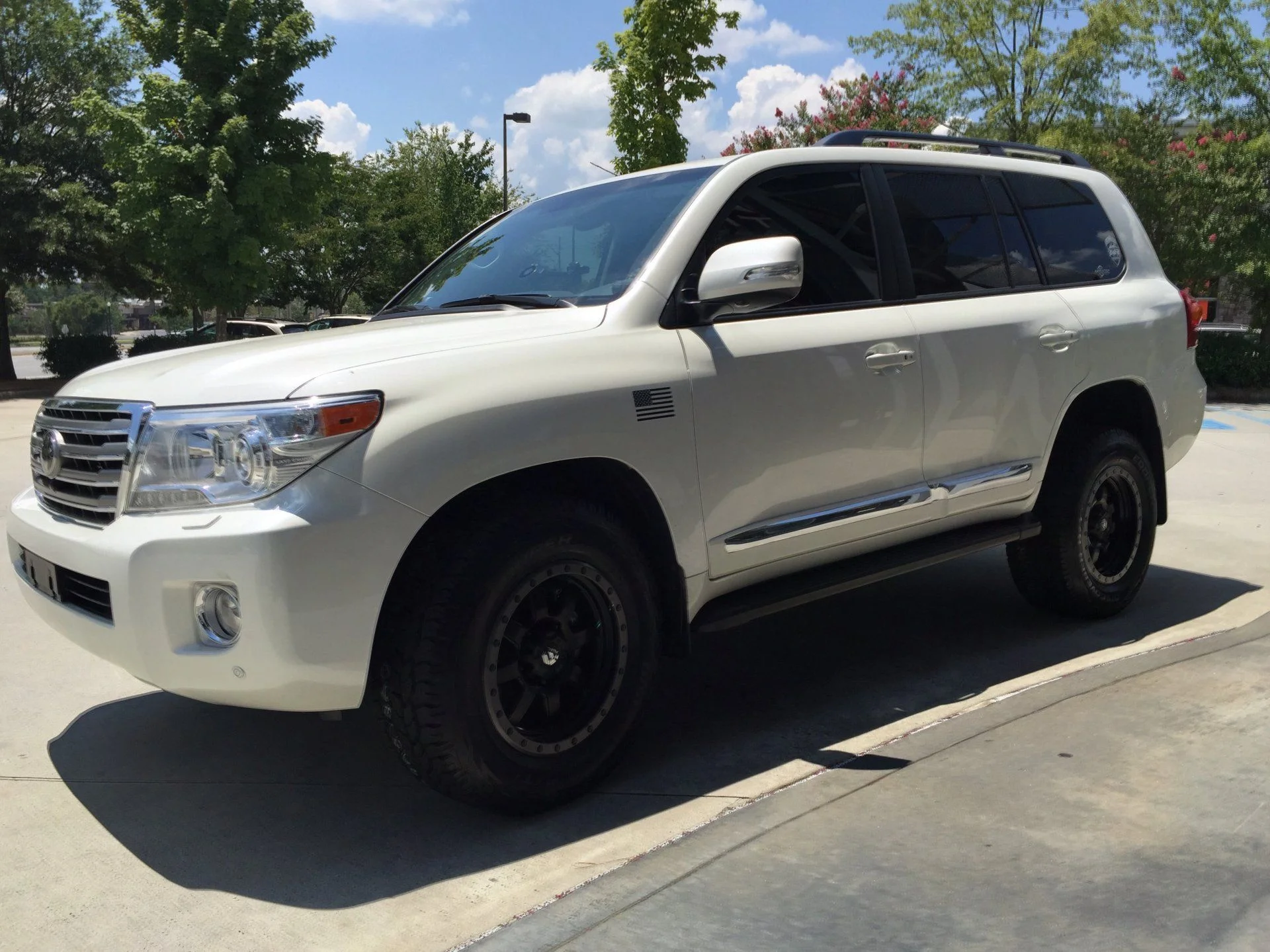

These rims are 18" with 35" tires and +12mm offset. I did a test fit of rims and tires just for looks because I don't have a lift yet.
Those are bean looking!
You need some more lift fur sure though!
is that how they spell down in the delta?
What is the actual tire size of these? I'm going to try 305/65/18 KO2 to see if it fits. My wheels will have a 20mm offset
Tire in picture is Toyo Open Country M/T 35x12.50x18. +20 mm offset is good positive offset.
Are you able to turn that thing without a lift? ;)
My dog was advising not to go beyond driveway. Straight line only. :)

Wheels: XD Series Machete 128 18/9 offset +25
Tires: Nitto Ridge Grappler 33x12.50 r18
Rub: Inside front mudflap. Rate 2
Comments: Nice fitting set up with just slight mudflap rub at full turn. Fits into KDSS arm arch with 1/4" clearance at full turn. For the Nitto Ridge Grappler performance, if you are looking for an equal on road/off road I'd give it a 8. Very quiet on the pavement. Depending on snow and ice performance it could be a 10. It is very good.
