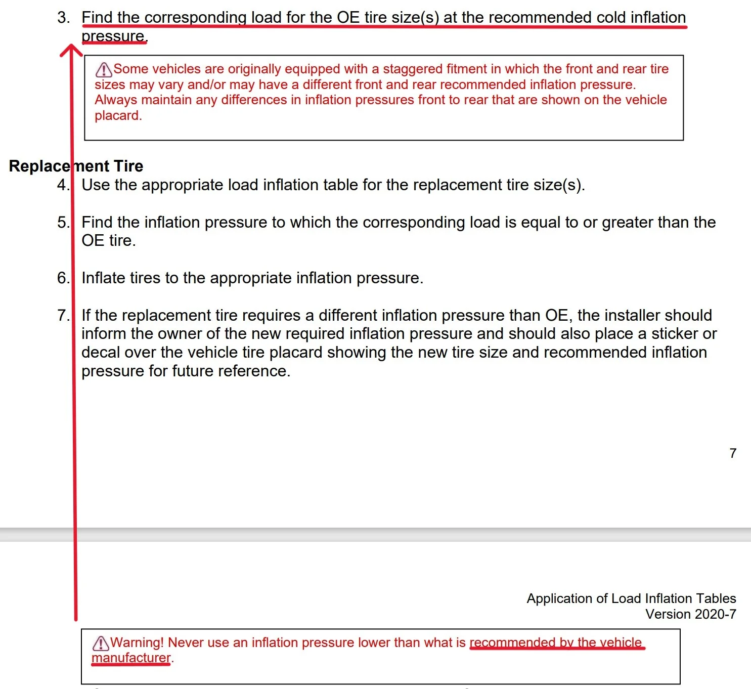

Again, I believe you are misinterpreting what is written.
Let's take a look at a more complete snippet from that same document:
The warning at the bottom refers to one's choice for the tire pressure, recommended by the manufacturer for that standard tire, as a basis for the calculations for Load.
To interpret that warning as you would, it would have to be worded:
Never use an inflation pressure [FOR THE REPLACEMENT TIRE] lower than what is recommended [FOR THE OEM TIRE] by the vehicle manufacturer.
It is not worded that way, and to so interpret that way one would have to be comparing apples to oranges - so to speak.
What is a more logical interpretation is:
Never use an inflation pressure [FOR THE OEM TIRE] lower than what is recommended [FOR THE OEM TIRE] by the vehicle manufacturer.
This second (and I believe correct) interpretation is borne out by the implicit assumptions for steps 4, 5 and 6 above.
HTH
Are you sure?
- You're taking an interpretation of a sentence from context of a different section. The warning is clearly in the context of the section heading: Replacement Tire, i.e. interpretation 1.
- Interpretation 2 provides zero new or clarifying information. Amounts to stating something not worth saying or belongs in a prefacing section of the overall document.

Any why again - the replacement tire should never use a lower pressure than OEM for the replacement tire for normal use. Even if inflation tables suggest is possible from a heat management perspective.
