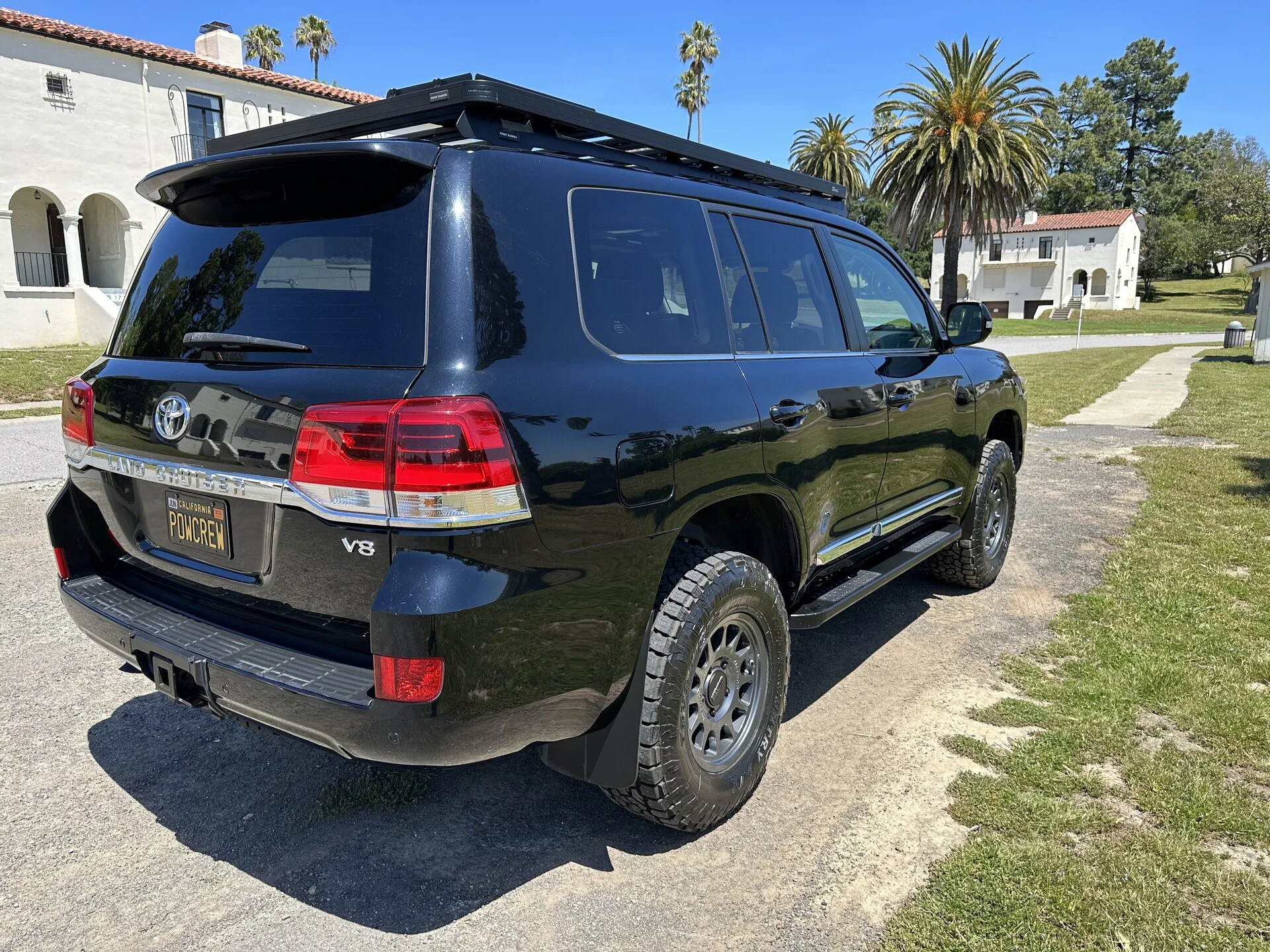

Put 295/70R17's on rock warriors today on my 2015 LX.
Had to delete the front mudflaps and will get out the heat gun for some very slight reforming of the front fender liner but that's it as there is only tiny bit of rub at full turn.
Could I get an RCTIP for this setup?
Sorry for the missing info @gaijin, they are BFG KO2 LT295 /70 R17 121S E1 RWL on 17" Rock Warriors.
No worries.
The RCTIP for those LT295/70R17 tires on your LX570 is 35psi F/R.
HTH
