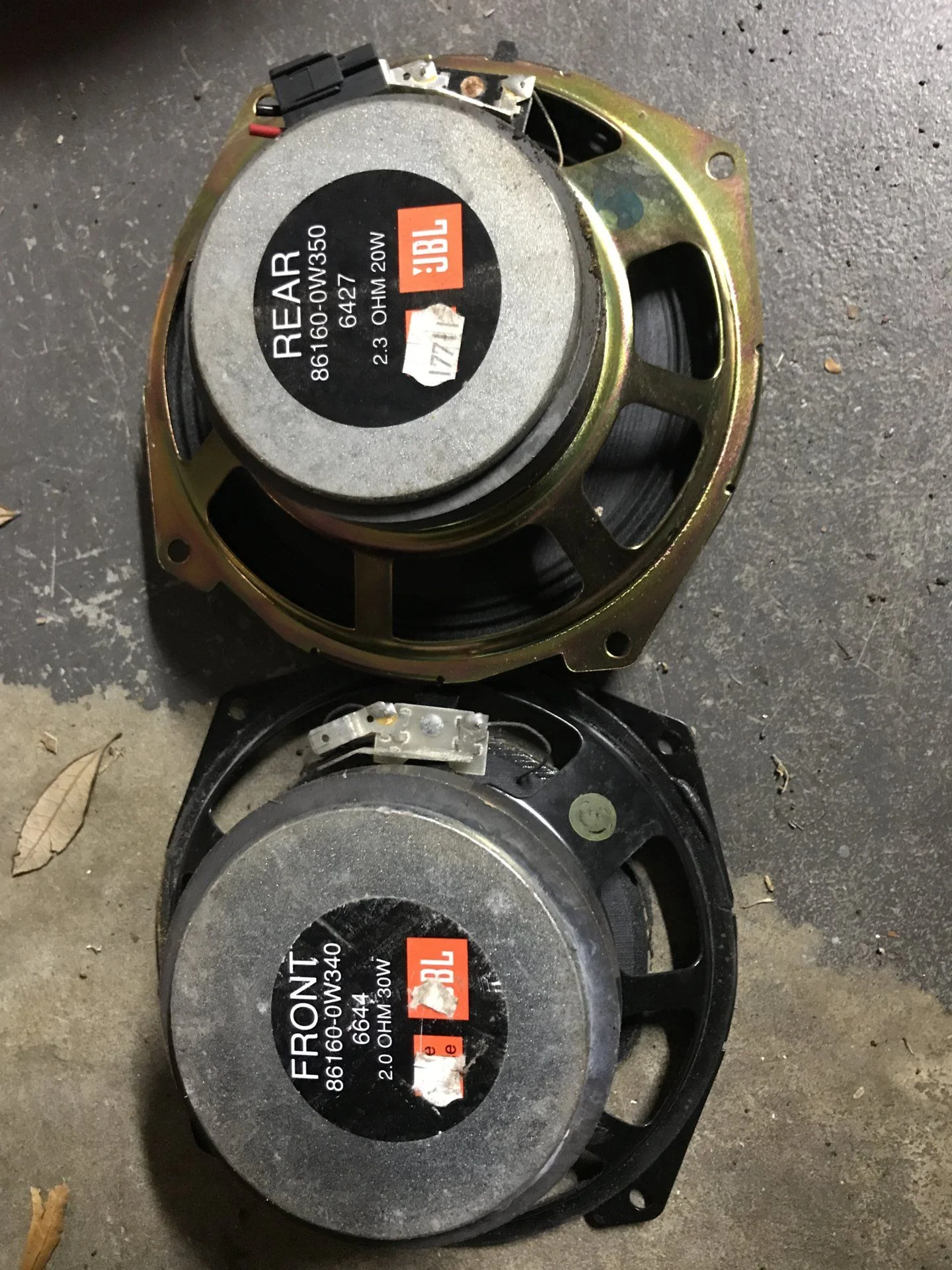

Sorry for yet another door speaker thread - but my truck is disassembled and I want (need) to order speakers ASAP, and after reading a bunch of threads, I'm still unclear on what would be the optimal replacement... not what "should work."
I just pulled a speaker out of the front door. Specs: JBL 2 ohm 30 watts. After reading a bunch of posts and playing Crutchfield's "Best Fit" game, apparently I can just jam any speaker between 5.25" and 6.75" with ohms ranging from 2 to 8 in the hole and everything will work perfectly. In fact, most of the speakers Crutchfield recommends are 4 ohms... not 2.

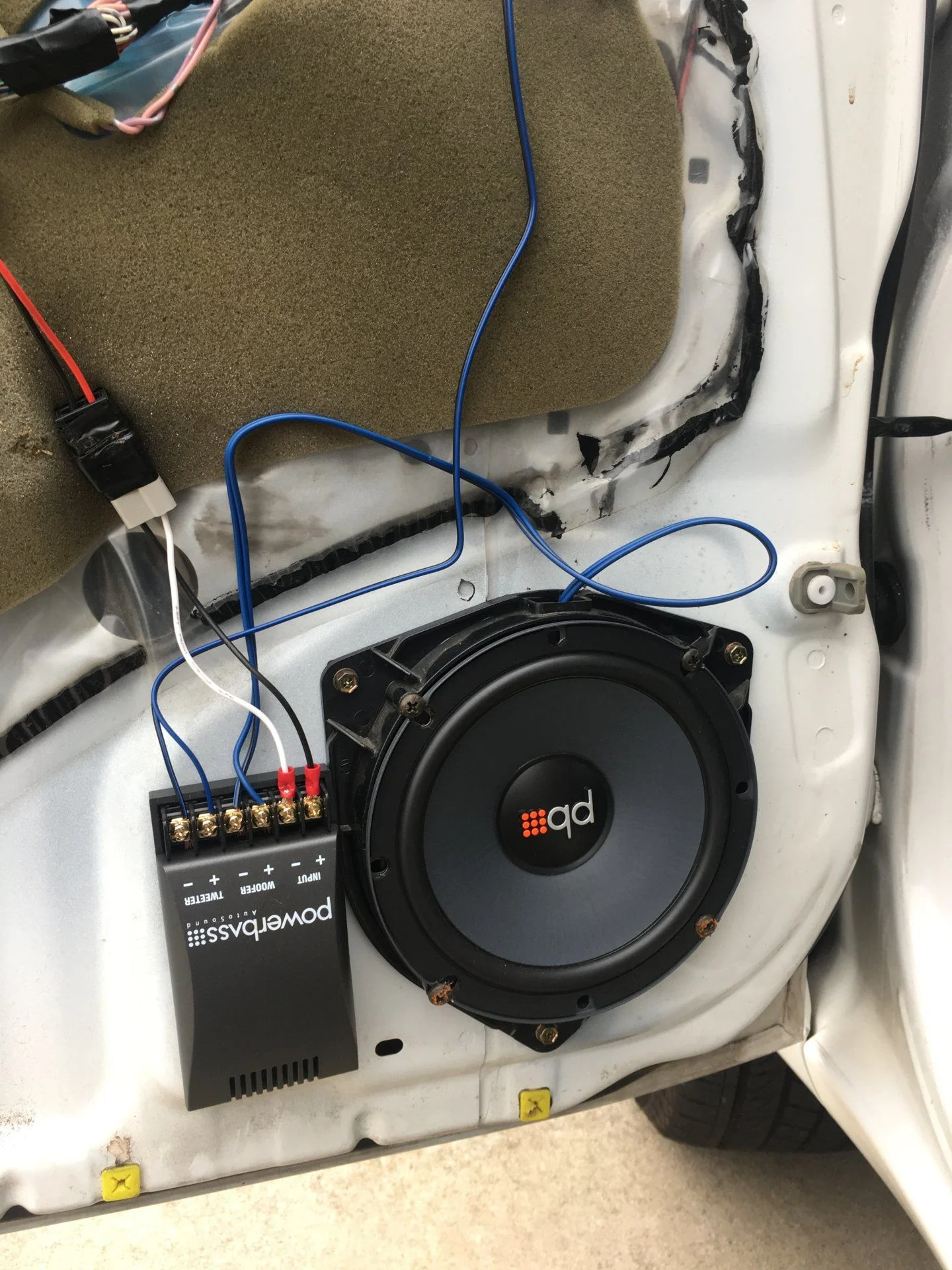

2 ohm speakers are recommended but you can go with a 4 ohm speaker and everything will work fine. You may lose a little volume but if you aren't maxing out your volume while listening, you shouldn't be able to tell a difference. I had low volume issues (bad amp I believe) so I stuck with the 2 ohm speakers. I ordered the 6.5 inch PowerBass speakers from Crutchfield and they worked great and bolted up to the existing mounting holes (a couple plastic tabs had to be removed). I replaced the speakers again when I completed my nav delete because my headunit specifically said to not run 2 ohm speakers. You will have more options if you go with a 4 ohm setup.

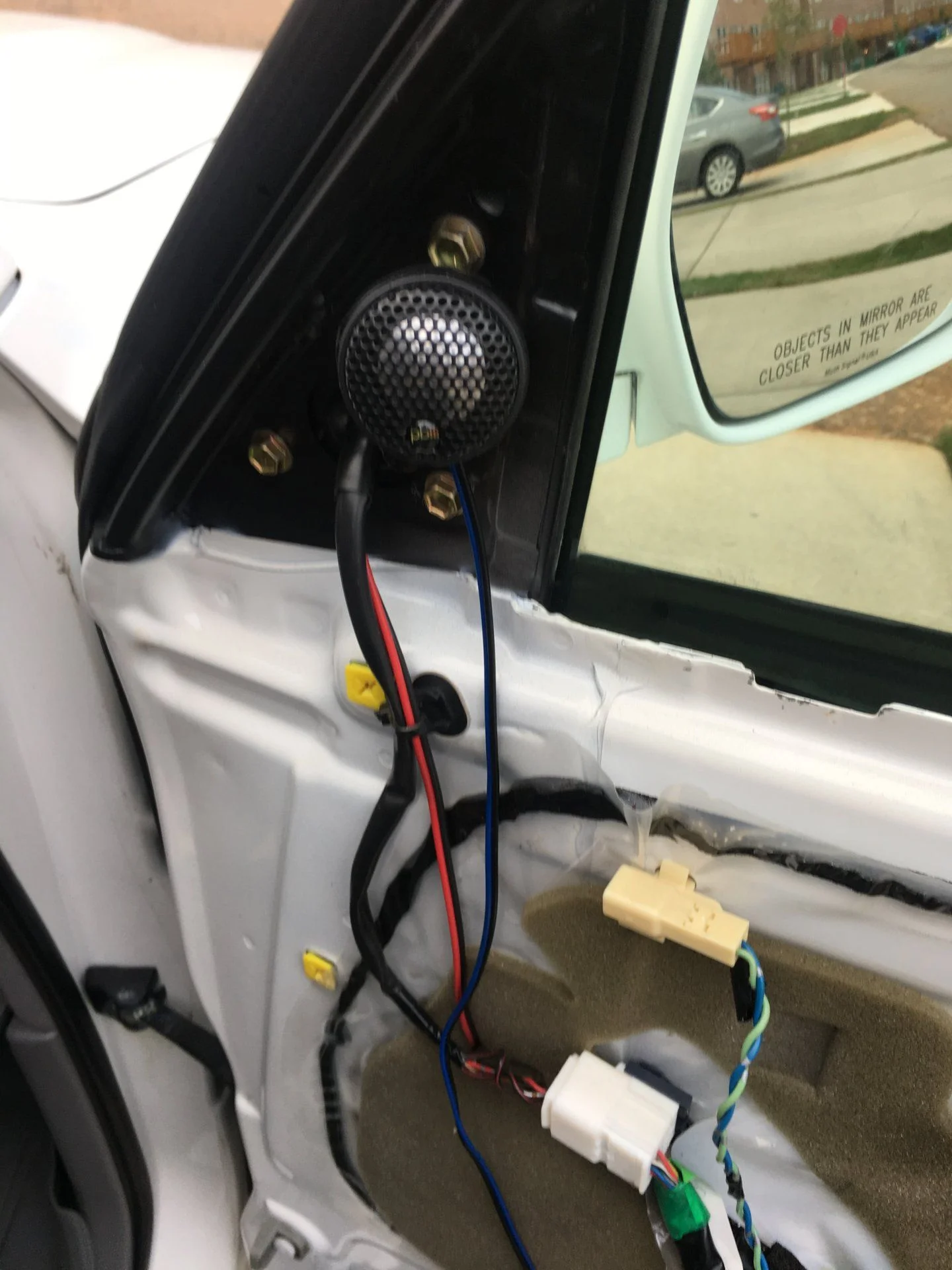

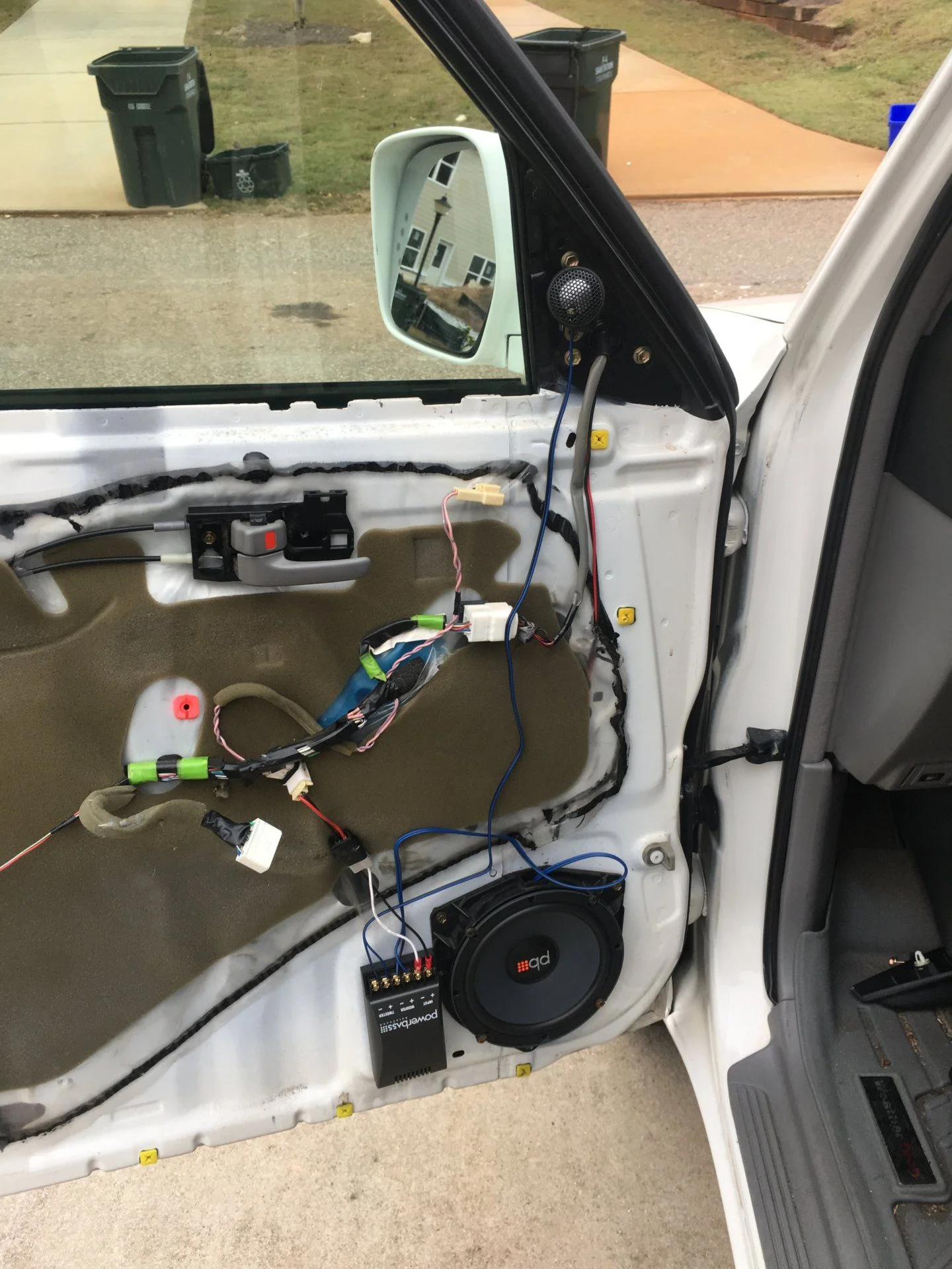

Here is the setup I was running. There is a woofer in the lower section of the door and a tweeter by the mirror. Most component speakers come with the woofer, tweeter and crossover. Lower end speakers will have an inline resistor on the tweeter instead of the crossover
Mark
Unless your tweeter is blown, a stand alone 6.5” 2 way will suffice. One of my tweeters was blown so I replaced everything.

Here is a pic of the old speakers.
Hope it helps.
You can simply throw a 2-way speaker that works into the space of the old, and disconnect the tweeter.
The factory tweeter has a little resistor for only getting high frequencies. 2 way speakers will have this resistor/crossover built in. Any speaker equal or greater than 2 ohms will work, at a slightly lower wattage. Remember, half the wattage is NOT half the sound/volume.
