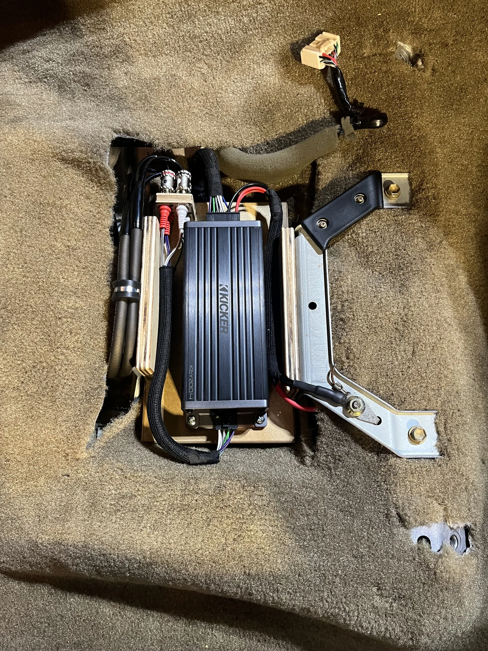

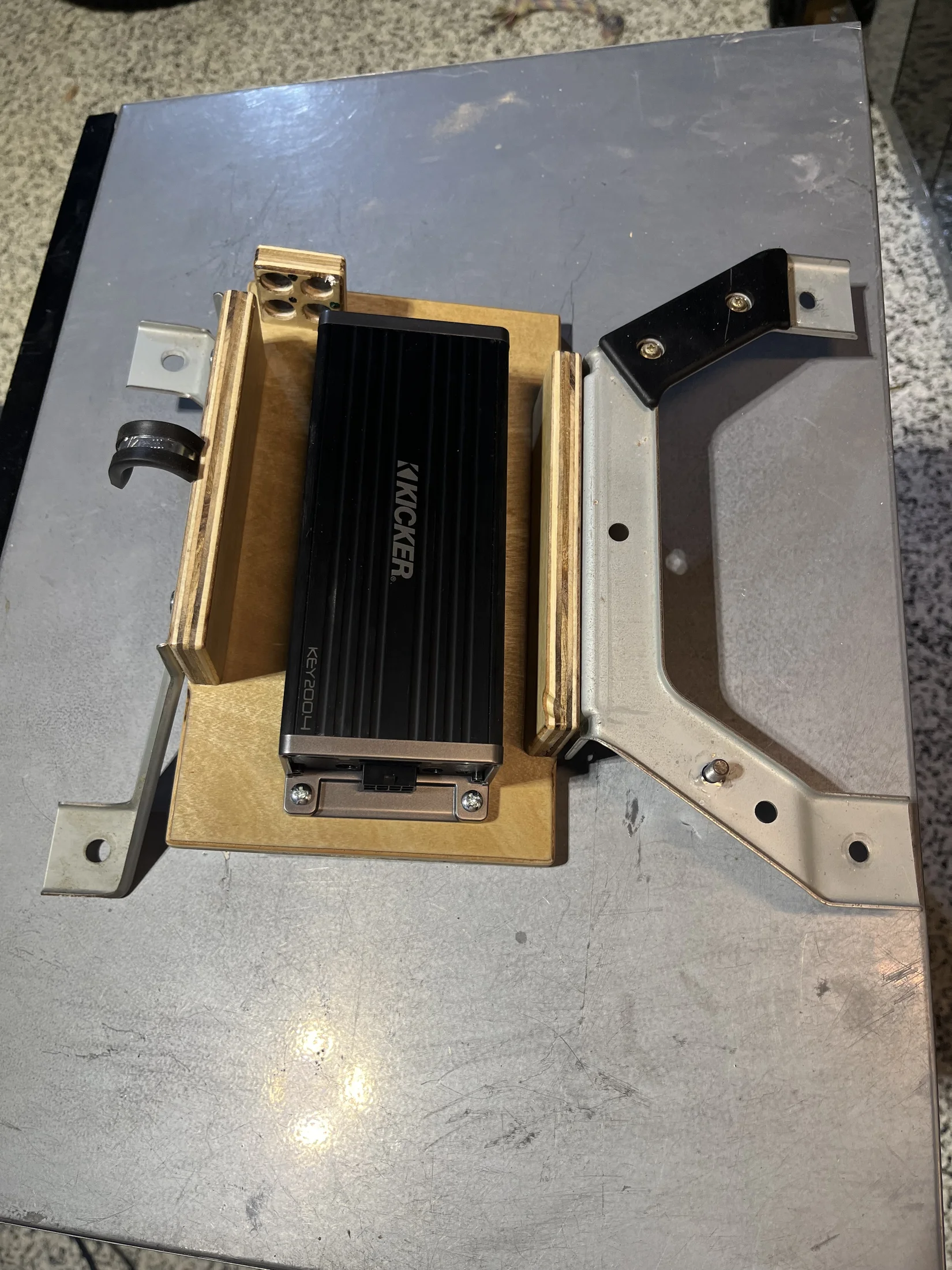

4. Created a little mount for the amp using the stock amp mounts.
In the truck: stock connectors are routed underneath the amp, power to the battery is routed up near the glove box where a nice stock grommet is waiting to be used (wire from amp is ran under the carpet to the glove box area, just need to remove the floor trim and sidewall trim), used the existing ground on the stock mount. Made a nice little carrier for the RCA connections and strap to keep the RCA wires away from the seat movement.

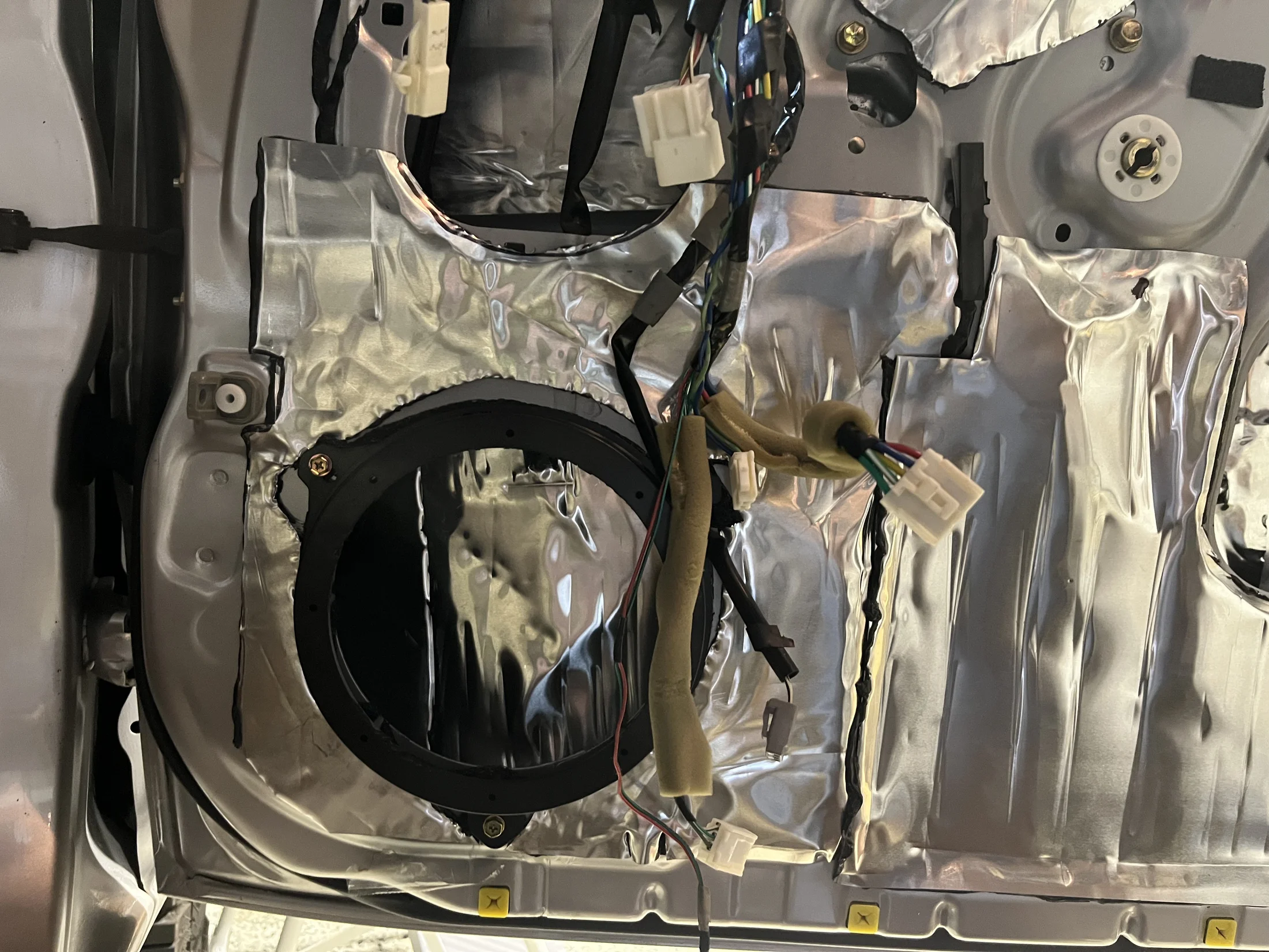

5. I went with ResoNix as it has the highest rated sound reduction, it is a very nice product to work with, would recommend.
6. Installed speakers. Crutchfield provides a few adapters for wiring, but the front speakers have a passive crossover for the woofer and tweeters, the crutch field adapters will provide power to the crossover and then some wiring will need to be ran from crossover to woofer and tweeter.
