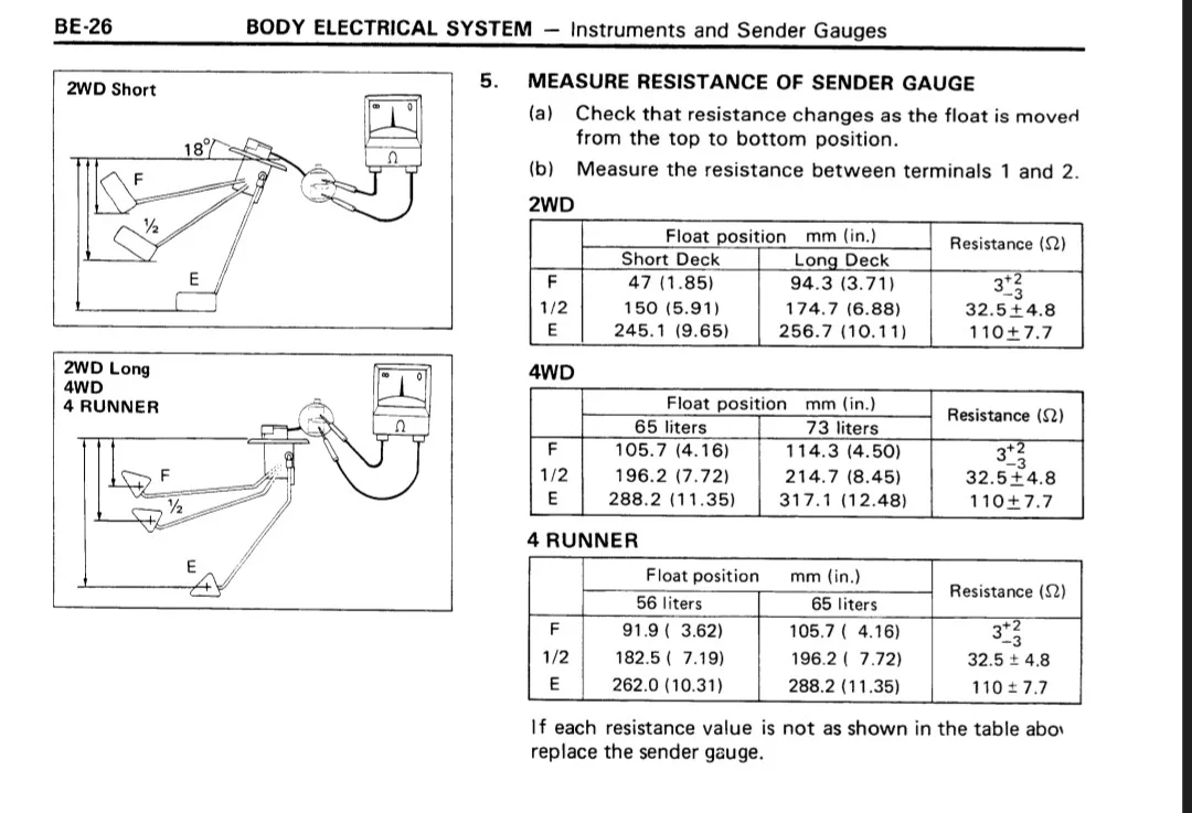

1st gen fuel gauge reading incorrectly?
Sep 19, 2023
1
1
california
hey y’all new member here I had a question about my 85’s fuel gauge reading super incorrect from what I’ve been reading. It was just above empty and I only put in $20 for 3.5 gallons and it got to half I know gas tank capacity is 14 gallons so can I get some help on if maybe some ideas to get it reading correctly again?
here.
