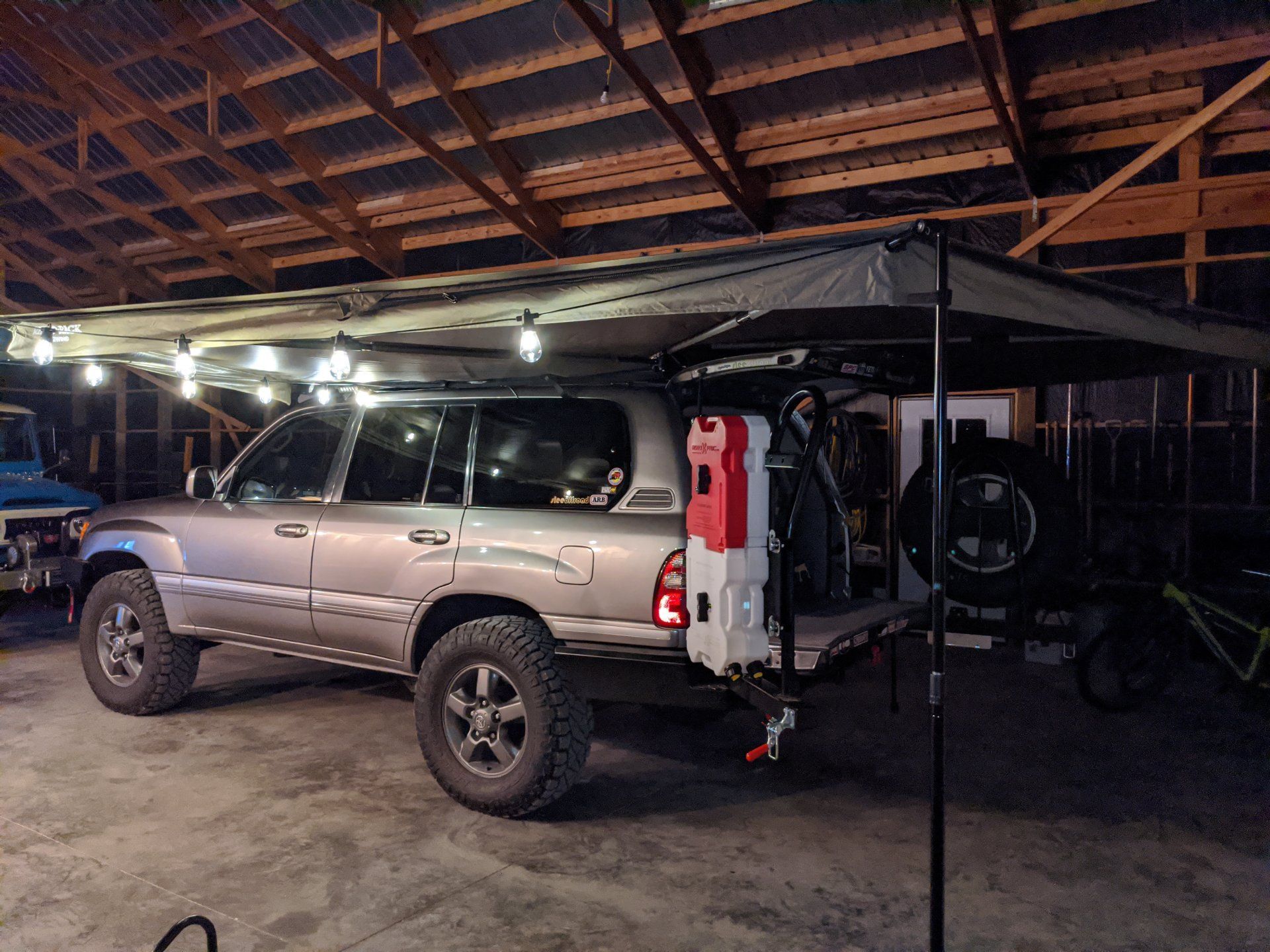

Among other odds and ends, I got the awning installed. Very impressed with the fit and finish of the RhinoRack Batwing.
Not great pictures of the awning. I'll try to remember to post more.
We're planning to take her on an overnight excursion for a maiden (test) trip soon! The RTT should arrive in a few days.
