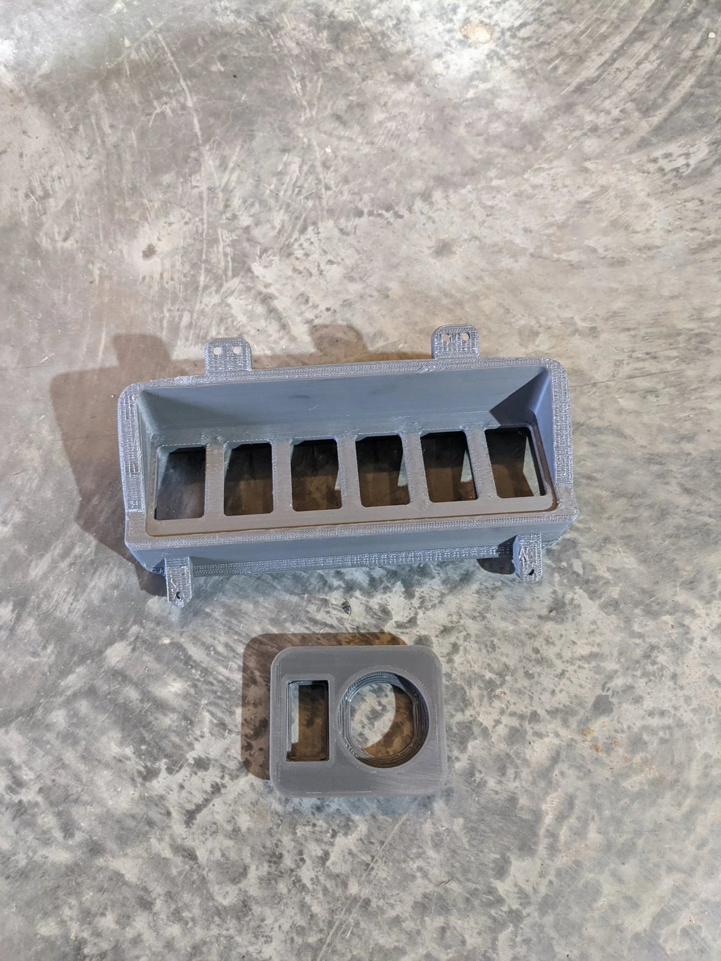

I ordered the 6-switch panel from @BenCC..
Thanks @BenCC! And thank you to @Eighteen11R for for the tip!
As soon as I receive that I can fix my switch problem and make it look amazing. I plan to try to re-use my switches but since I soldered the wires on initially it might get messy. I also ordered his 12v socket piece that replaces the 3rd row ash tray. That will serve as a basic low-level rear power source until I can tackle the drawer/inverter project at some point in the future.

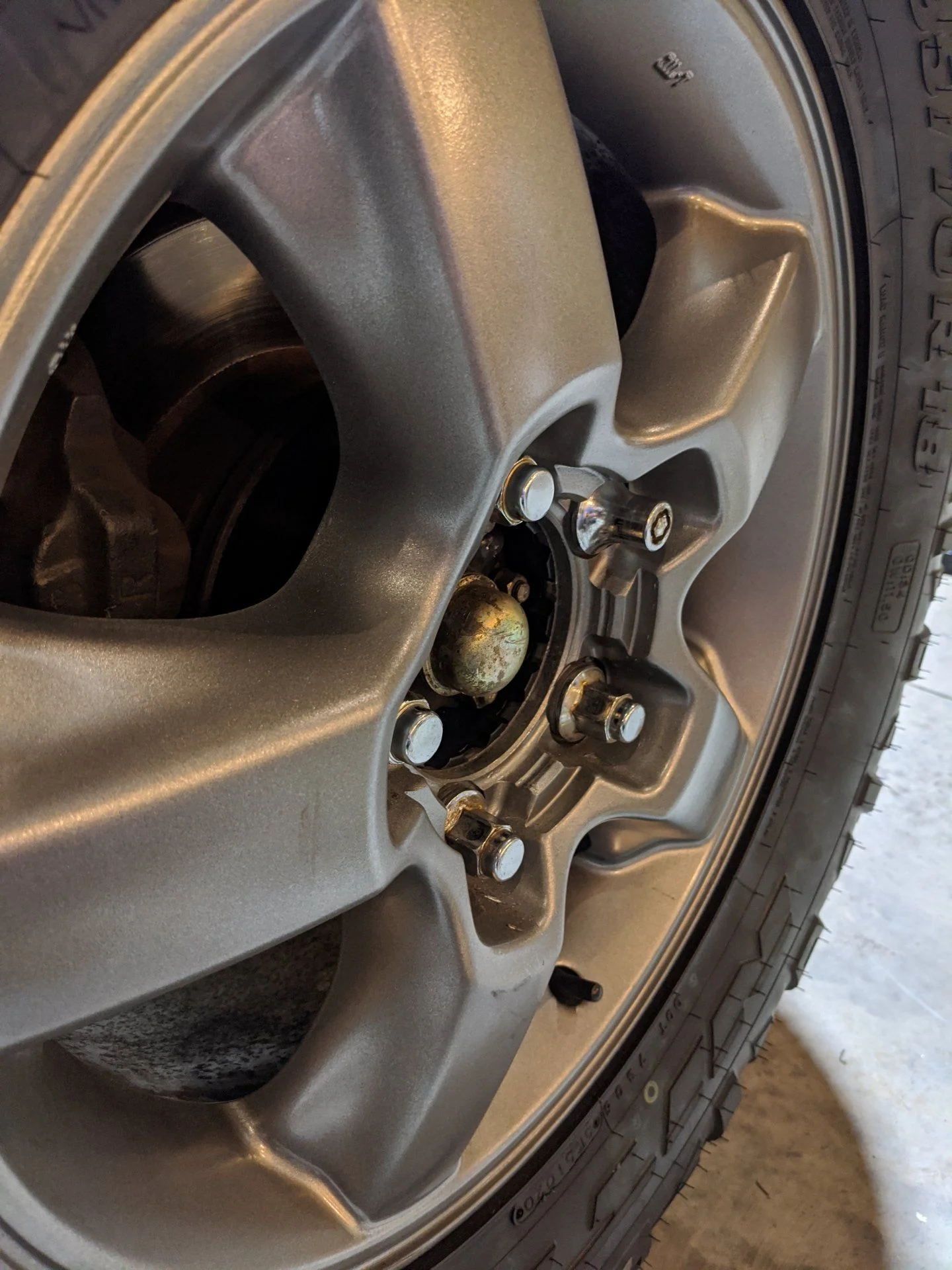

Two questions:
  1. Where did you purchase your spacers?
  2. So are you rolling without a spare tire?
Two questions:
Spacers from BORA
S P A C E R S 😉

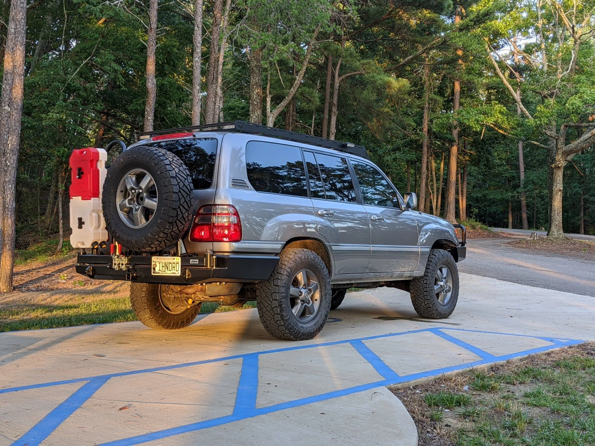

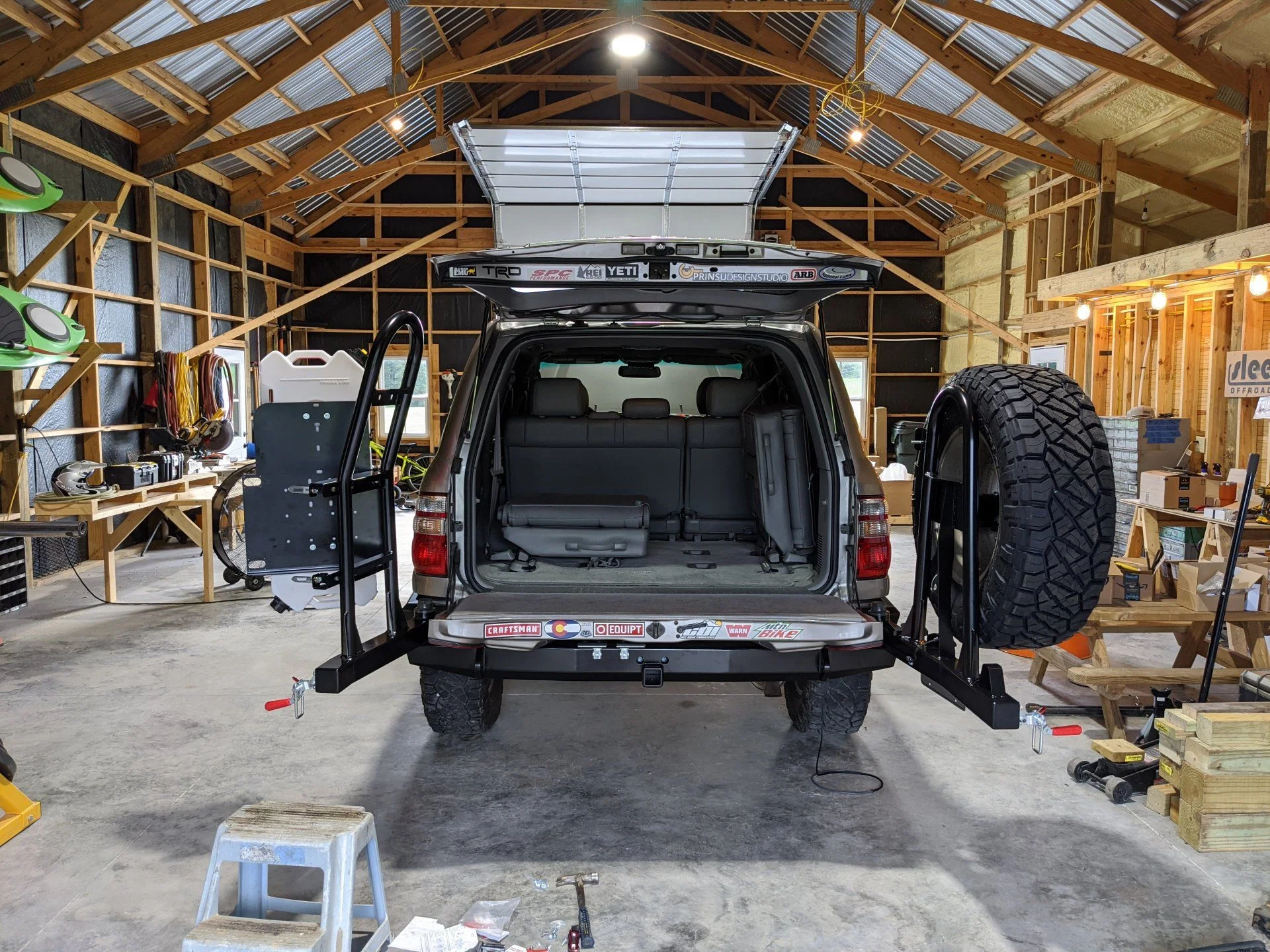

I had the spare inside the rear of the vehicle until today... Today I installed the rear bumper/tire carrier/ladder/RotoPax rack!!! (will post updates here soon)

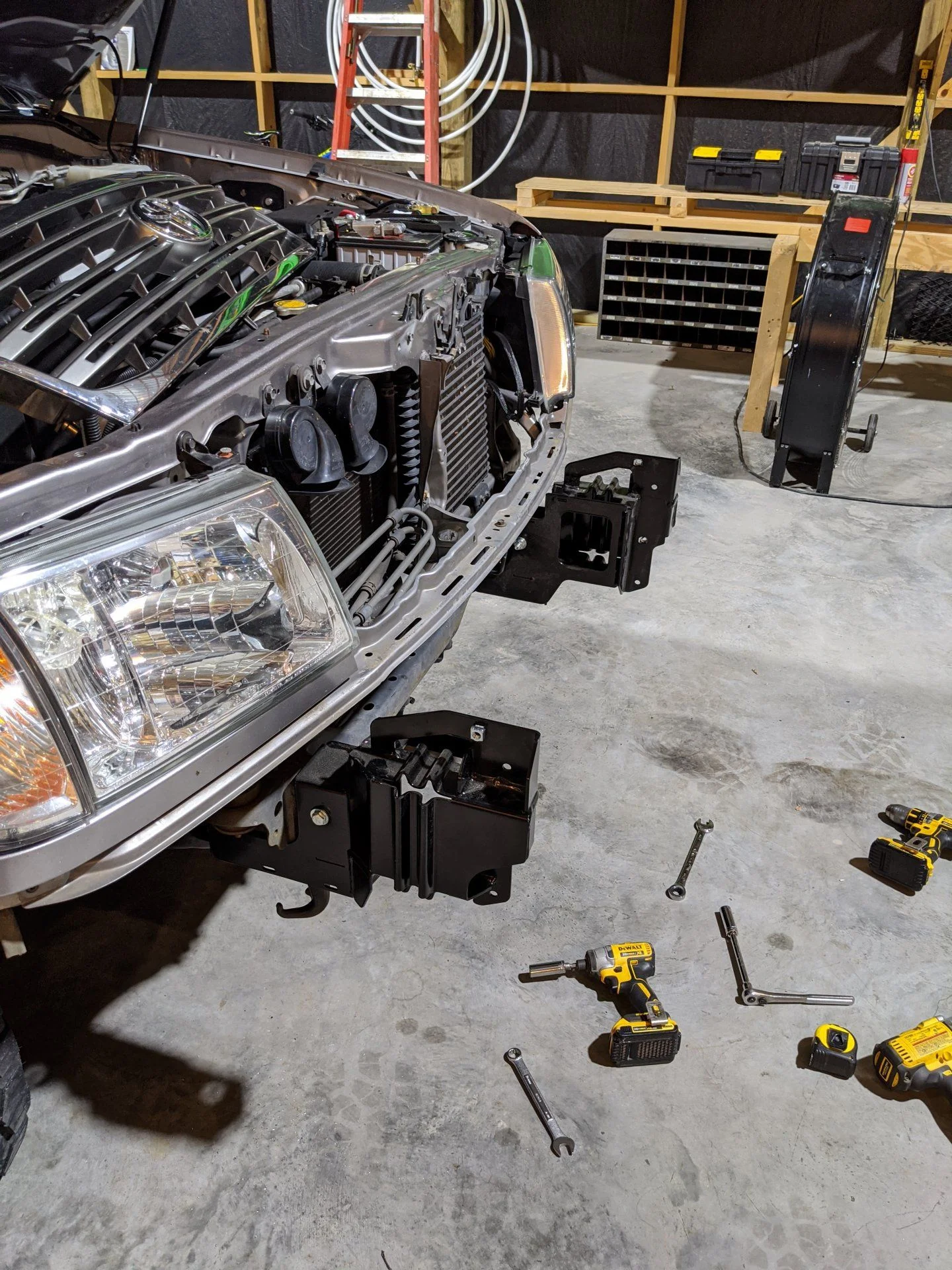

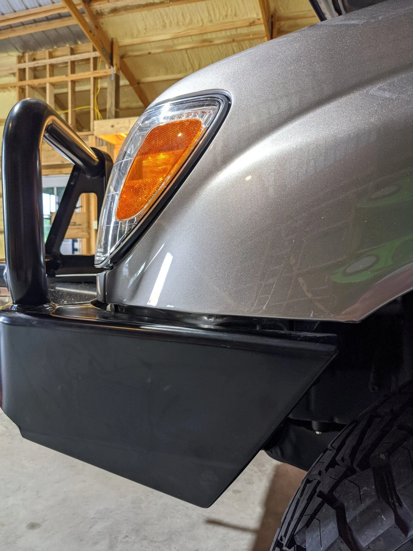

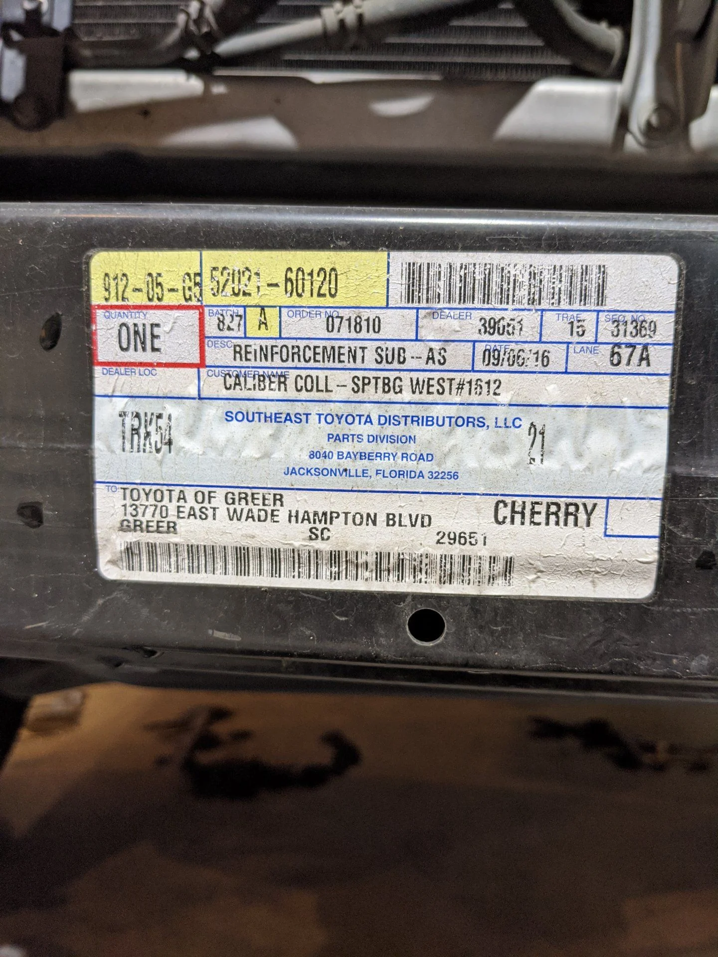

I started off Monday evening on the front bumper. This was something that I originally thought I would do immediately after the suspension was completed but then I went waaaay down the electrical rabbit trail.

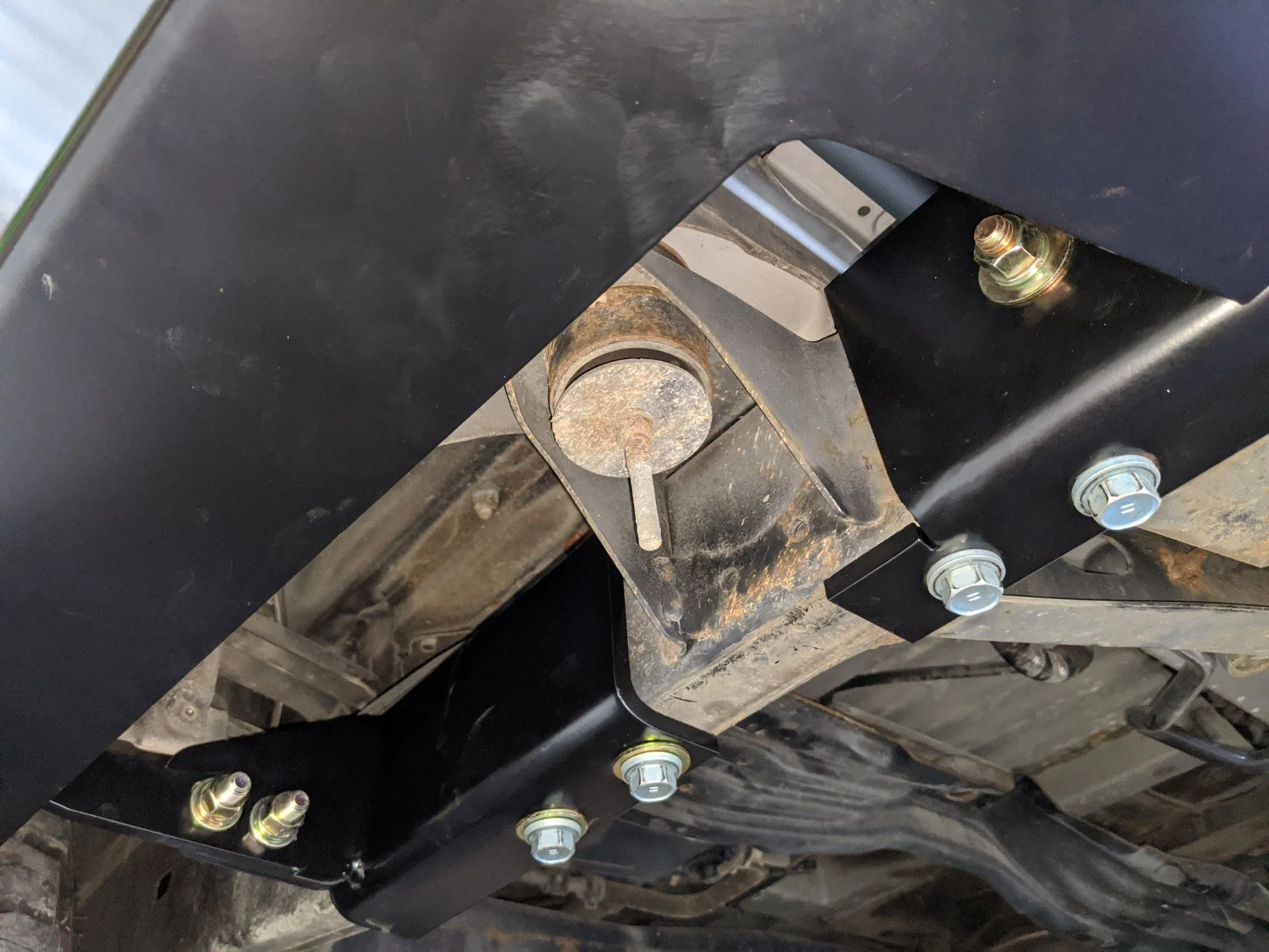

I'm pretty sure that the info on the OEM bumper cross member indicates that it's been replaced at some point...
To be continued... See next post
It all went relatively smoothly. I had difficulty with getting the recommended space between the bumper and the body (15mm) and even after shimming the brackets down was only able to get 10-12mm

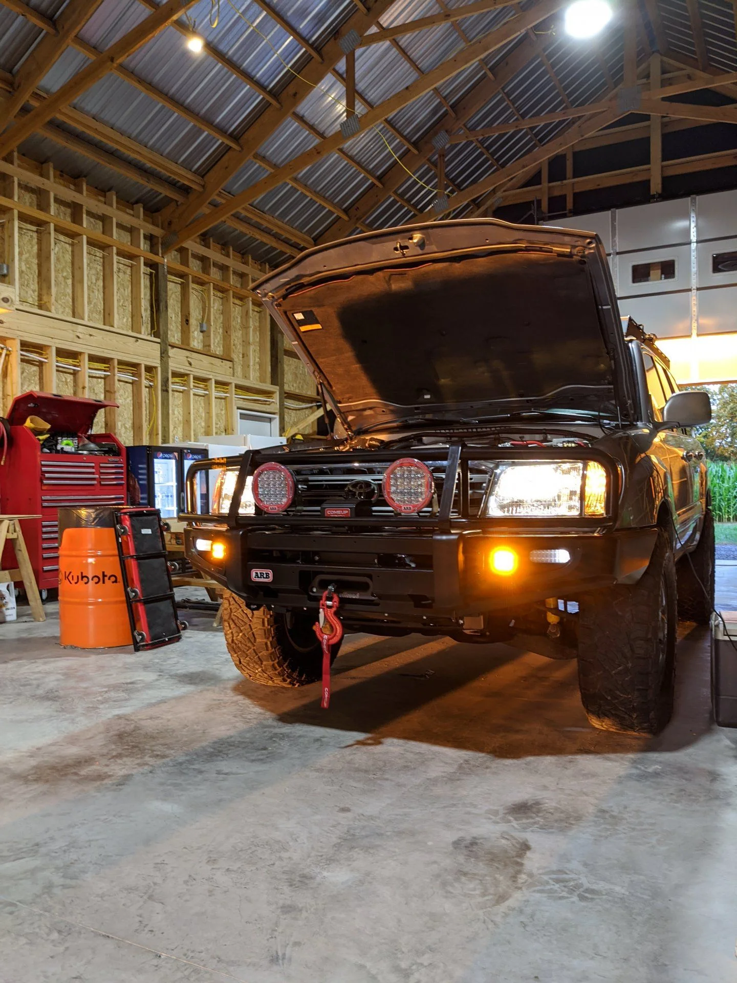

Thanks again to @clayinho for bird-dogging a pair of ARB driving lights!
I know this is a lousy picture but a look at the wiring behind the grill for the winch and driving lights..

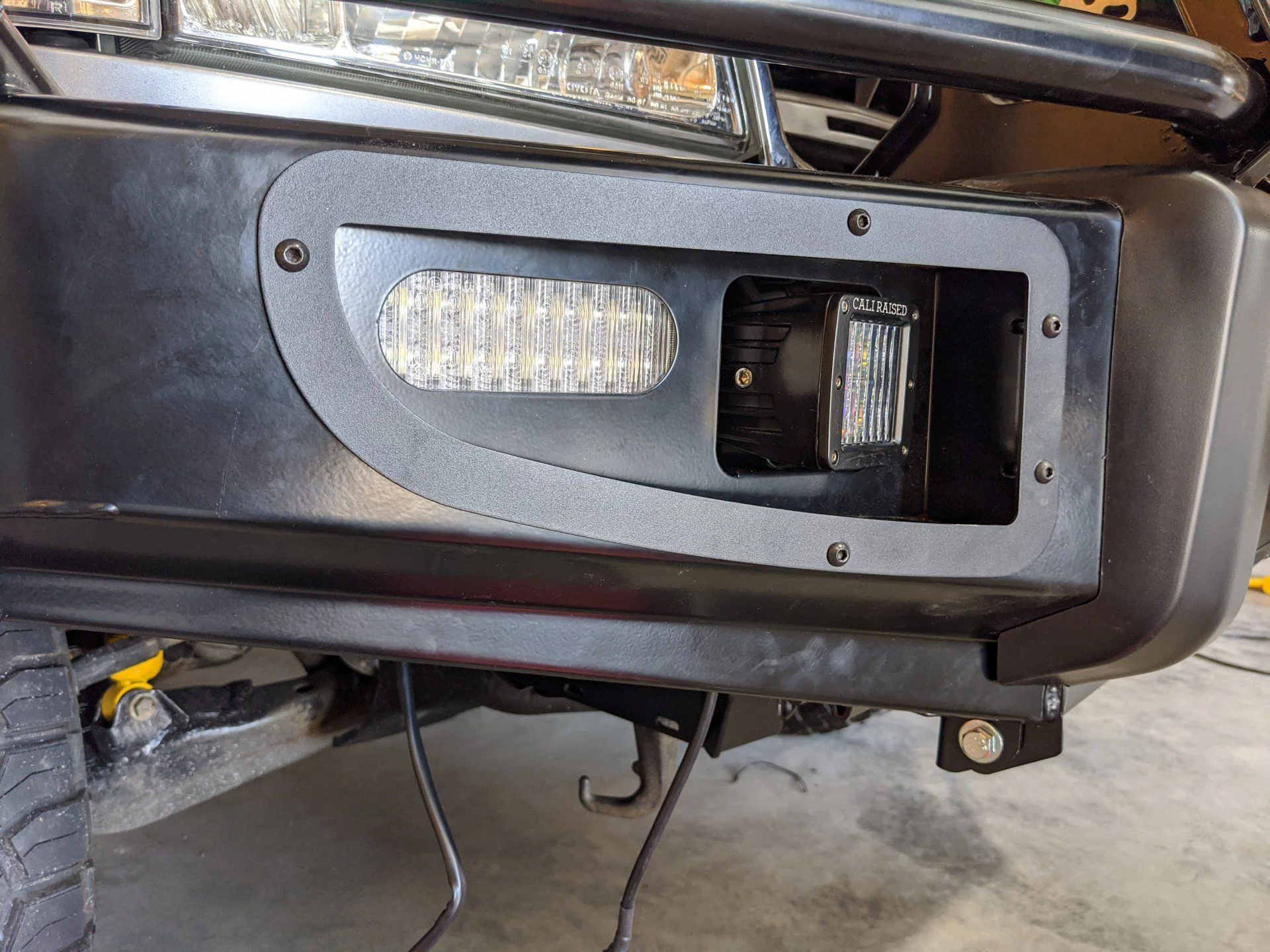

Slee fog light buckets. Great quality as usual.. These are very difficult to get fastened in place. I would recommend doing it before mounting the bumper!
All connected!
A few remaining odds and ends on the winch and lights... Otherwise, moving on to the rear bumper..

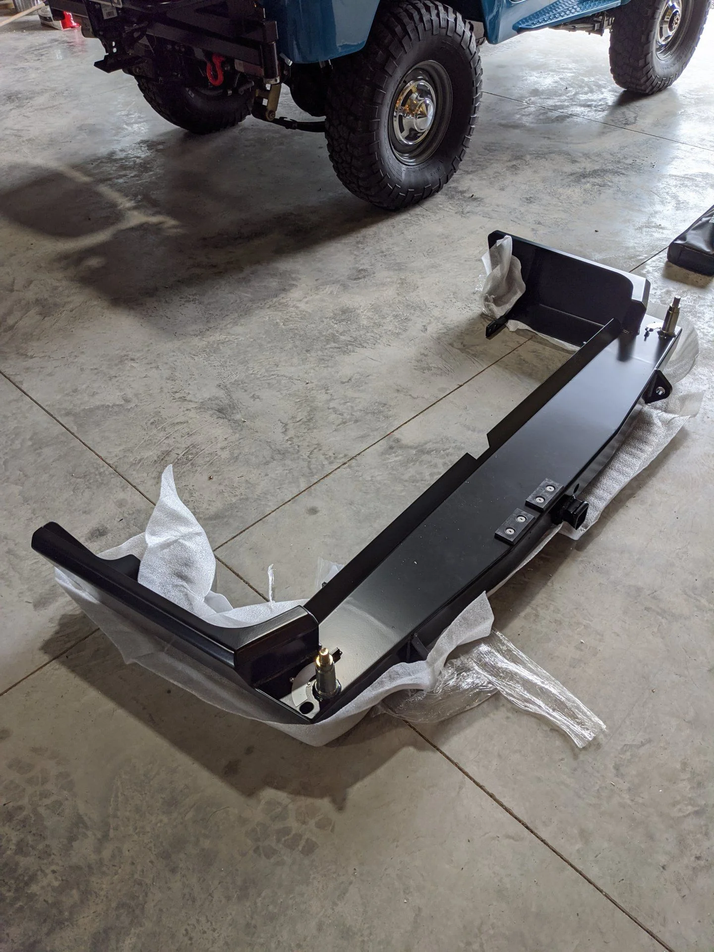

Saturday. Rear bumper and associated attachments. All day.
Got it wrapped up late in the evening. Again a couple of little things to tweak but overall good to go. Always impressed with the quality of Slee stuff!

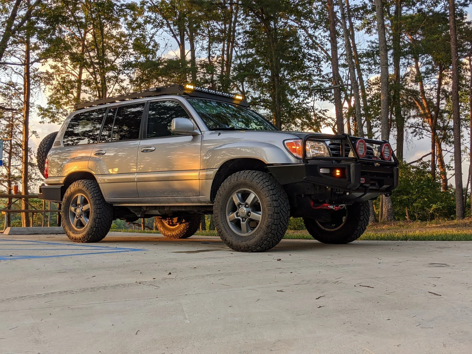

The extra weight is definitely noticeable! I would say that on-road driving is smoother and more mellow. Acceleration is a bit more sluggish but actually not that bad. Braking is where it's the most noticeable, especially going down steep grades. I haven't taken it off road like this yet
Thanks!

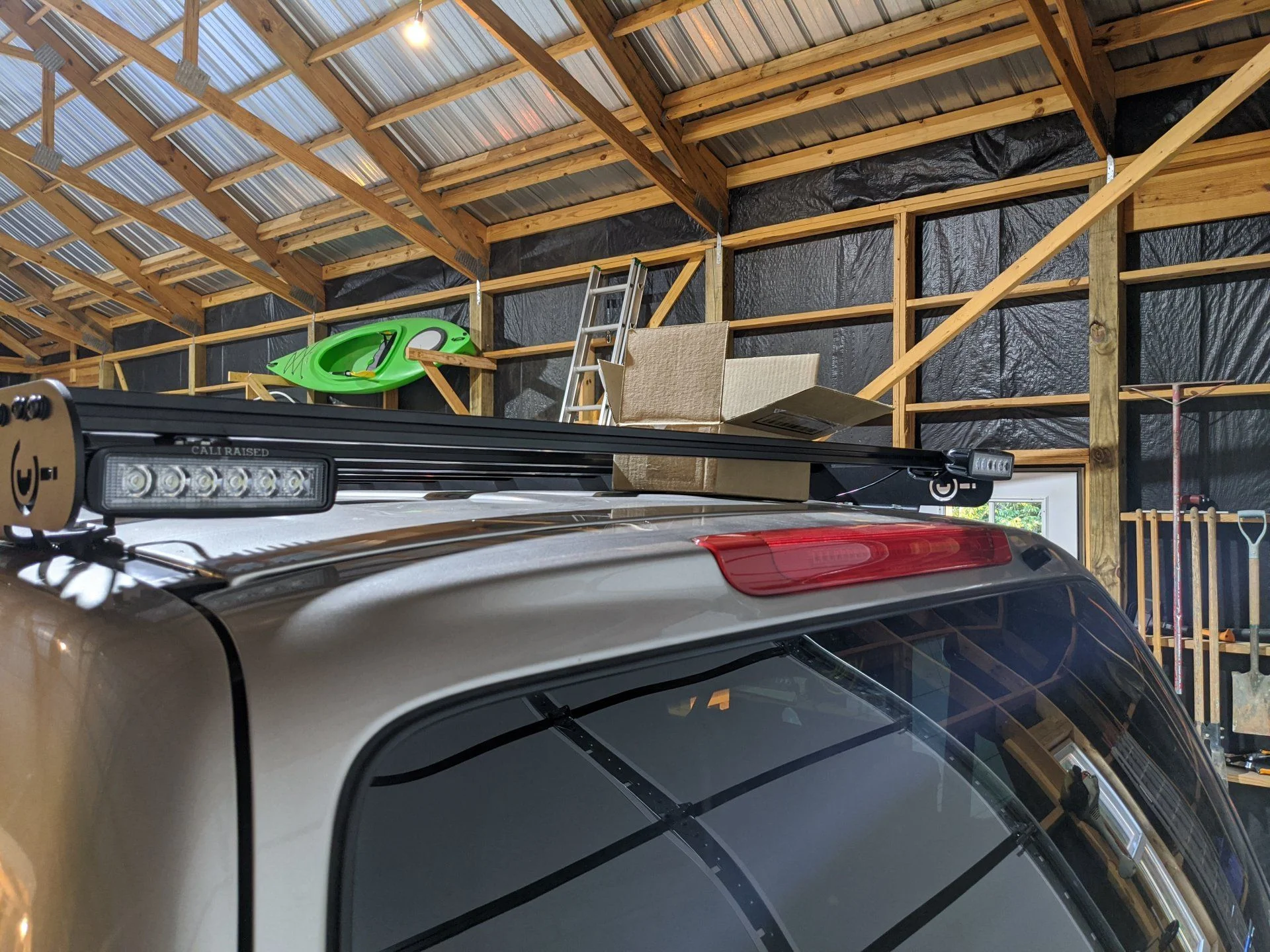

I'd give the rack 4.5 stars..
I'm still working with the light bar to reduce wind noise but that isn't a rack issue.
The rack itself is very nice and Prinsu has been excellent to work with
