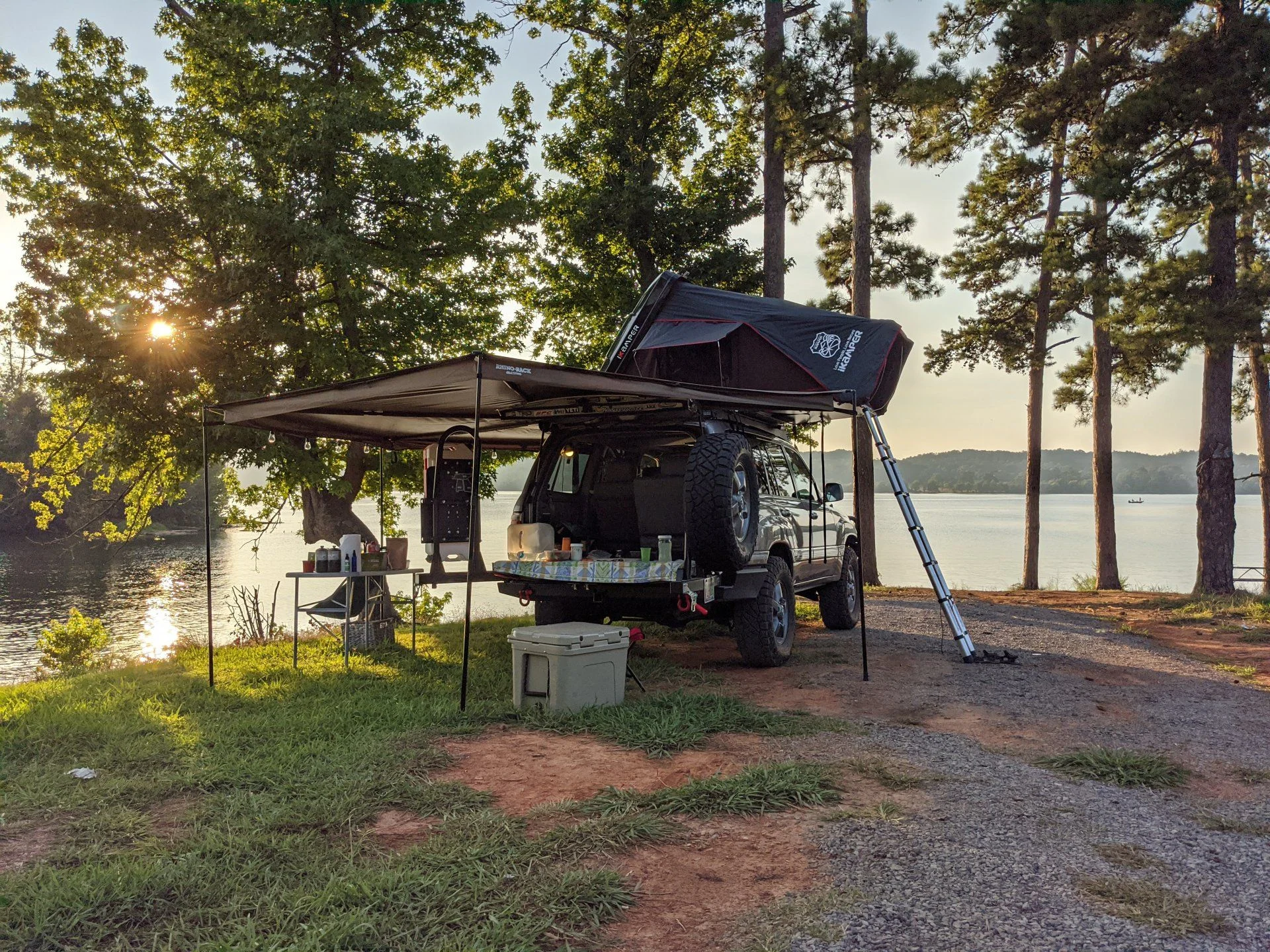

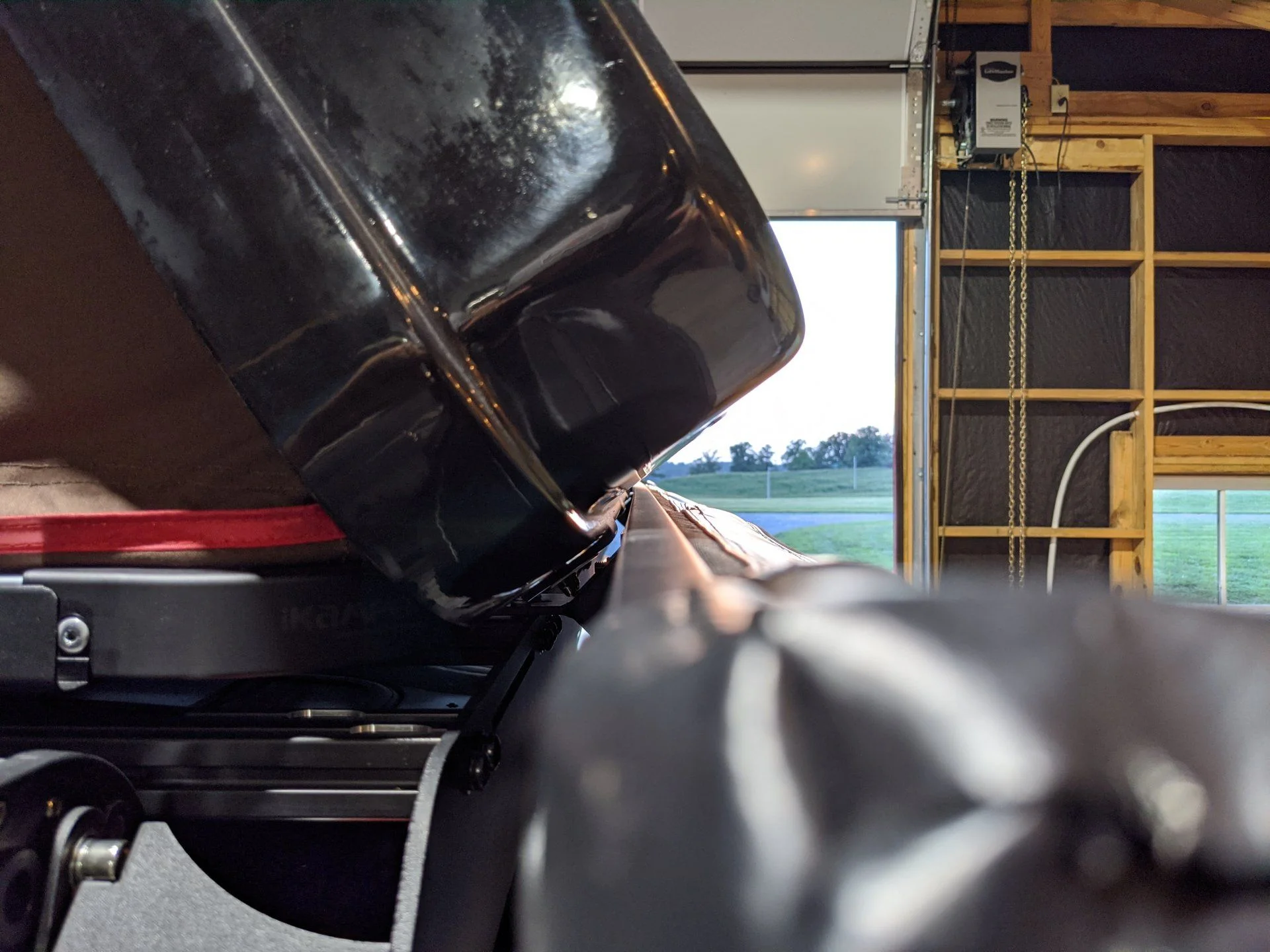

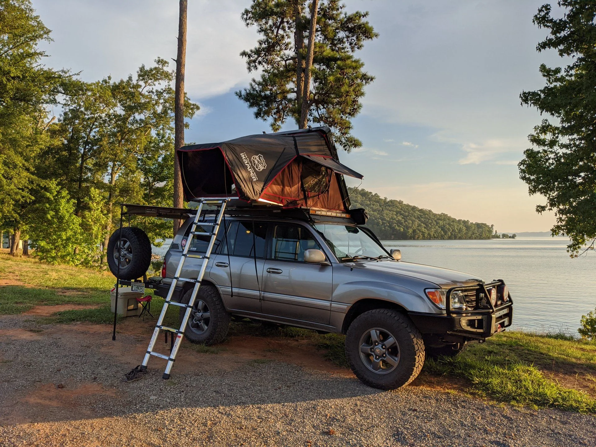

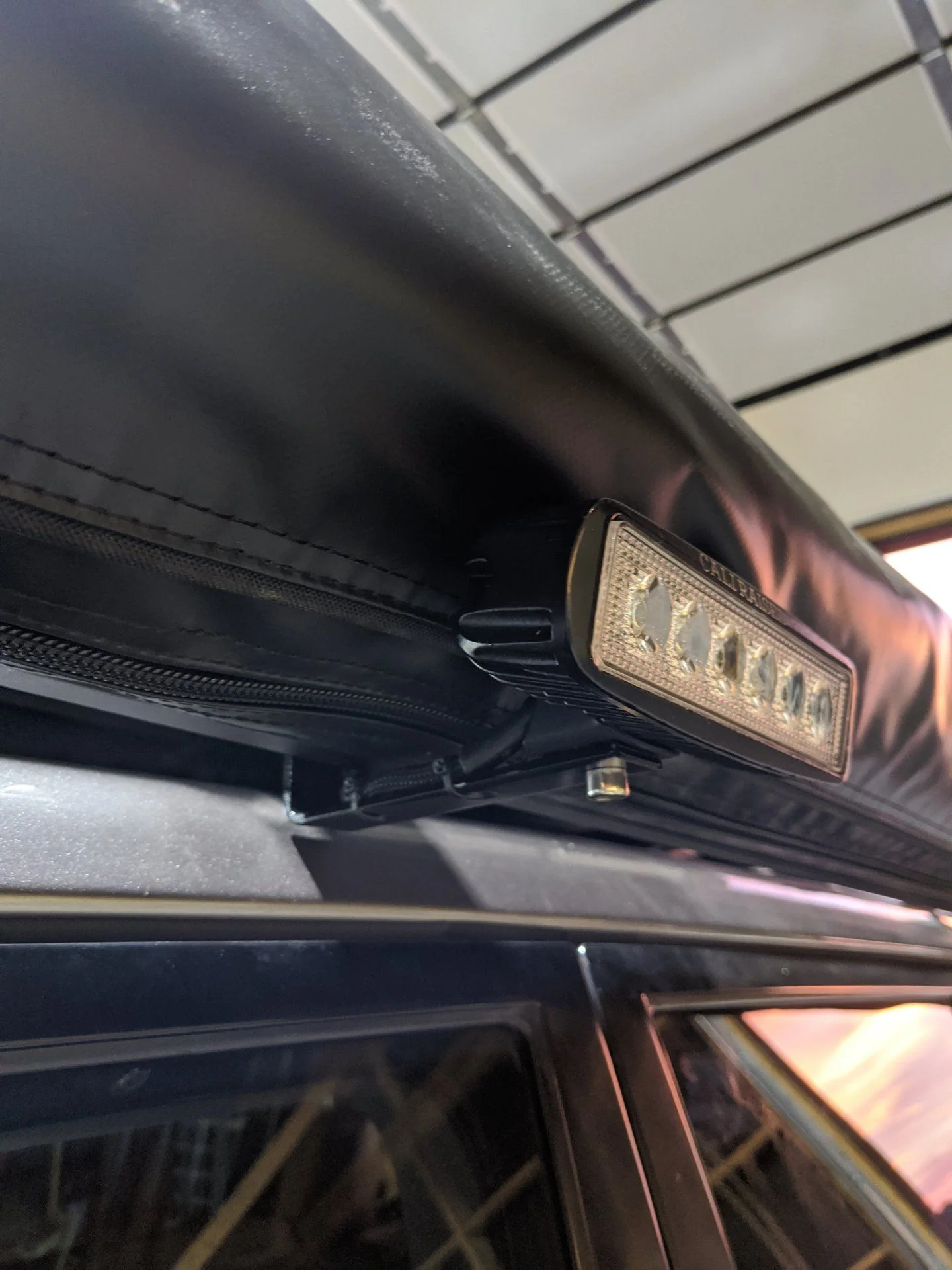

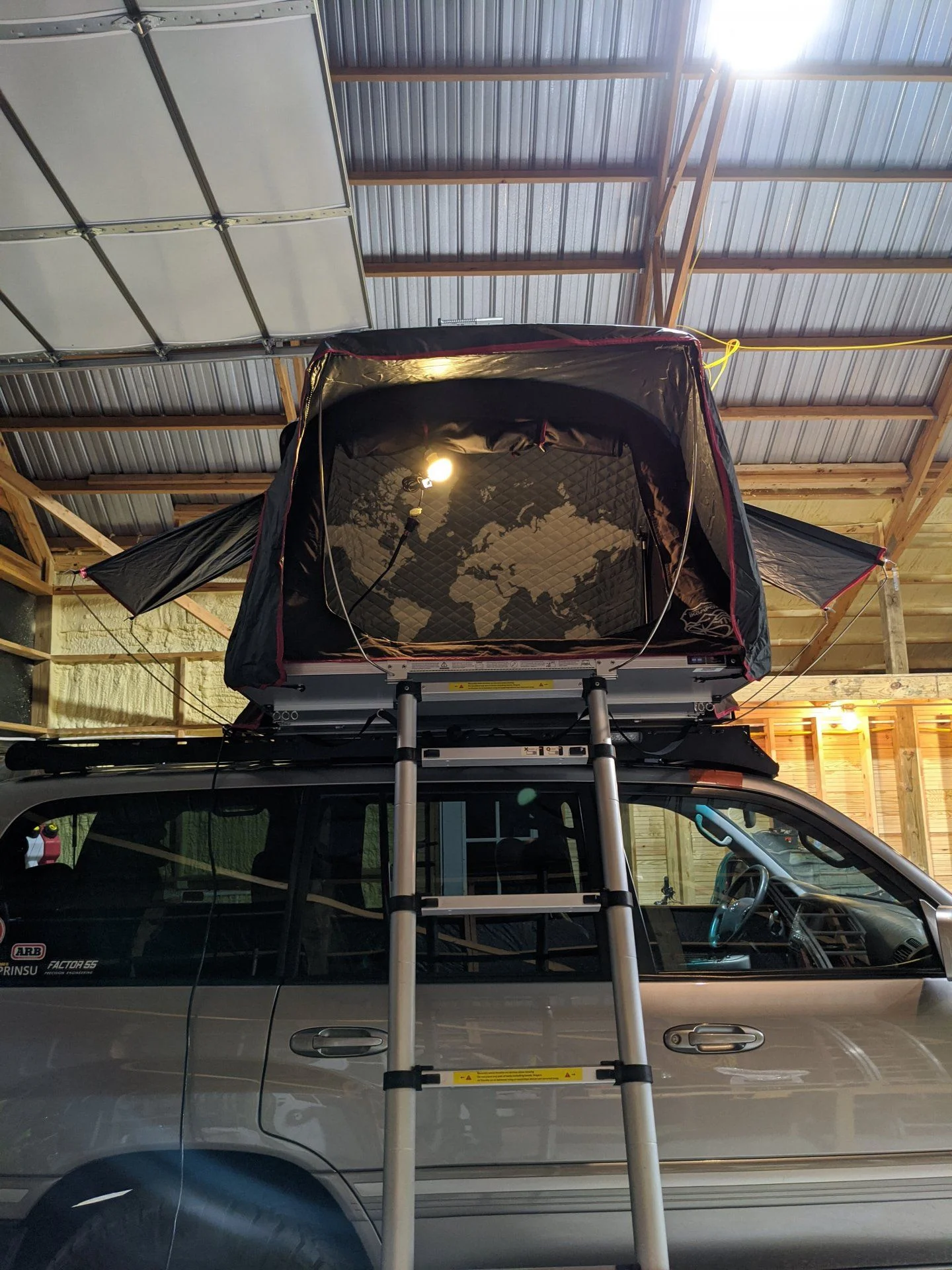

Tent/awning compatibility has been a bit of a head scratcher.. Stupid me, I didn't think about the fact that the ikamper RTT (which opens to the side which is why I settled on this hardtop) needs space on the hinge side to open up... Awning was in the way. After a lot of measuring and consideration, I flipped the awning brackets over which lowered the awning 2 or 3 inches. This works but now I need to rethink my side light because there isn't enough space between the awning and the top of the doors. Also, the RTT is off center which is a bit weird looking but it'll have to work... None of this is awesome but the alternative is removing the awning and I'd rather live with a little weirdness.
(side note: realized that one of the seams on the awning bag is coming unstitched.. Will see if RhinoRack will warranty)
Mounting the tent was a puzzle.. Access to underneath is extremely limited. (wouldn't be bad if my sunroof worked! Now I have a very good reason to get that taken care of) The awning has to go on first which further restricts access on one side... Overall, it's just a bit frustrating.. 😖
Anyhoo.. The tent and awning are installed and I got the 12v power outlet routed into the tent for a light and phone charger. Next I need to figure out how to get my side light reinstalled in some way that it doesn't interfere with the awning or doors.
A few pics...

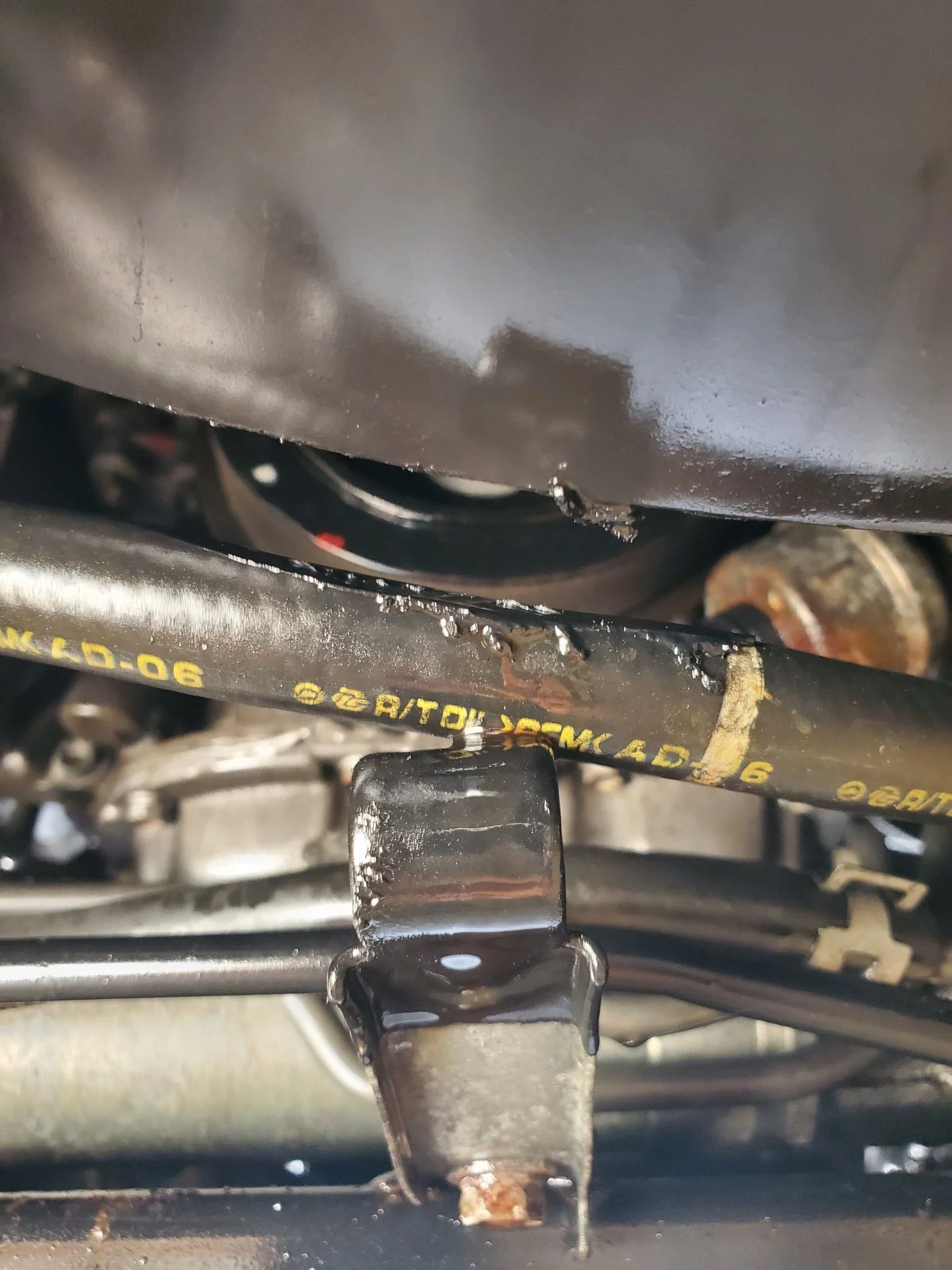

On the way back to the house, after bouncing over a railroad crossing, there was suddenly no engagement in the transmission for a few seconds! Suddenly it engaged with a lurch and then it was really "soft" feeling like there was a lot of slippage. I shifted into a couple of the other gears and got the same feeling. About that time we smelled hot oil and the saw the smoke.. Pulled off the road and killed the engine. Oil was raining down under the truck and by this time was sprayed on nearly every surface including the rear bumper/window etc! The engine bay was an absolute mess!
Anyway, got a wrecker to take us home. Next day had it hauled to @RocketCityCrzrs. Verdict: transmission oil cooler line jumped out of its cradle and the fan nicked it. Oil sprayed out into the fan which distributed it liberally across all surfaces.
Not as bad as I feared which was a big relief! Back up and running again now.. (cooler line properly secured) Still a huge cleanup job though.. Steam-cleaned what we could today but still a lot of film on things. It's literally all over the vehicle.

Glad to hear it was a "minor" failure and you're back up and running. I think in the morning, I'll look for the hose you're referring to and double check it. Great pictures BTW! How do you like the tent, I hear the iKamper's have a pretty decent foam mat?
X2, would love a picture of the hose that got knicked so I can also check to see if mine is properly secured. Glad it wasn't catastrophic, I know you have put a lot into getting this rig ready. BTW, your old OEM bumper I got from you mounted right up and looks great, thanks again!
