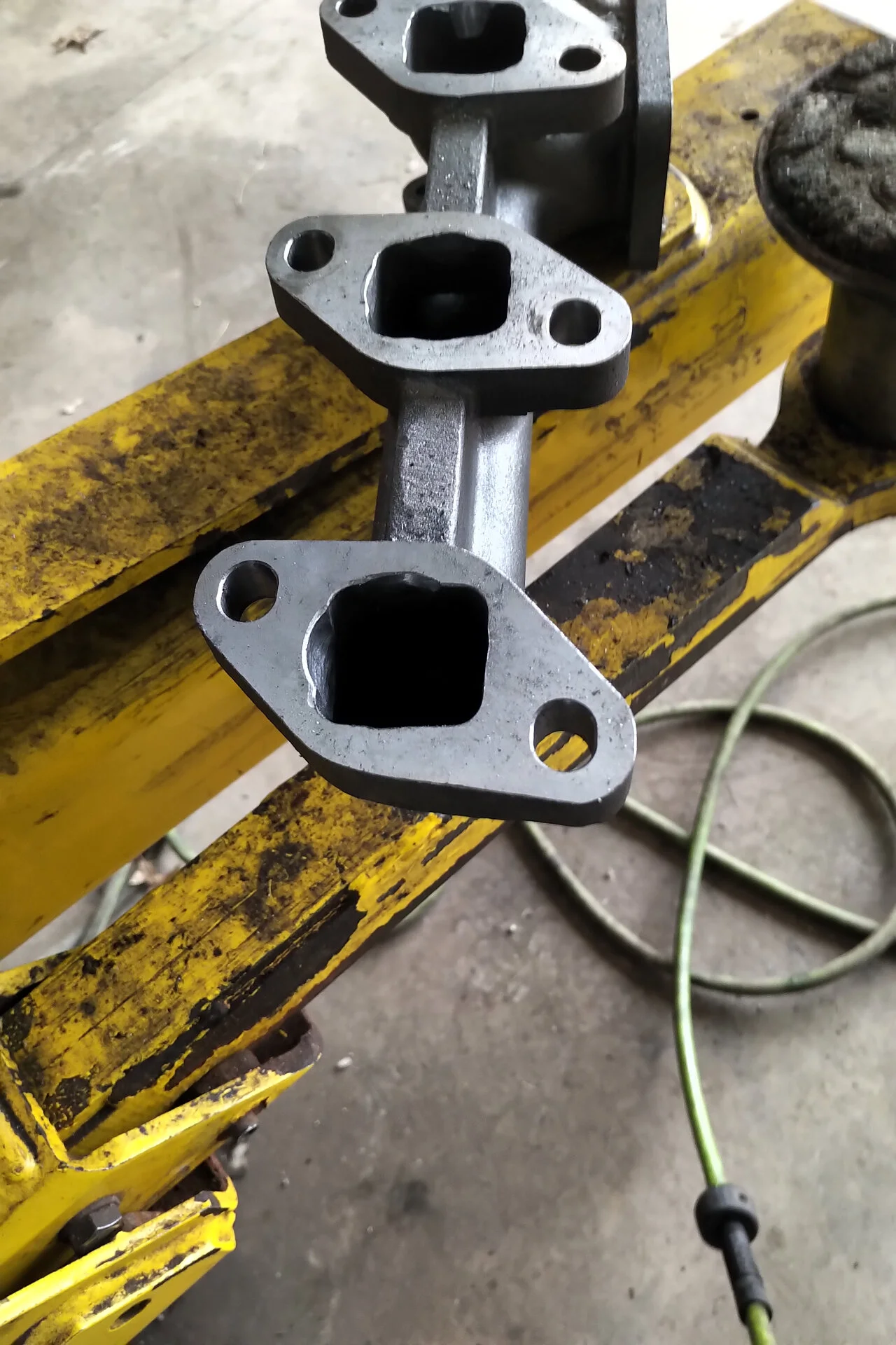

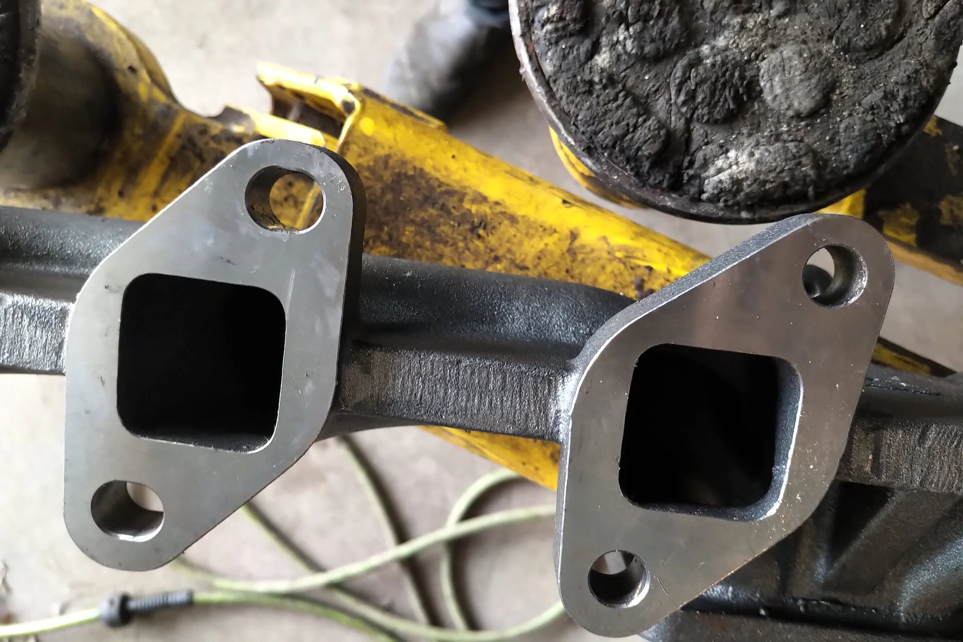

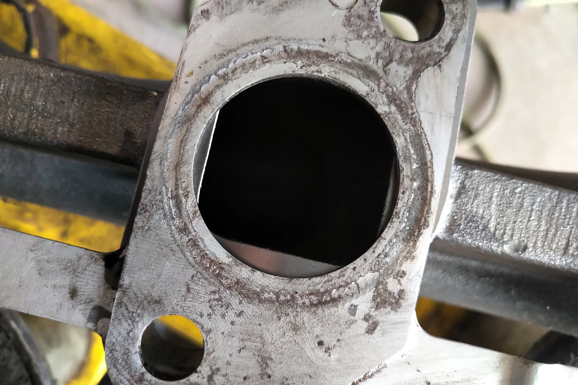

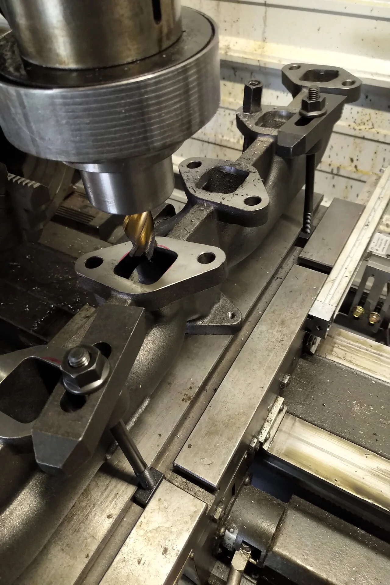

I have their T3 manifold (to run with a twin scroll turbo) its not a great fit for the 1hdt as the ports on their manifold are square as you can see in the picture the ports on 1hdt are round the bolt holes have been milled out to fit the 1hdt studs. the bore spacing is off for the 1hdt slightly. I spent a bunch of time matching the ports as best i can by removing material but really for it to be right you would need to weld the corners of the squares up also. Their are alot of people that swear twin scroll even with an open scroll turbo can still be a benefit. i haven't done a back to back test. but i have done tests on other motors twin scroll turbo on open scroll manifold and then to twin scroll manifold and there is a significant difference. In my option every straight 6 with a turbo should be twin scroll. you might just weld a divider into your stock manifold and you might be better off, not sure. i wish i would have just bought a flange and made my own manifold with weld els.

@TheBussman thank you for the reply. I was told these "work flawlessly" with the 1HDT head by a Tillix rep, but looks like there is a significant amount of work that needs to be done? Also, what T3 twin scroll turbo are you using?
It may be that it works fine but the ports just don't line up like I wish they did. I'm going to try a Holset HE250WG with a 8cm twin scroll housing. if it's too laggy i have a 6cm one I can put on also.
