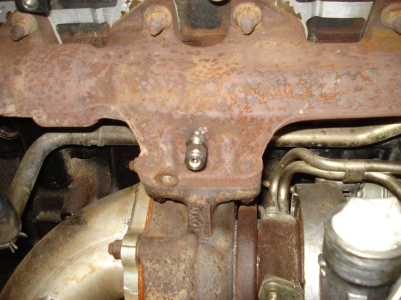

OK, here are some pics:
The block back from the machine shop and the rebuild injection pump installed.
