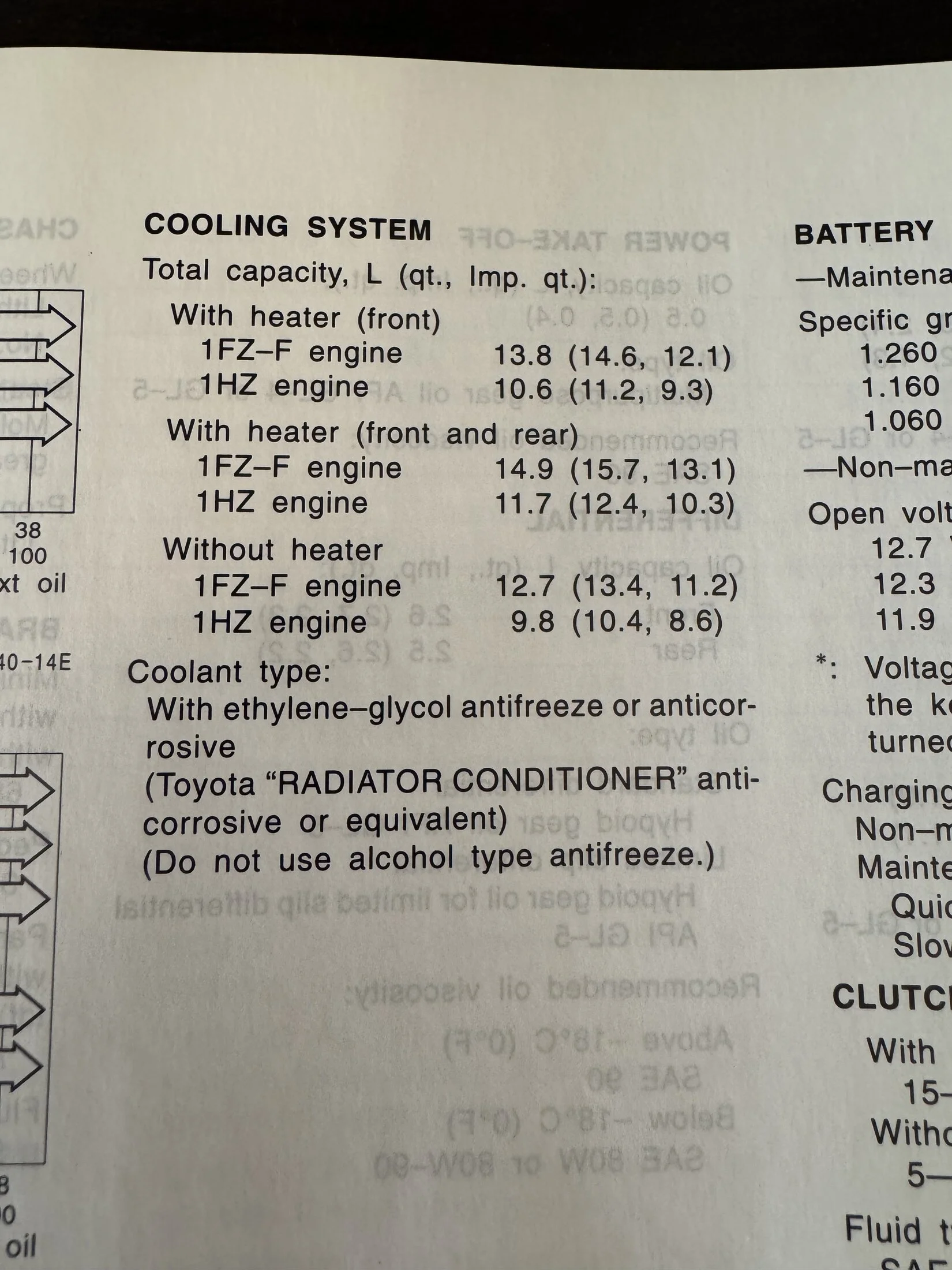

Hello brain trust. Im looking for the exact capacity of the cooling system for the 1FZ-F. I am getting a variable of answers. Any help would be much appreciated.
Depends on a myriad of factors. Is your radiator the OEM one? Do you have rear heat or AC?
What variant of 70 do you have?
75 series. Yes , AC.
My mechanic was asking out of curiosity. I did a lot of research online, but did not get the exact answer. If you wouldn’t mind looking in the owners manual, I’d really appreciate it.
Here you go:
