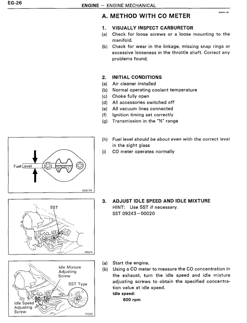

Hello,
You may find this information useful.
It is good to set idle speed to 700 +/- 50 rpm at altitude.
To be continued.
Juan

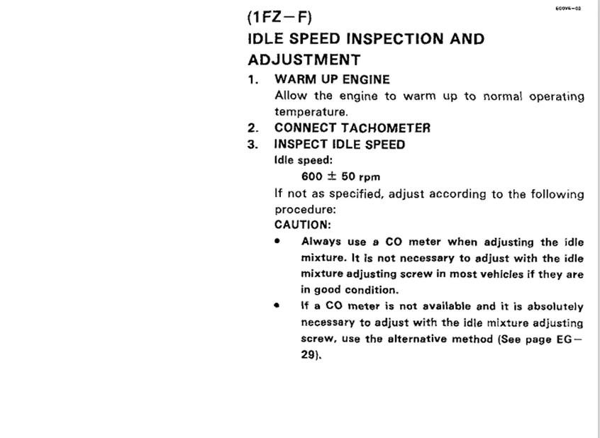

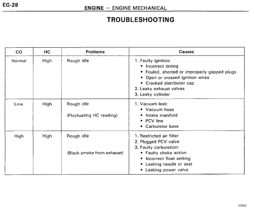

Hello,
Regarding fast idle and related stuff.
The tuning requires quite a bit of patience.
As I mentioned before, it helps to clean/replace the sparkplugs and having the distributor contacts cleaned.
Hope this helps.
