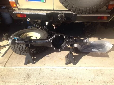

Wayne put your glasess on and put the beer down. From the photos it is clearly low pinion 9.5'' diffs front and rear, pre 1990. Being a from a mine truck I would not worry to much about the year the vehicle is, as previously mentioned parts have been swapped around on the diffs you have. Looking at the rear it is from a later model than the front, see the difference in the webbing on the carrier housing. This could also mean the ratios are different front to back. Ie, they could be 4.11vs4.10

So even pre 90 had the gusset on the bottom of the front axle from the pumpkin to the spring pad then?
and that odd wind catcher on only one side of the front axle?
Mace-
tomorrow I can take a shot of the front '87 cable locker I have on my truck that has the gusset. I also have a fj62 tube with the gusset. Came out after the 60 series....
Okay, so a 9.5 ring gear with the gusset housing was late 80's?
Probably swapped into this mine truck for some reason. Which sounds like it was something that was not exactly uncommon? Both axles came from the same truck. I am positive about that.
And the rear axle has some additional webbing on the third which means it was more like 95 which is the year the truck was.

1987 full size front 70 diff
1990 small front 70 diff
just for comparison.
Neither of those have a gusset at the bottom. Any idea what year those were available?
So that 89 has the gussett in the bottom of the axle tube?
no idea, it is buried under the snow, but, that is the last year of the full size front diff in the mine trucks .... that i know of.
