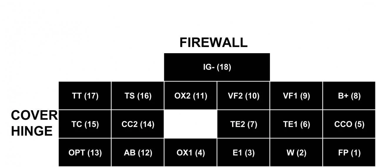

Try jumping the fuel pump as previously suggested just to rule that out. I doubt it will help, but it's easy and fast.
With a small piece of wire jump terminal FP to B+. This will fire the fuel pump continuously while the key is in the ON position.
View attachment 950755 Try jumping the fuel pump as previously suggested just to rule that out. I doubt it will help, but it's easy and fast.
Jumped the fuel pump with a paper clip... Pump worked but still no start.
