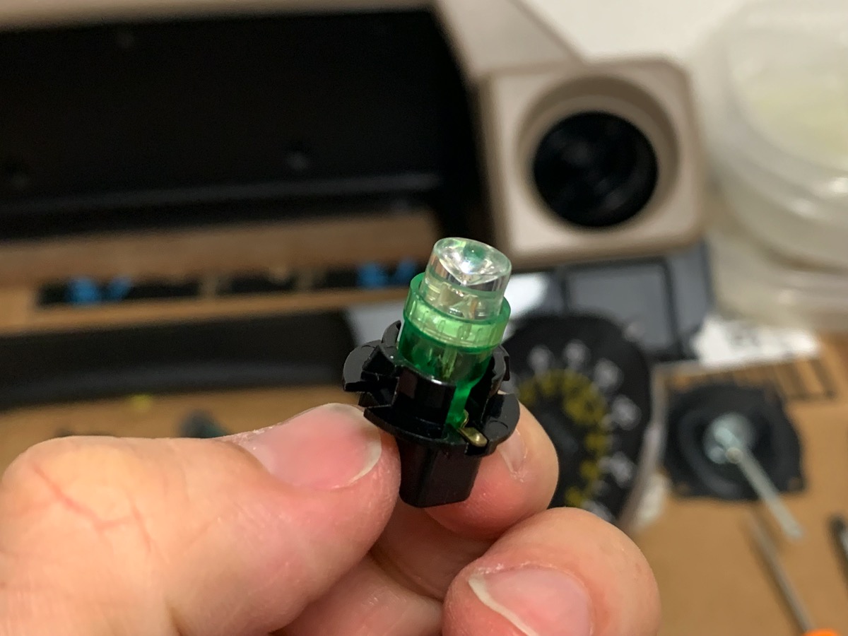

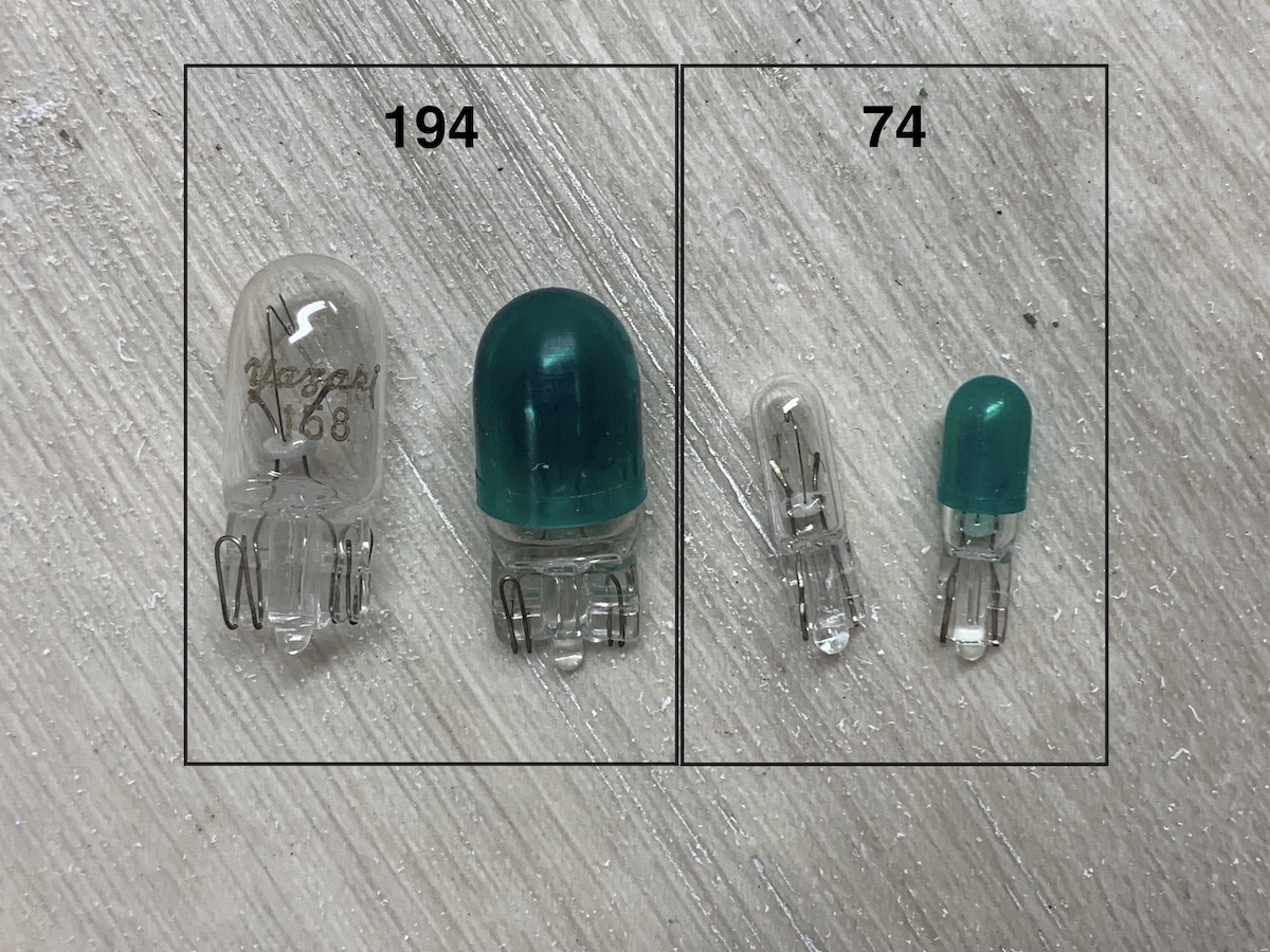

So I got my LED bulbs from Super Bright LED's. I used this FJ60 thread as a starting point for my research... and then kind of figured out what specifics I needed from there.
Once you dig into your cluster and dash lighting you'll generally find two types of lamps... form factor 194 and 74. Inside the cluster you'll find the general backlighting lamps covered with a green cover that gives the green tint. Those are replaced by green LED's.

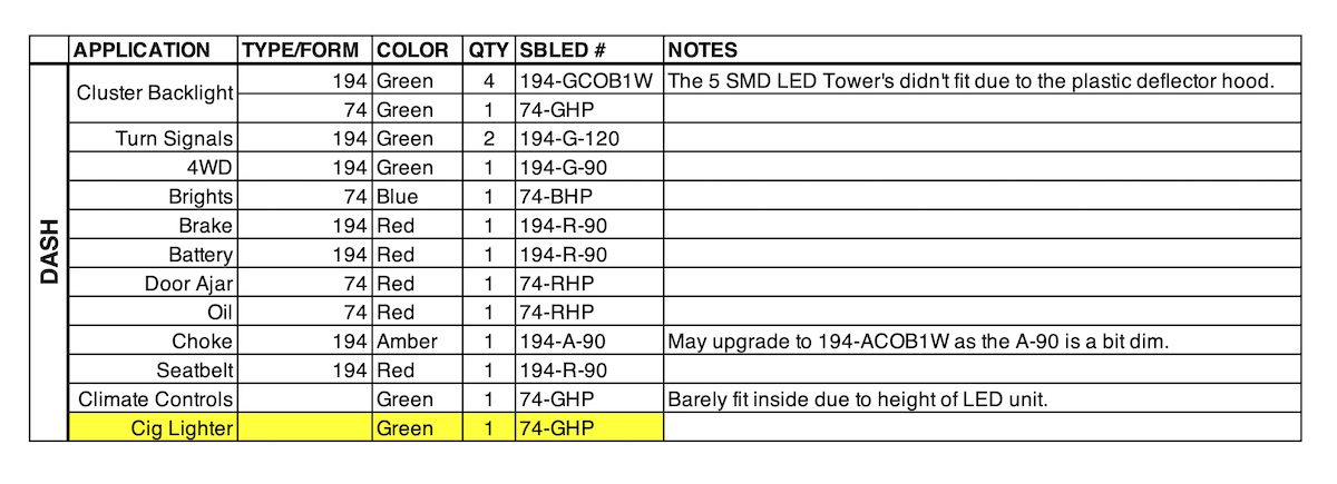

So, ultimately, the LED's I ordered were as follows:
I'd recommend going through your cluster and quantifying how many you need, what size you need, and what colors you need, before making your order. I ended up with several orders to finish this project off. Doh!
My biggest mistake was ordering green LED's for the general backlighting that conflicted with the plastic hoods that reduce hotspots of light.
The plastic piece at the top kept the first 194 LED towers I ordered from working. So I ordered these instead... which much more closely match the original bulbs dimensions.
This 194 type was one of the 120-degree spread turn signal indicator LED's.
Do you have link to the LED bulbs you found worked for the backlighting of the cluster?
You bet... here it is. I needed four of those.
I also needed one of these.
My cluster used 4 of the 194-size... and 1 of the 74-size
Note that in the column labeled "SBLED#" those are part numbers from the Super Bright LED's website. You should be able to enter those part numbers in their search and have it hit the same item.

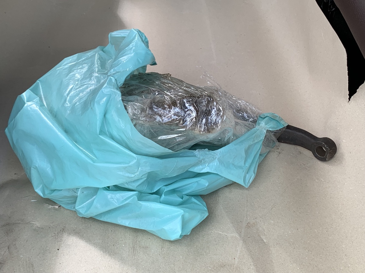

So my power steering box has been leaking something awful... since I got it. But it's been getting a bit worse. I asked @John Young if he could help me out with sourcing a spare box. A 70-series power steering box isn't hard to find over there... he pulled one off another 3F-powered truck similar to my own.
A spare will let me rebuild one on my workbench... and then swap it in upon completion with no downtime. If the OEM rebuild kit doesn't prevent leaking then I'll send one of them off to RedHead.
Granted a power steering box isn't exactly light... so how to get it to the States?
You wrap it in another 70-series that's already being shipped to you!
Sure enough, safely wrapped and sitting in the back was my spare steering box.

If your steering box is/was leaking like mine then the rebuild kit w most likely not stop the leak. The seals on mine made grooves in the shaft so it kept leaking. I ended up getting some aftermarket seals of the same O.D. And a very slightly tighter I.D. and it still leaked. So I put a second one on and that stopped the leak. Maybe if you didn’t install the factory seal into the same place that would fix the leak, stay out of the groove.
Thanks for the heads up and pointers on this. I rebuilt the box on my FJ40 and also found the factory rebuild kit didn't completely stop the leaking... but it drastically reduced it.
Specifically you're talking about the output shaft seal where it exists the housing... just before the splines?
