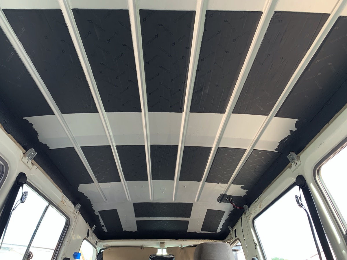

Busted out the Spectrum. Thanks again to @c2dfj45 for sharing the information on all things secondskinaudio. I put in the damplifier first to augment the overall effectiveness of the Spectrum.
First I brush-painted several layers at the edges of the roof.

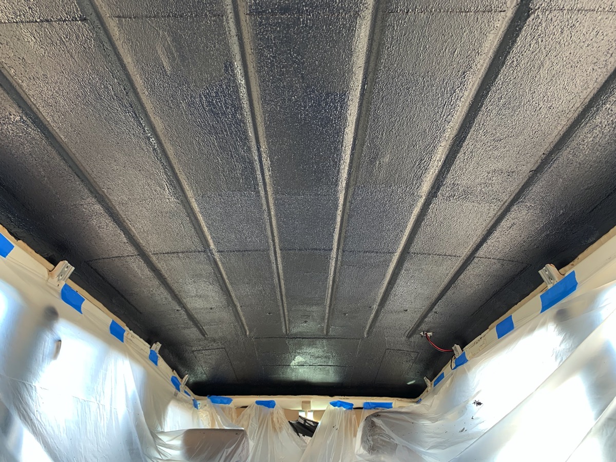

Then I rolled-on three layers for the rest of the roof.

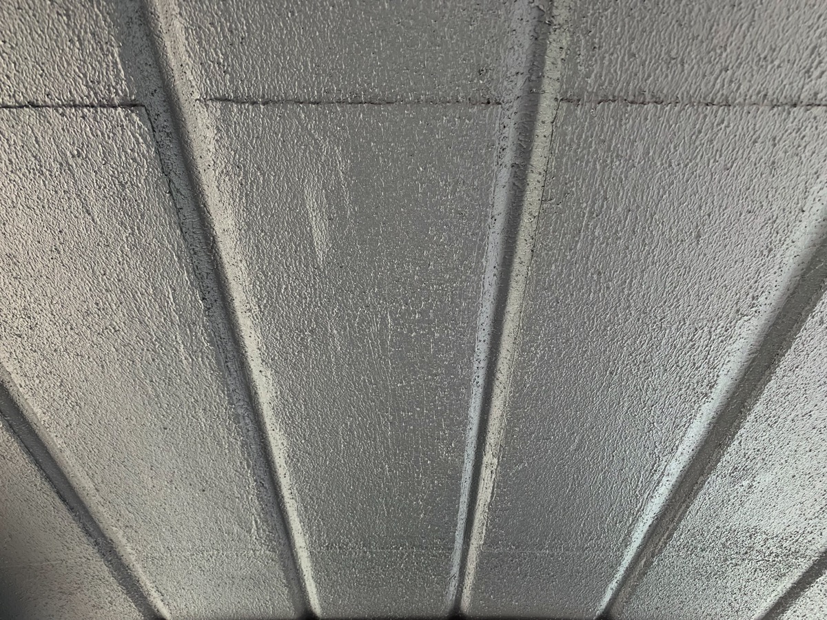

The finished product.

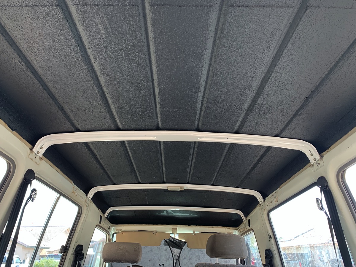

Cleaned up my roof braces/cross bars and then gave them a rattle can repaint to top things off. The rest of the interior looks all the more dingy now.
You gonna do a headliner?
That is the long term plan. For now I have the thermal and audio insulation vastly improved… not to mention the rigidity of the roof. It’ll be awhile.
Nice,,, i assume you did this before you w/e trip, big difference?
I actually did this several weeks ago... and yeah, it's made a difference. I also recently got rid of the BFG KM2's and put on some Discoverer AT's... which also really helped. It's quieter now for sure.
