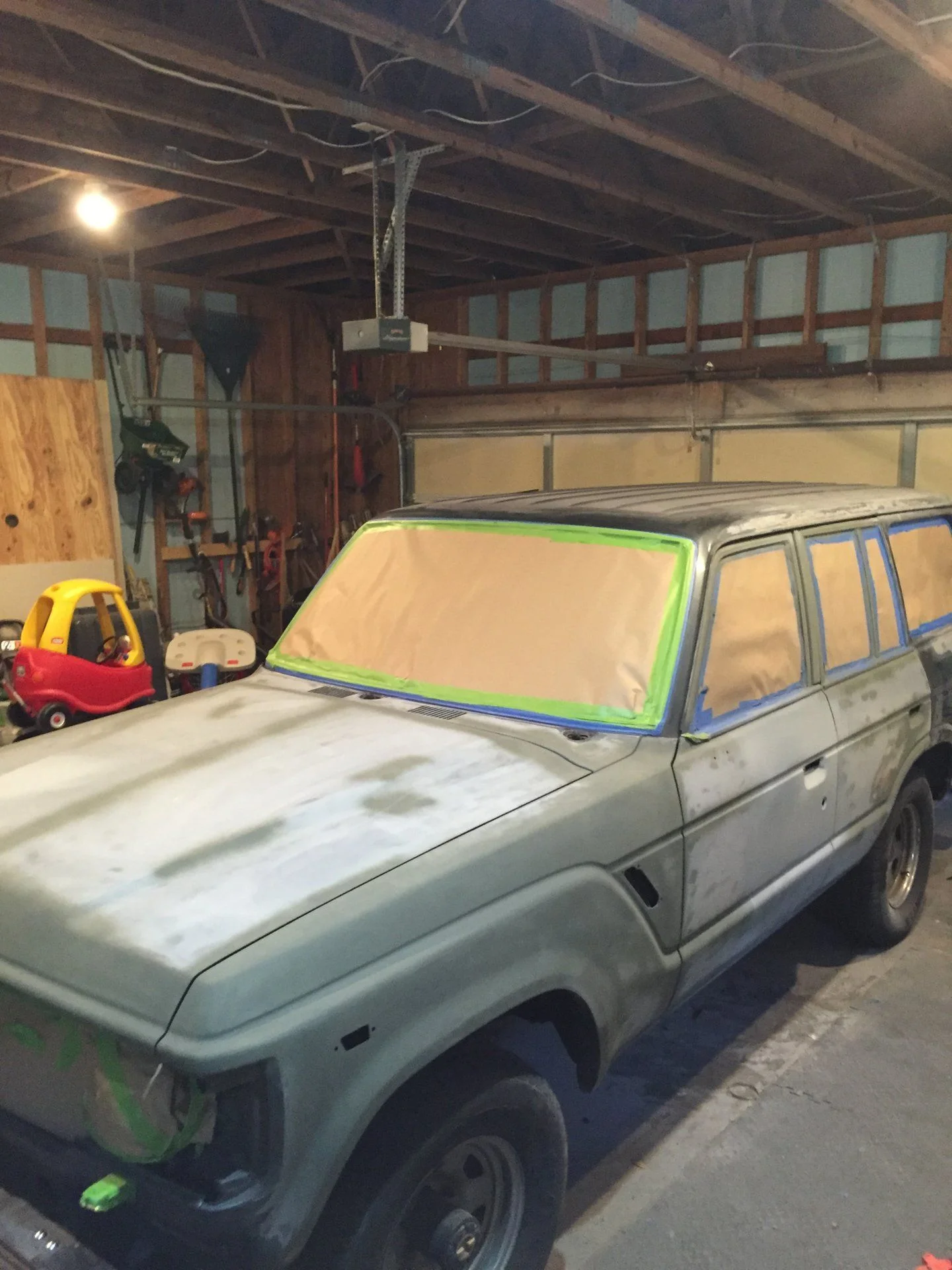

The first line of business was getting rid of the rust and paint.

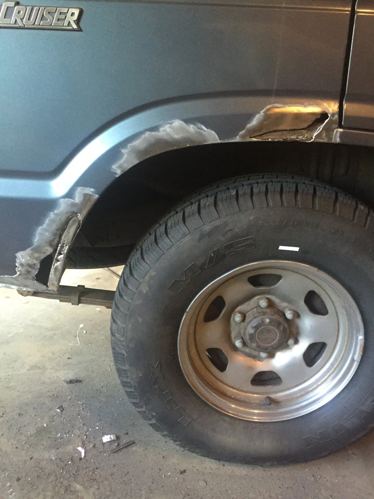

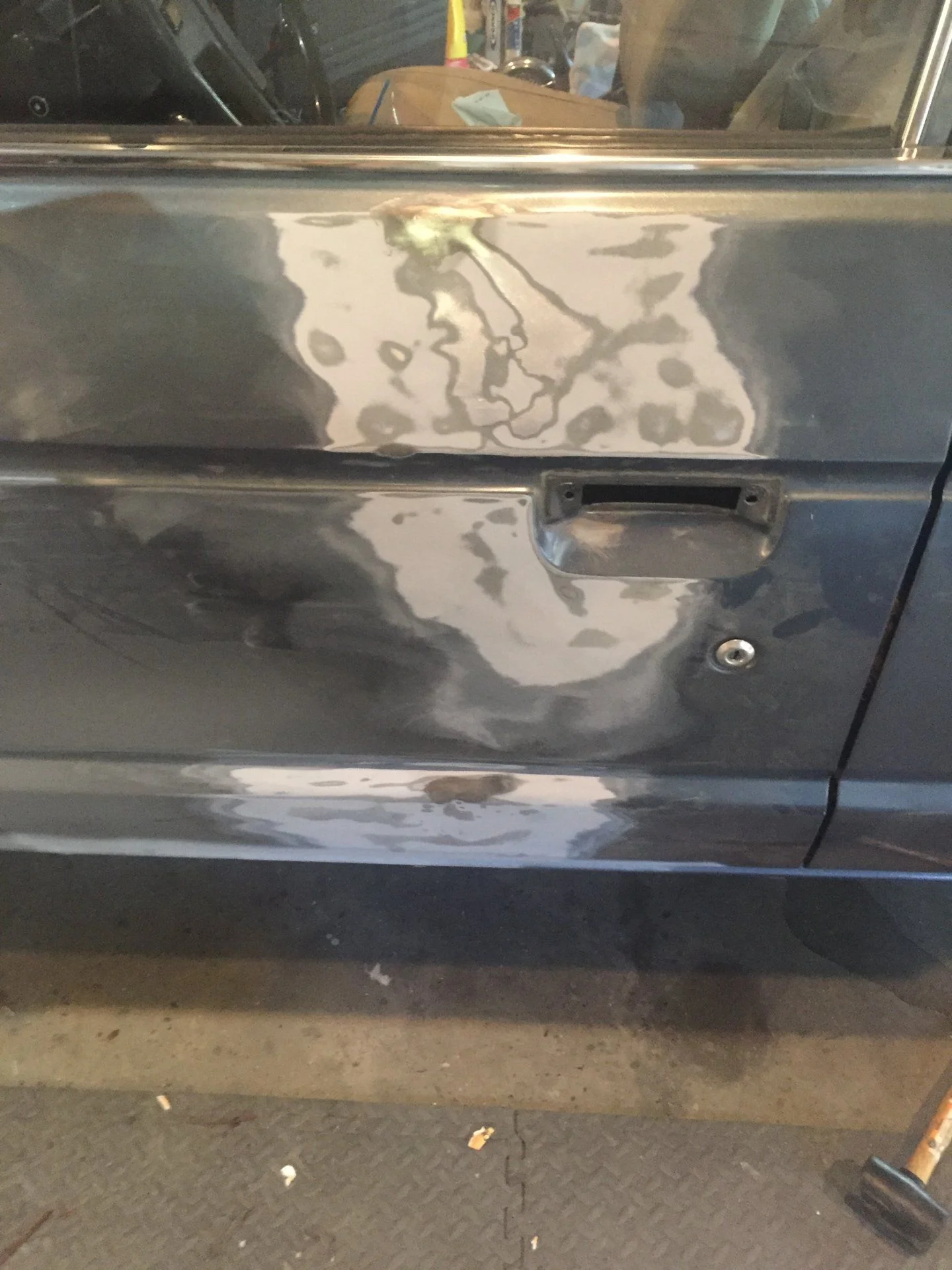

So, I learned how to weld and welded in some sheet metal etc. removing all the rust I could.
Yep this was an amateur paint job. Harbor freight paint gun, etc.

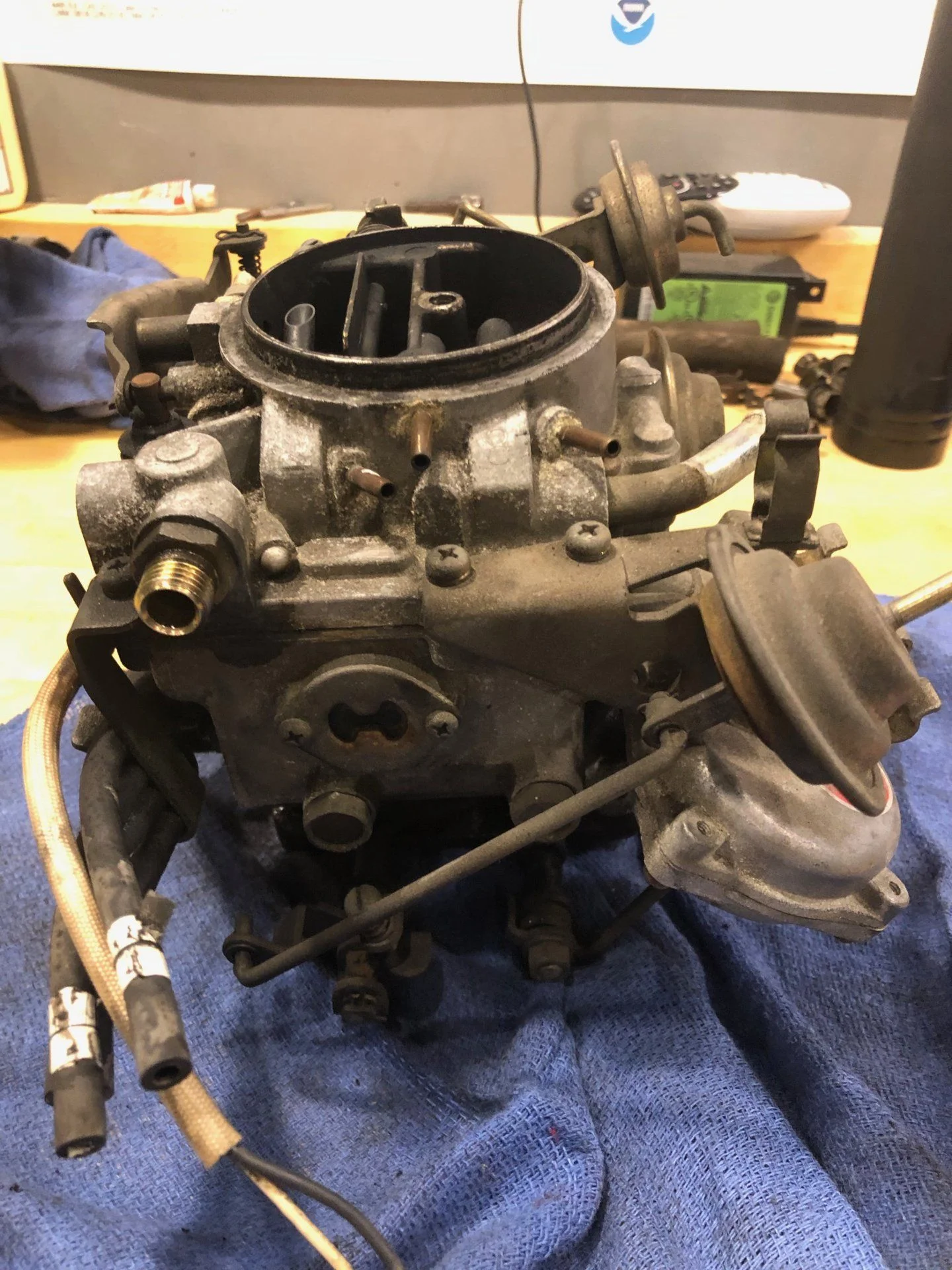

Even though the fuel lines were redone, it still ran like crap and I could only sometimes get it to crank often it flooded and Id have to wait 20 minutes before trying again. So next step was rebuild the carb. I followed the Pin Head you tube videos to a T.
The carb rebuild really wasn't bad. Just follow the steps on the Pin head video and its all pretty self explanatory.

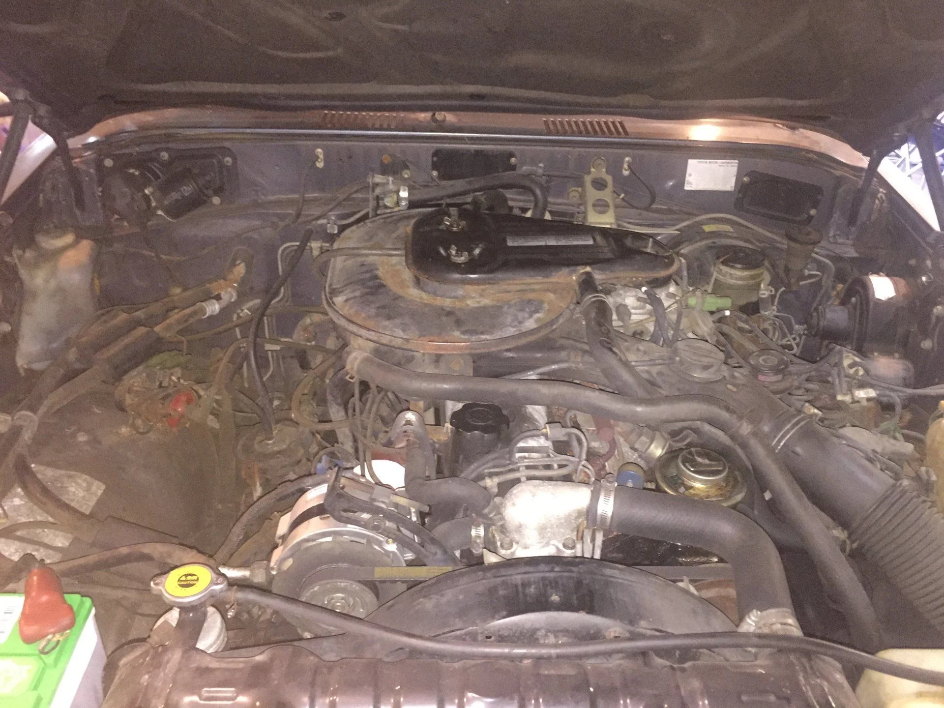

Next, I redid all the vacuum lines cause it was still surging and sputtering. and my vacuum pressures were way off.
Welp, that still didn't work so it was time to dive in deeper. Spraying starter fluid anywhere around the engine indicated a vacuum leak so it was time to tear into the intake and probably replace the gasket there.

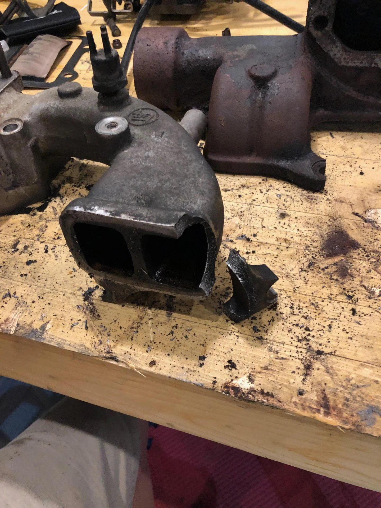

Well, I found the culprit.

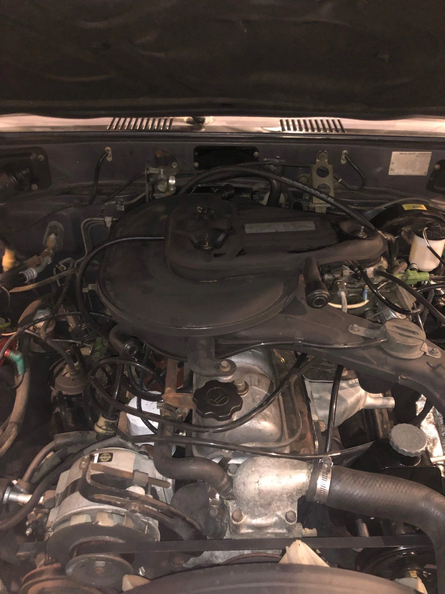

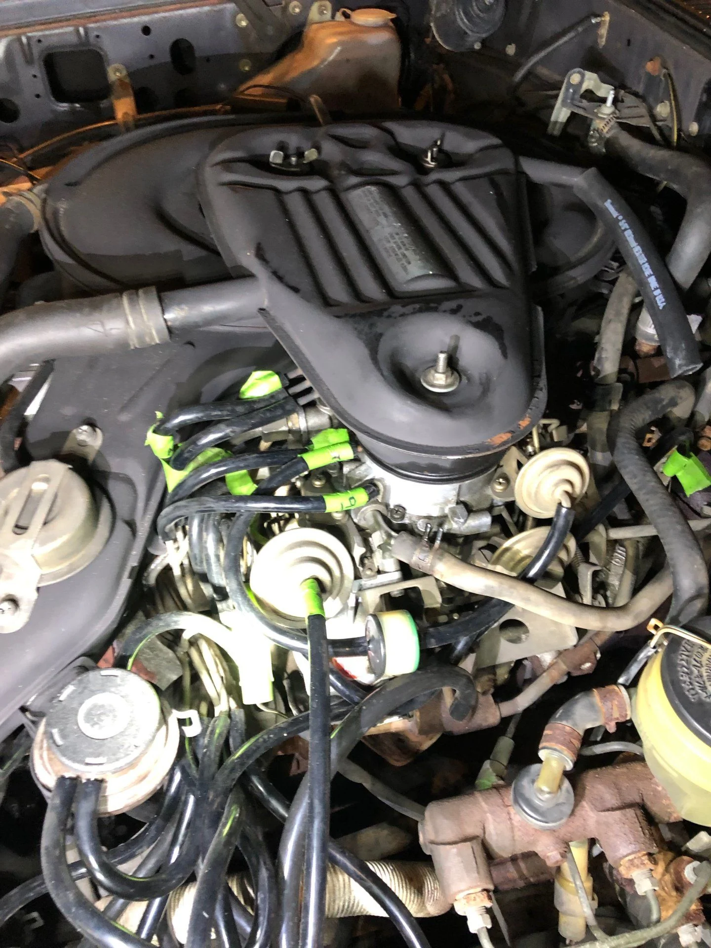

Well, having all of this apart it seemed harder to put it all back together so some of my smog stuff went missing. Air pump out, EGR out, air rail out, HAC out, HAI out. HAC is not needed cause Im literally at sea level, and the highest I ever go is about 700 feet.
While I was there I decided to do a Saginaw pump upgrade ordered the stuff from Georg at Valley hybrids and installed seamlessly. Got a new intake from cruiserparts.net. Desmog kit from MAF. While waiting for parts I did the galley plug fix. And studied desmog vacuum routing (and studied, and studied).
Then I plugged everything back together.
Finally, It lives!!!!!
Reset the timing, did the lean drop carb tuning, adjusted the valves, and last but not least I did the "green" wire mod. And it runs like an absolute top now. Cranks on the first turn over. Warms up immediately. It runs like it was supposed to. I can finally rely on it to start!!! You guys are awesome, I learned everything right here and on you tube.

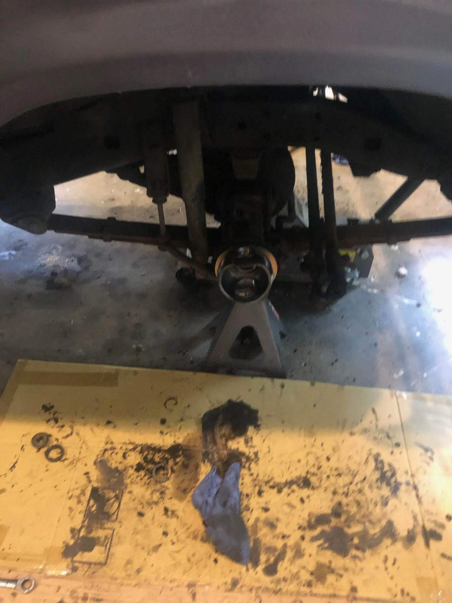

So, I got the engine working like it should but the brakes were dragging, there was differential fluid coming out of the driver side knuckle so it was time to tackle the knuckle rebuild and work on the brakes. There was plenty of info on here and youtube to make it happen.
Rebuild kit from cruiser outfitters, went ahead and put new rotors on the front while I was at it as the old ones were warped and rusty. The calipers were shot as well and after an attempted rebuild new calipers were ordered from oreillys.

That broken intake! Wow! I’ve never seen one broken full through. I’d hang that on my garage wall.
Good for you jumping right in on some hard welding too. I’ve not tackled body panel gauge yet but I have been worked big on my frame. What would you share from what you’ve learned for tackling the thin stuff?

Ha! I might need to hang that intake on the wall. I’m in need of some decorations in here.
I wish I had some advice for the panel damage but it was basically trial and error. I did some research on some welding websites and the key was not to let anything get too hot and warp. Essentially, it was multiple tack welds done across the patch one at a time. It wasn’t a quick weld. More like 100 tacks instead of running a bead. There was also a fair amount of epoxy (my last project was a boat so I was good at epoxy and fairing) and some bondo.

That took a while all the old paint was removed with a hand sander down to metal then primed and repainted. There’s some stuff I would do different and unfortunately I had a storm roll in as the clear was drying causing some dust issues and imperfections in the clear coat. But, I’m cool with that. She’s not perfect but I can say I did it all myself.

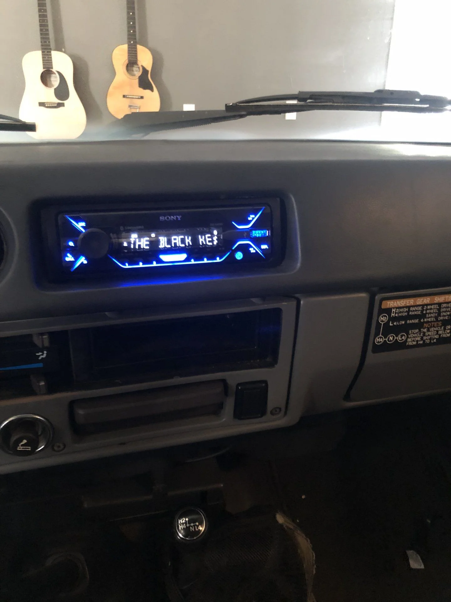

New stereo today. Replaced a 22 year old aftermarket stereo/cd that my wife had bought back in high school. It’s great to have Bluetooth in the old girl. Would have liked to have something more classic looking but...

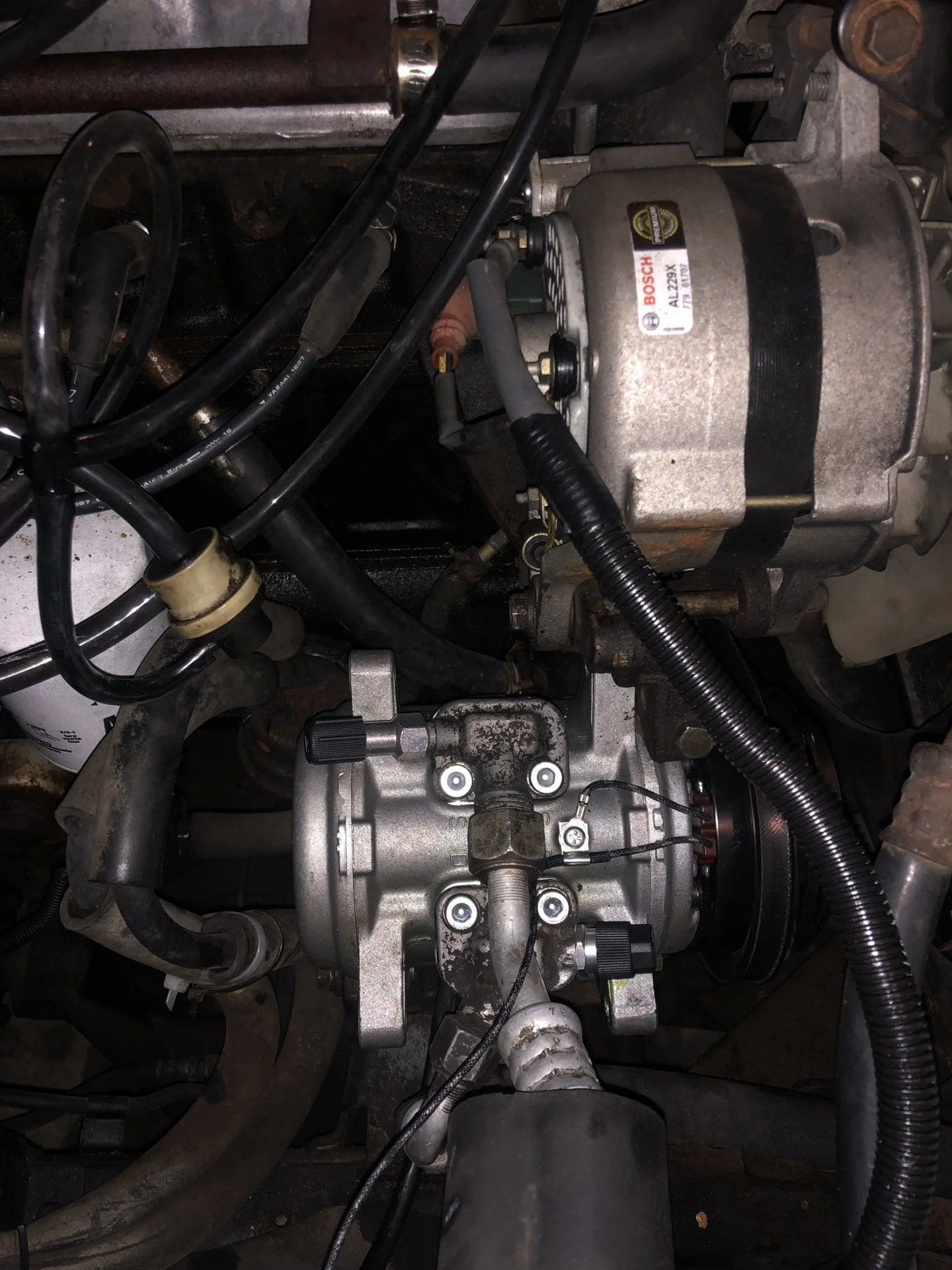

Welp, I decided to tackle the ac this week. I did a ton of reading on here and elsewhere and decided that it’s really not that complicated. :rolleyes:
Symptoms were: blue light on the gauge cluster came on fan worked in the cabin. Clutch engaged when hot wired. PO said that it hasn’t worked in about 10 years.
First step, ordered a gasket set online. 7 dollars at oreillys. And took everything apart replacing gaskets as I went and clearing any old mineral oil out then clearing everything with my air hose. Replaced the drier as well and buttoned everything back up.
Pulled a vacuum through the lines and it pulled right down to 30. Held there for 30 minutes. So I vacuumed for an hour. Then started the filling process. Hooked the first can up and low side read 60. The clutch engaged and I thought I was in business. High side made it to 60 and that was it.
Diagnosis: compressor dead.
300 dollars on amazon and I’m back in gear.
Install was pretty simple. I replaced the mineral oil with pag46 with dye.
Went through the recharge steps and boom. Ice cold air.

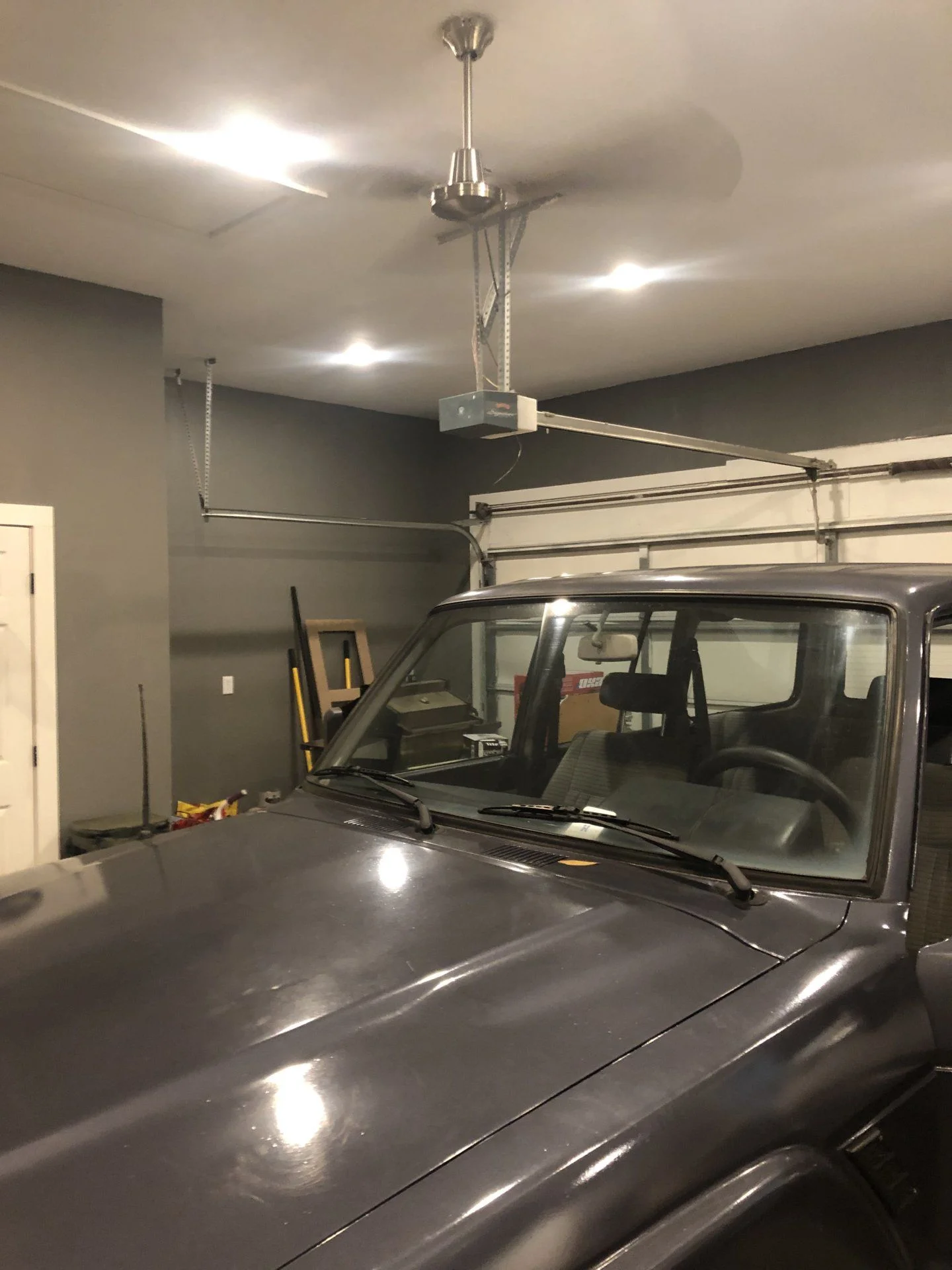

Also decided that the garage needed an air upgrade so...
New ceiling fan.

& garage ceiling fans are great.

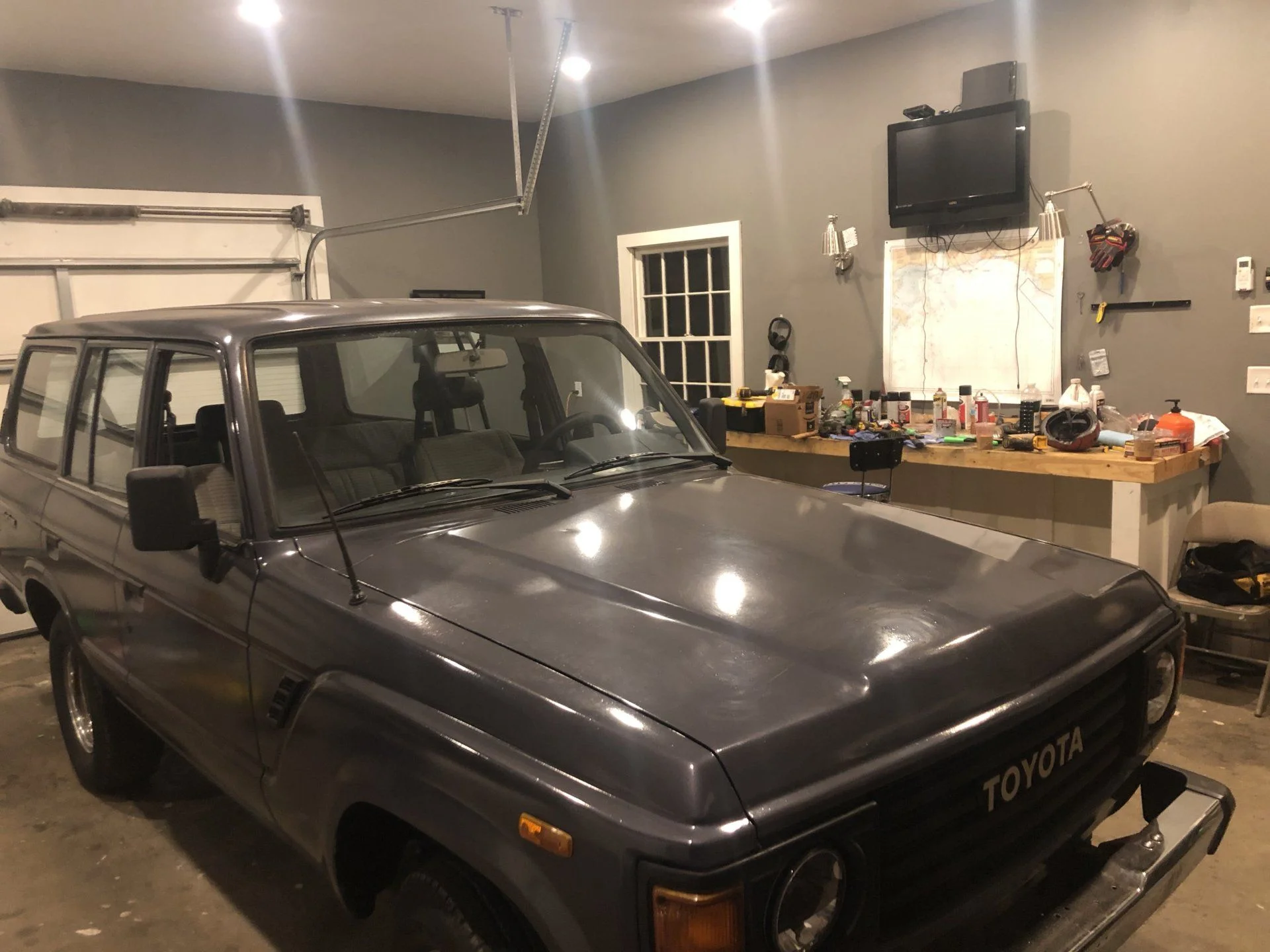

That’s the original color. Dark blue metallic (8B4 is the code) I got the paint at a local auto paint supply store, cost about 500. I wanted to change colors, the wife wanted to keep it the same, so we compromised and kept it the same.
