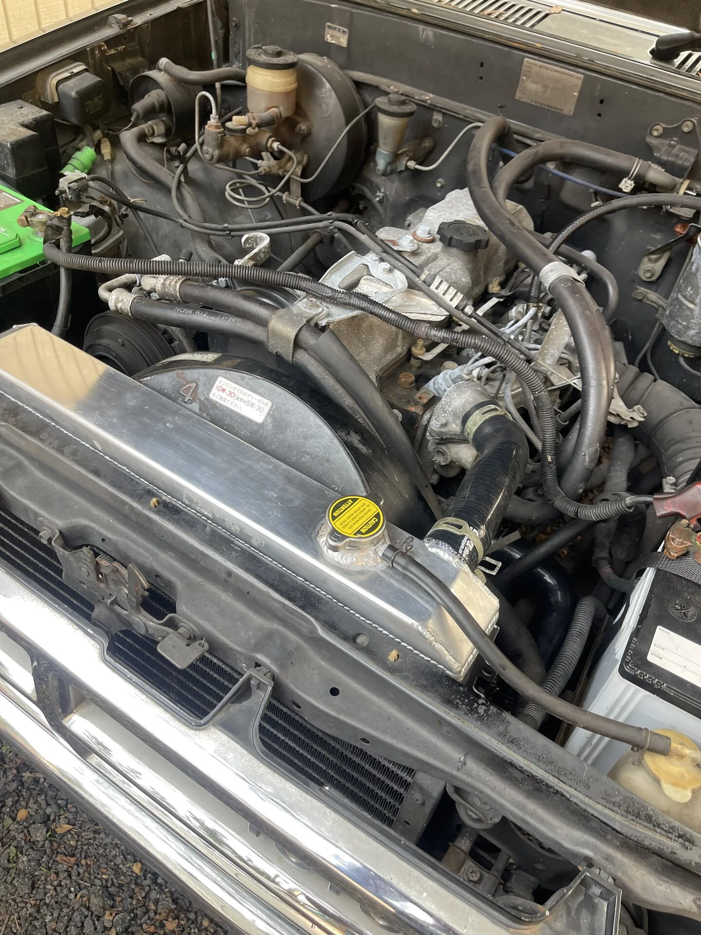

What kind of motor oil? I know it’s 10w 30 but I’m assuming because of its year it can take conventional oil? Should I put synthetic or a blend instead? Thank you!

that is the crustiest radiator i think ive seen! oil type is probably the least of your immediate issues!
