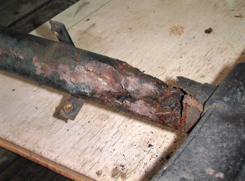

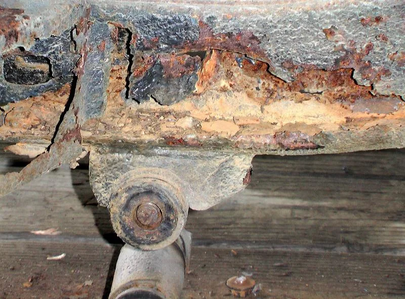

I have done what you are contemplating. The frame is probably gone from rust. If the back frame was bad enough to need rebuilding it is a good bet the rest of the frame is rusted from the inside out.
If you purchase it and you do a frame off purchase a new frame (new to your rig) get a good one from a 70 or a 74 which can be shortened to fit, Sheldon at G&S cruiser had or my still have 1 from a 70 and 1 from a 74, have it galvanized.
If the rig is missing small parts and needs alot of misc stuff with a bad frame the price is to high.
Contact me at jake2far@hotmail.com and I can send you pics and info about what you are getting into.
Good luck.
Jim
