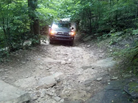

Second one in I think captured the moment of doom for the front Birf at the bottom of 4.
I did get a few good ones of the rig in action.
Yes I believe that was the death of the birf. And, yes, you did get some good shots. I'm finding out more and more that I should just hand off the camera to someone and see what I end up with.

Sorry, I forgot the proof. Sorry only got the one cause I was trying to make sure he kept his co-pilot in his good graces.
