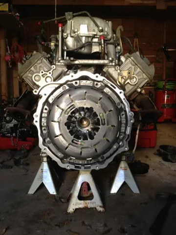

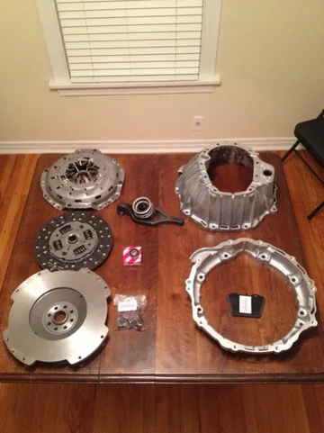

While waiting for the tranny, I contacted a Toyota dealer in Sydney and ordered the UZJ100 clutch and bellhousing parts for the conversion. Side note: I will never go this route again! At the time I was unaware that Cruiser Parts could order ANY toyota part at a greatly discounted price. I grossly overpaid. On a positive note, the parts arrived in about 4 weeks. Here is a pic of the flywheel, pilot bearing, 300mm clutch disc, pressure plate, release fork and bearing, and the two-piece bellhousing/clutch cover:

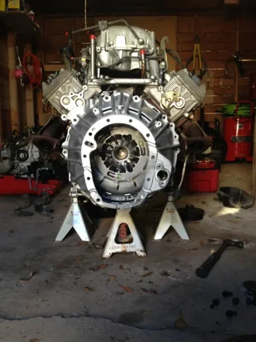

And a pic of the flywheel and clutch assembled to the engine:
With bellhousing:

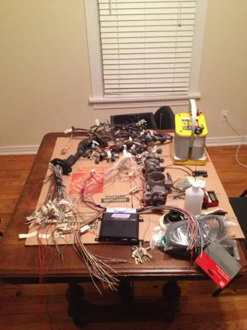

I also decided on running a standalone engine management computer. After much research, I went with the Adaptronic e1280s super ECU. This ecu will allow full sequential injection and ignition control at a much more agreeable price than the bigger names in the ecu market. It probably would have been possible just to try and run the stock Sequoia ECU and "fool" it into thinking that the auto tranny was in "Drive" all the time. But, rather than trying to deal with all that headache, I went standalone. Plus, who knows...turbos may be somewhere in the future!! Here is a pic of the e1280s wiring loom being spliced into the 2uz harness:

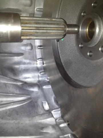

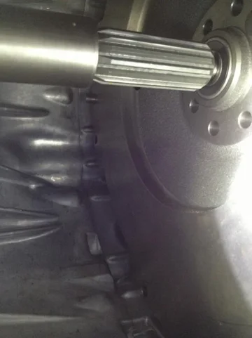

Once the transmission finally arrived, I wasted no time bolting everything up. I was immediately disappointed to find that the 1HDT input shaft on the H151f was about 60mm too short! Additionally, the front bearing cover tube was also too short to allow the release bearing sufficient travel during clutch disengagement.

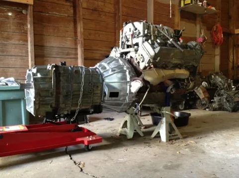

Bolted up to the bellhousing nicely:
Too short!

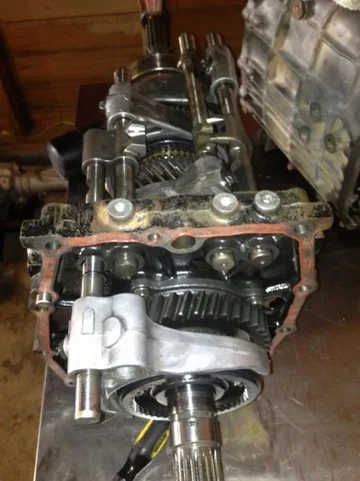

A quick call to Cruiser Parts with the p/n's for the UZJ100 input shaft and front bearing cover had the required parts shipped from Japan in 4 weeks time. While waiting, I began disassembling the gearbox to fit the UZJ input shaft.

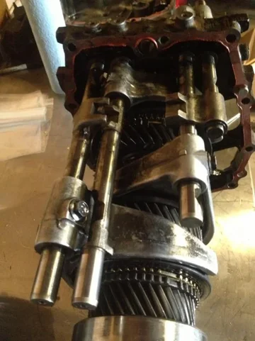

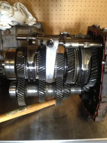

I didn't fully disassemble the transmission output shaft, but a visual inspection of the 1st and 2nd gear synchro ring teeth showed considerable wear. This gearbox was sourced from an 11/92 hdj80 which is before the synchros were updated by Toyota in 96. However, a full tranny rebuild was not in the budget just yet and the gears shift without any crunching...on the bench anyway. A road test will determine how long the rebuild can wait.

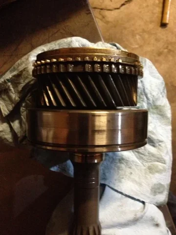

New UZJ100 input shaft (left) compared to HDJ80 shaft (right):
I wish that I had taken more pics of the uzj input shaft to show the slight differences of the dog ring. The teeth on the uzj dog ring are slightly wider and lack the small recesses between the teeth that the hdj shaft has. The differences can kind of be seen in the pic above. However, the clearance between the synchro ring back and front of dog ring are within the hdj FSM specification. The hub sleeve also engages the input dog ring smoothly when the tranny is shifted into 4th, so I think it'll be OK. Road test will verify.

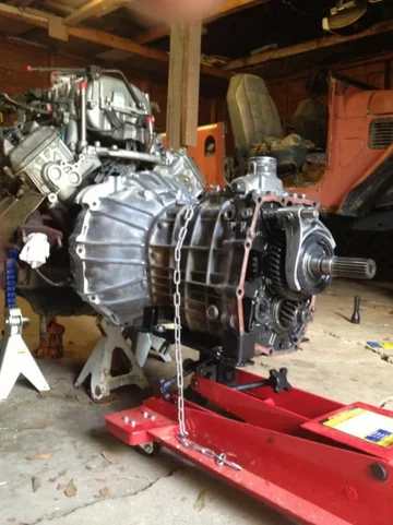

Think I heard the engine moan when I finally bolted the tranny back up ;)
