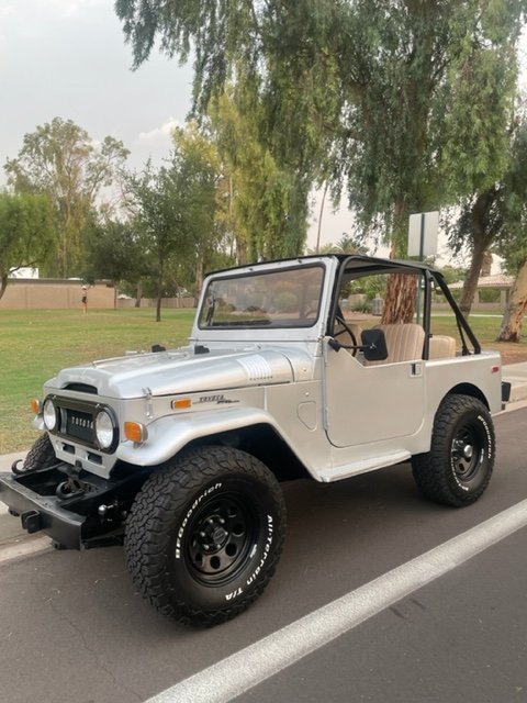

Hey all - New to this forum and a new 1970 FJ40 owner out of AZ!
I posted an intro to the AZ clubhouse forum, but figured I would post here too.. Currently in search of a trusted mechanic in the Scottsdale/Phoenix area and couldn't seem to find a more recent thread about it (could be that I'm just a noobie). Any recommendations would be greatly appreciated!
