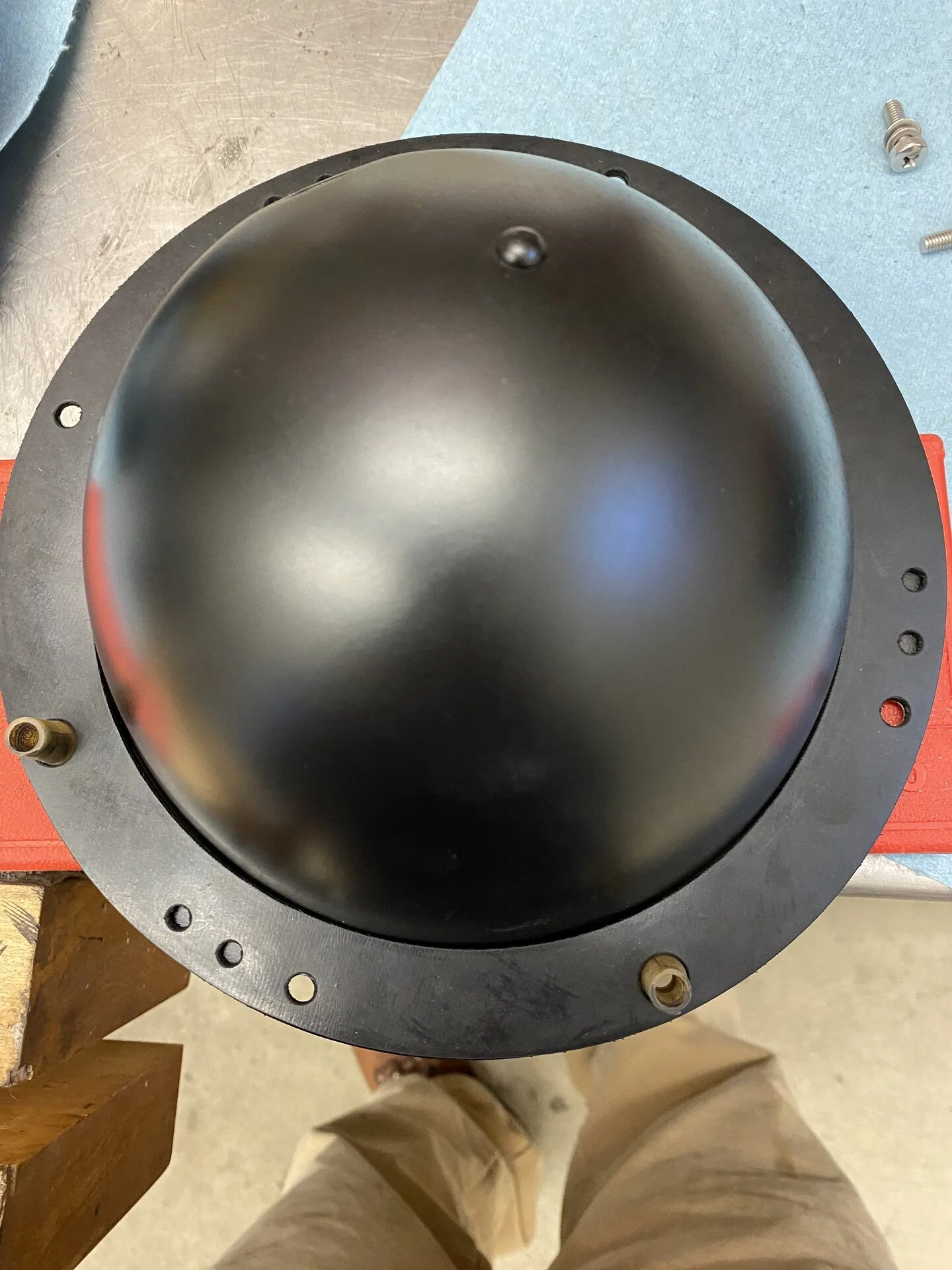

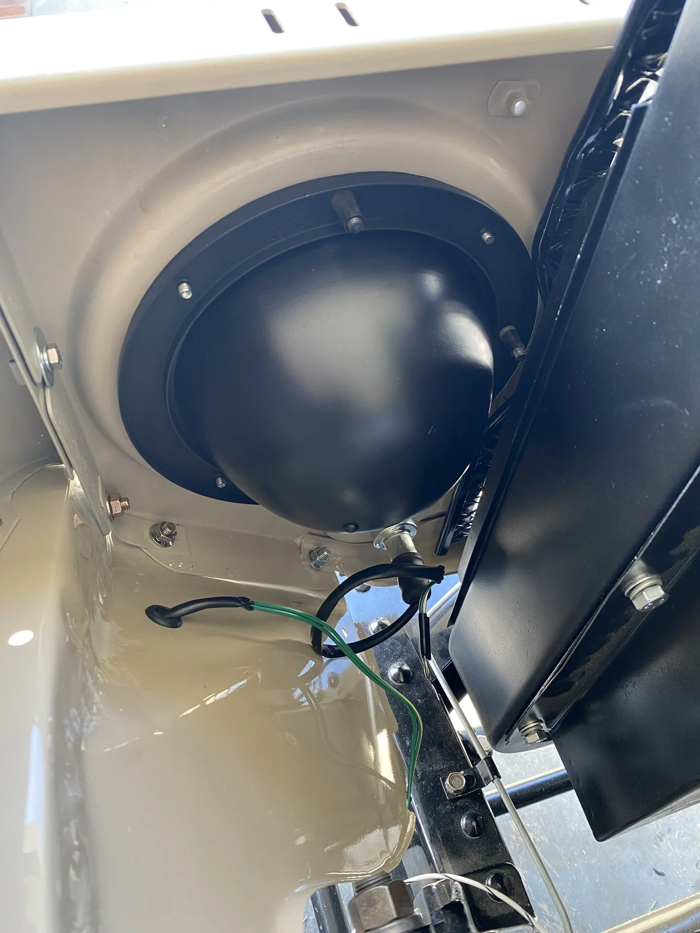

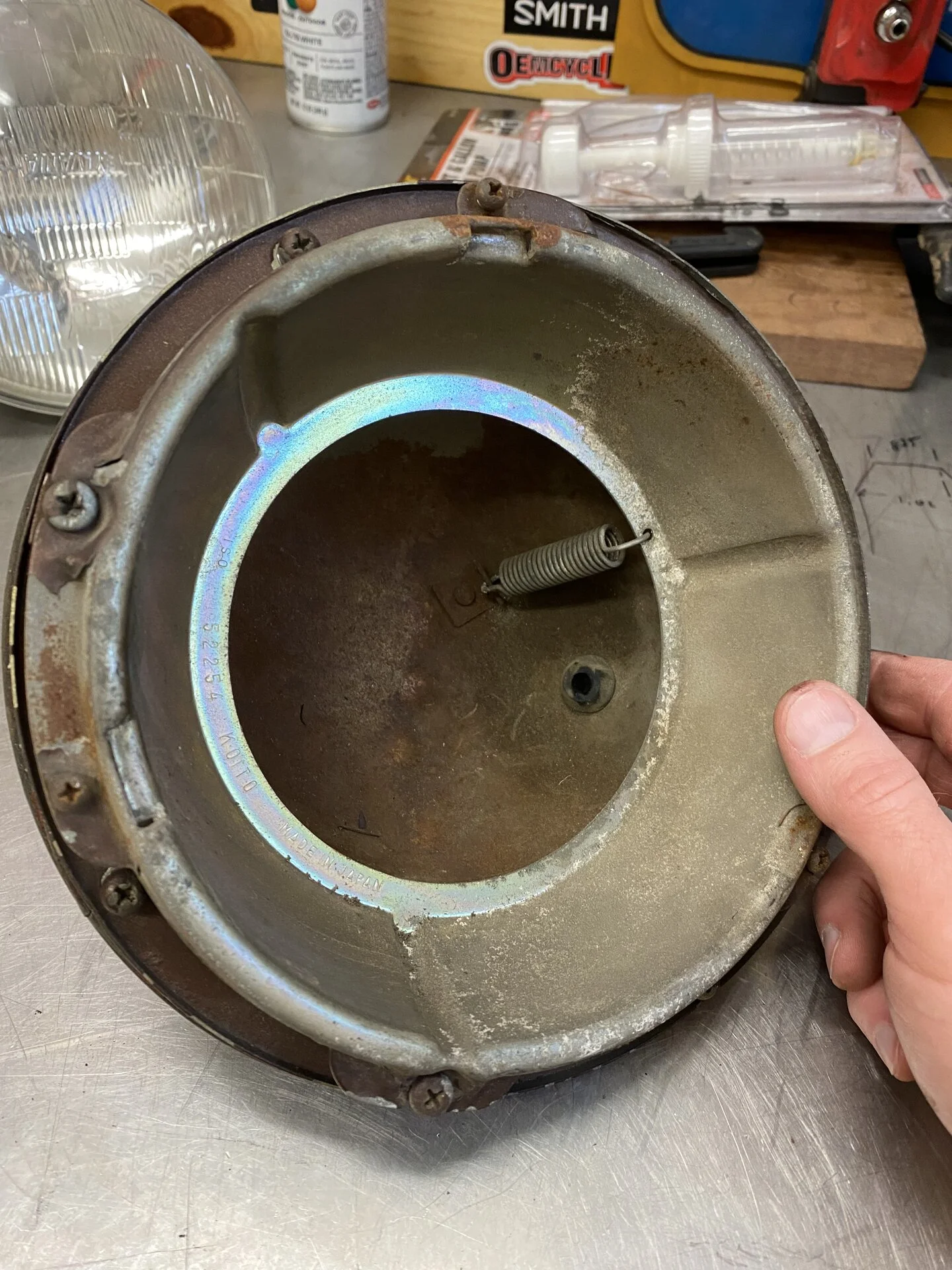

Chipping away one thing at a time. Got the headlight assemblies cleaned up and installed- I always hate removing the plating when I don’t have to but with rust you have to get rid of it. Sandblasted these and painted; I guess they don’t look too bad. Replaced the gasket and put in some new hardware

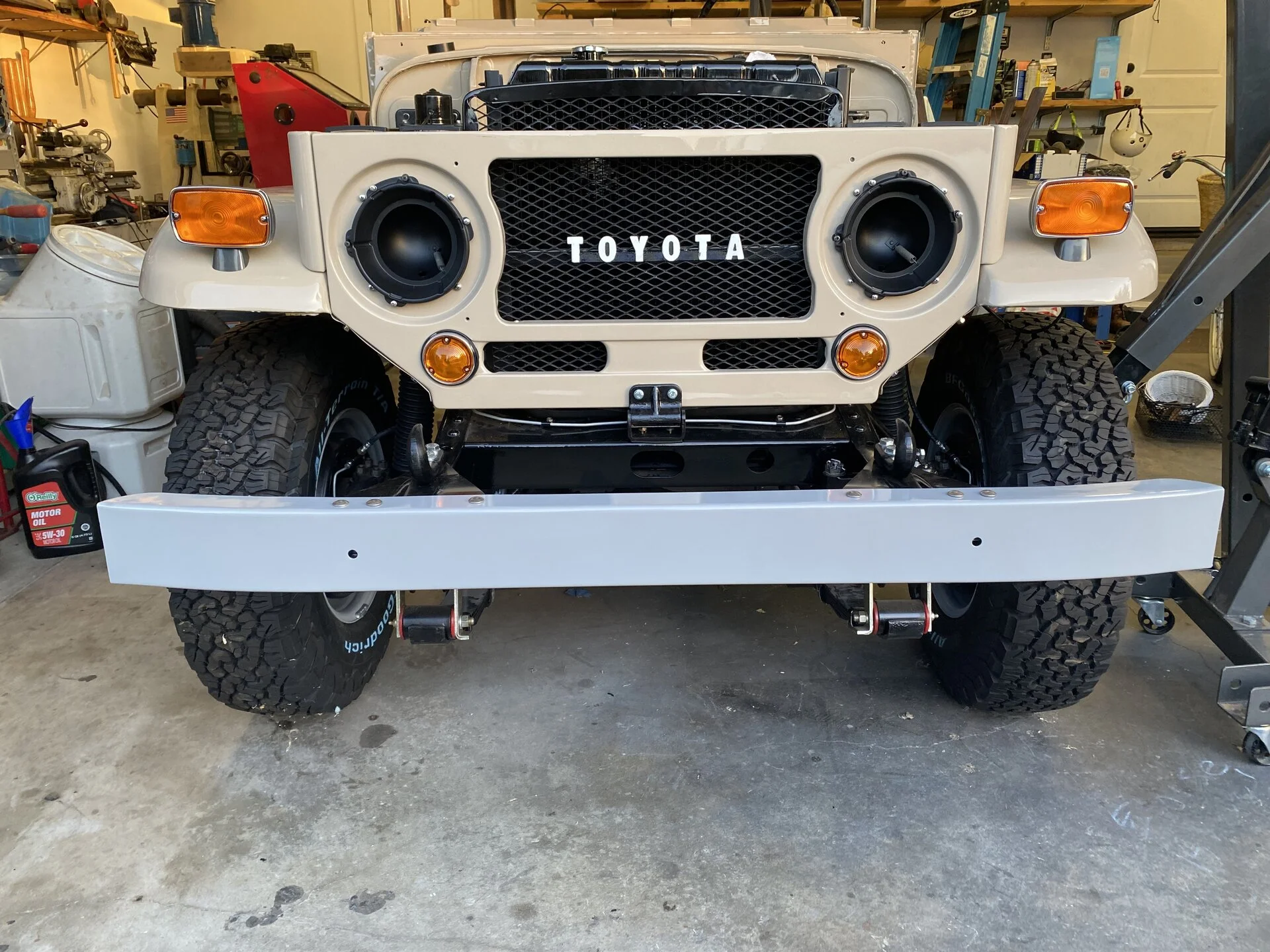

Took a break from focusing on the electrical yesterday and installed my front bumper. This is probably the first piece I bought for the truck, back when the Bakersfield rally was at the Toyota dealer. I knew nothing about what I was getting into except that I needed a bumper. Haha.
I had it powdered coated a while ago when I had my wheels done. I gave up finding the early style bumper gussets and used the readily available layer model wider ones.
I’m contemplating another location for the front license plate since the stock bracket seems to be just hanging out in the wind. Haven’t decided yet.

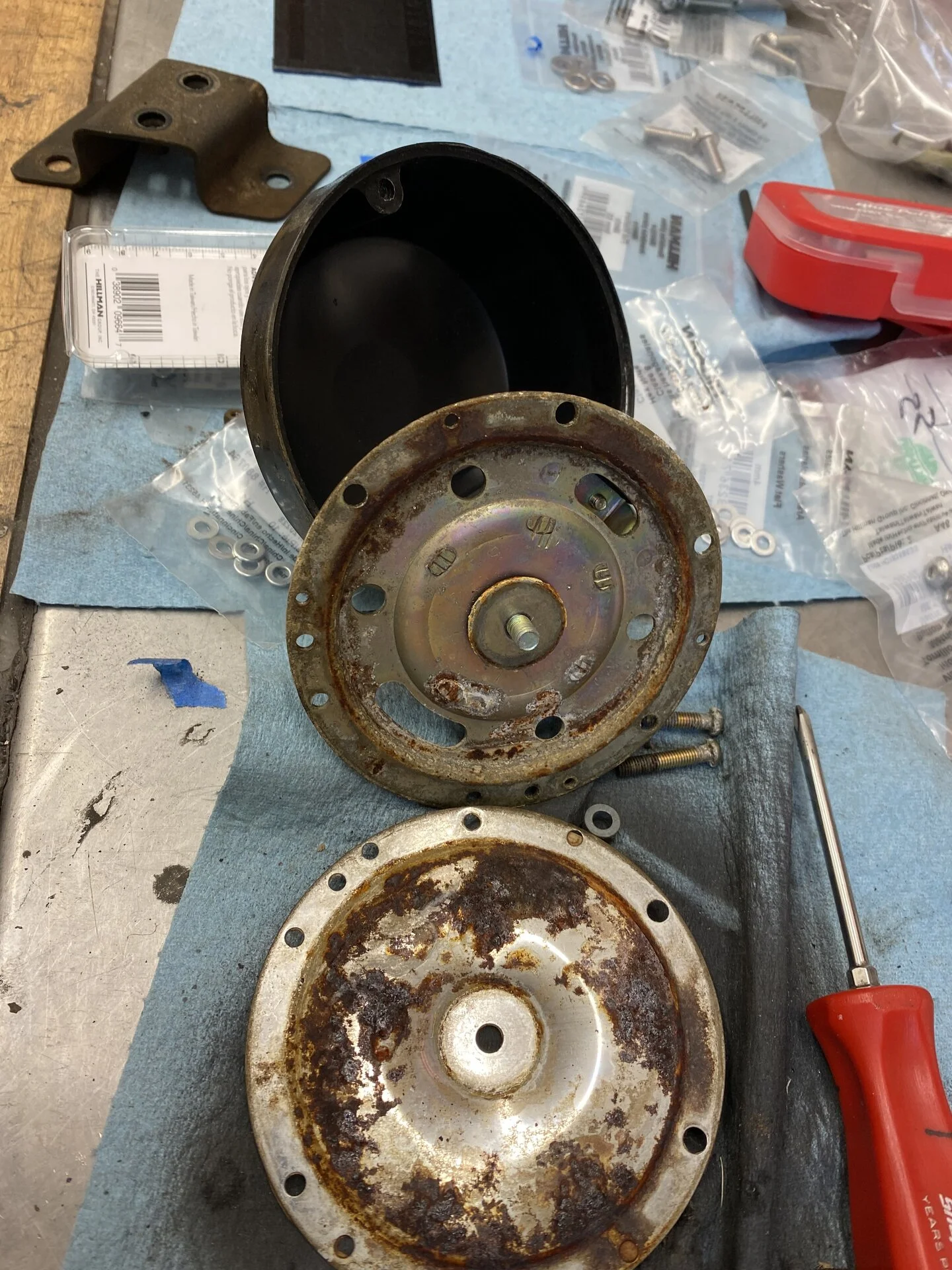

Back to electrical, I took apart my Low horn and cleaned up the rust (sorry don’t have a “final” picture).
Resealed the gasketed flanges with RTV and tested it out. Still works!
Looks like I only have the Low and not the High horn. Do any folks just run one?

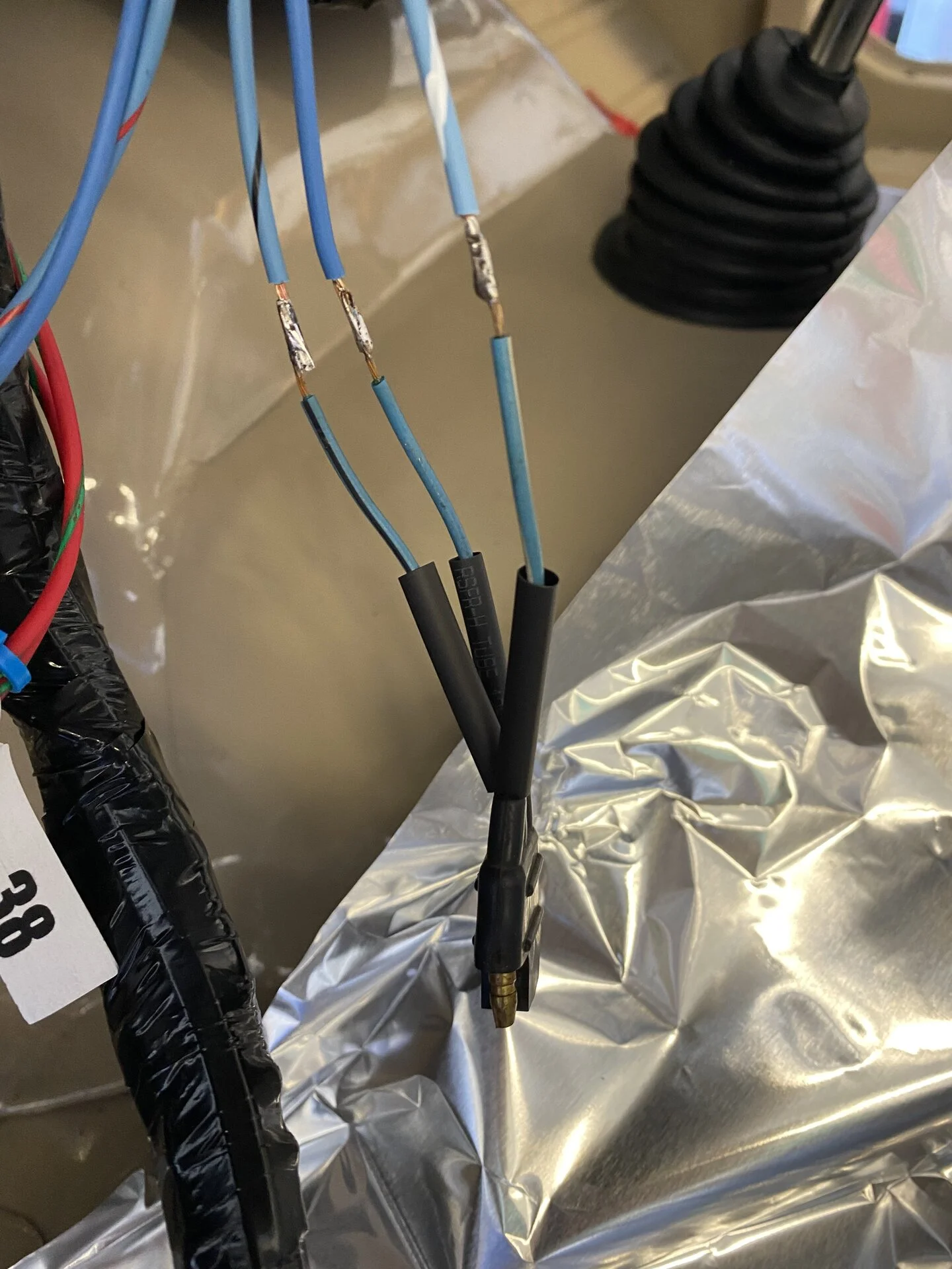

Got some subharnesses in the mail (thanks @Coolerman !)and got back to electrical work.

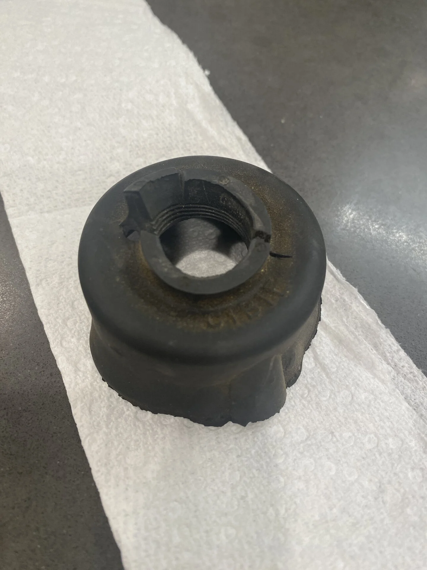

I’ve spent a surprisingly long time looking for a replacement headlight dust cover. Anyone know of a handy universal replacement for these? There are a lot of dust covers on Amazon, not sure if they’re for these 7” bulbs.
Any more modern Toyota using an H4 type halogen bulb should have a quality dust cover for you. The aftermarket stuff is often nasty.

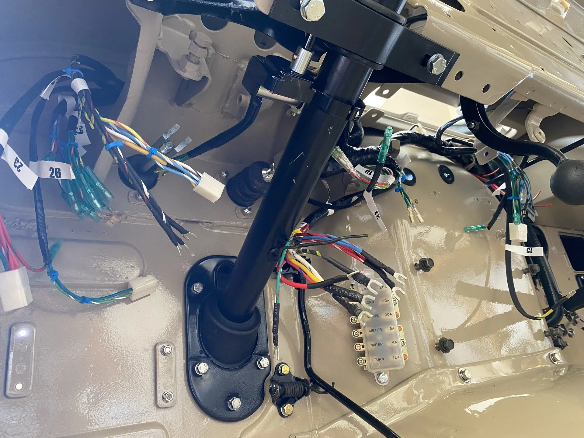

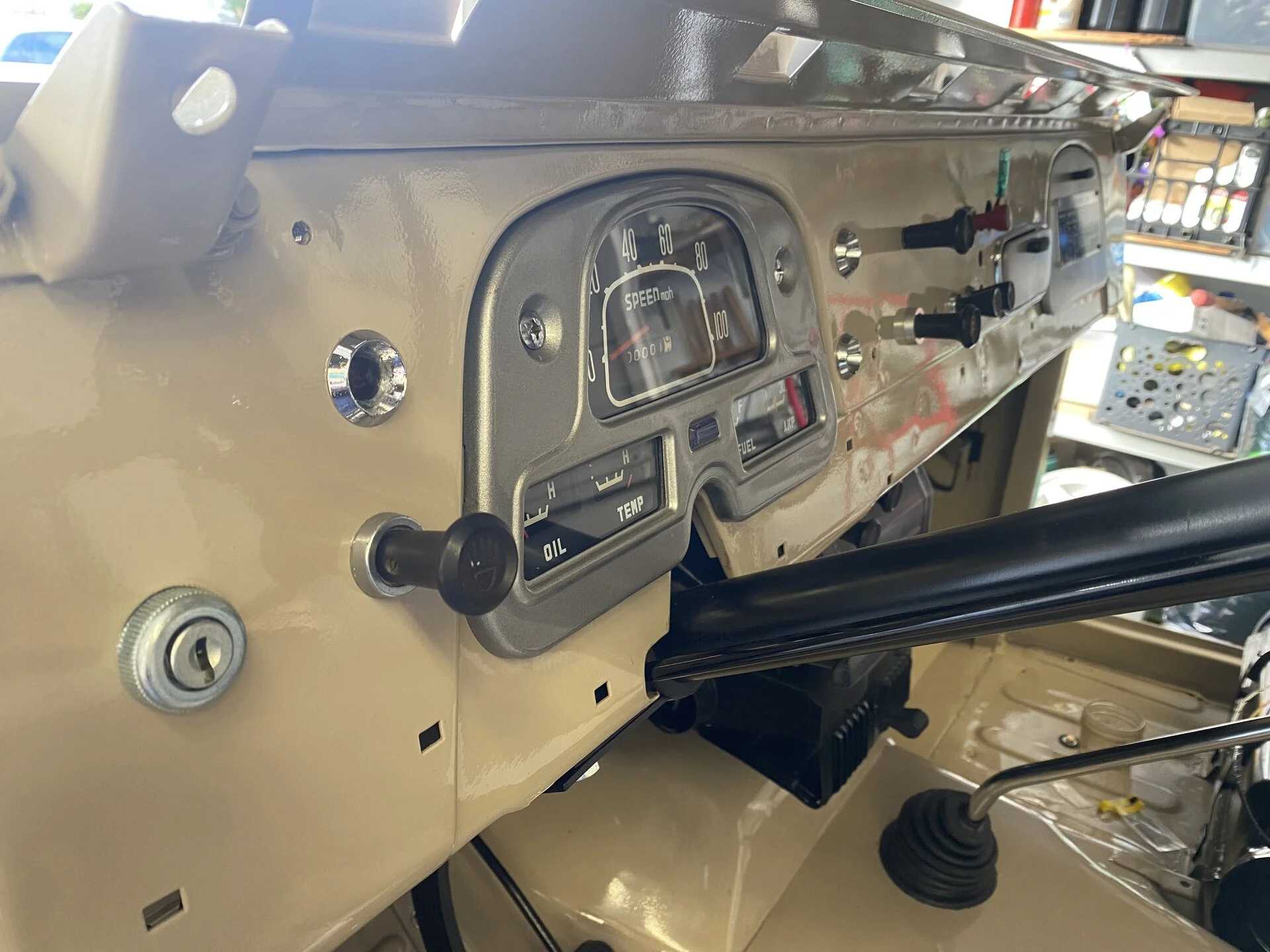

Been busy wrapping up wiring. I pretty much just have the rear end left then I’m close to being able to start it.
I’ve got a couple holes I forgot to fill in the dash but I may want to put some other stuff in there anyway.

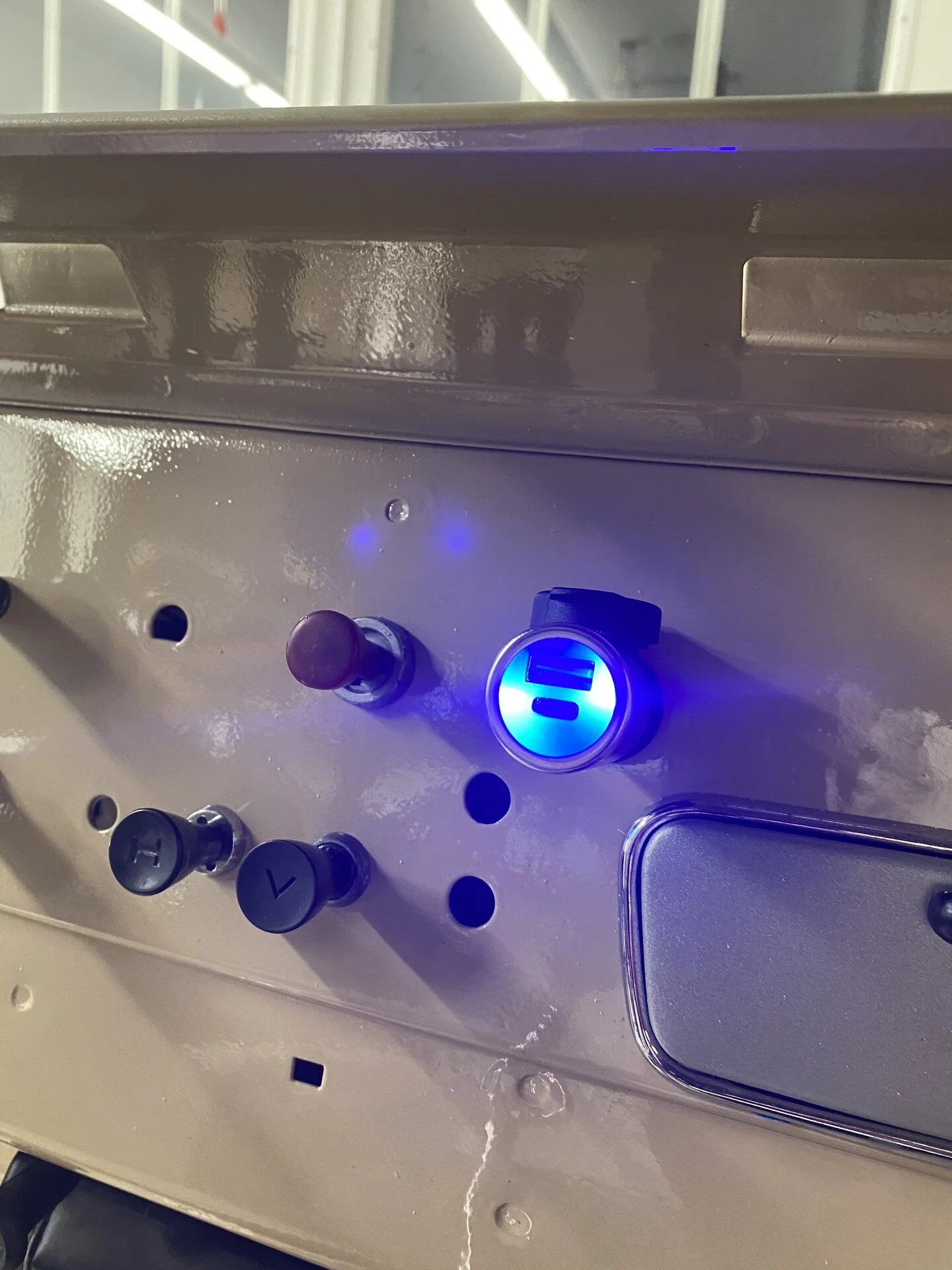

Speaking of that; has anyone doing a USB charger socket that fits in the cigarette lighter hole? They make tons of them but they all seem to big of a diameter. I think the hole is around 22 mm.
I ended up going with a DIN style socket. It seems stout. Can then plug in a DIN style charger
Cliff Top® 12-24v Universal Female Hella(Din) Socket (Alloy) https://www.amazon.com/dp/B00X3HU7S2?tag=ihco-20
(couple extra holes in the dash I didn’t fill; will have to put something there)

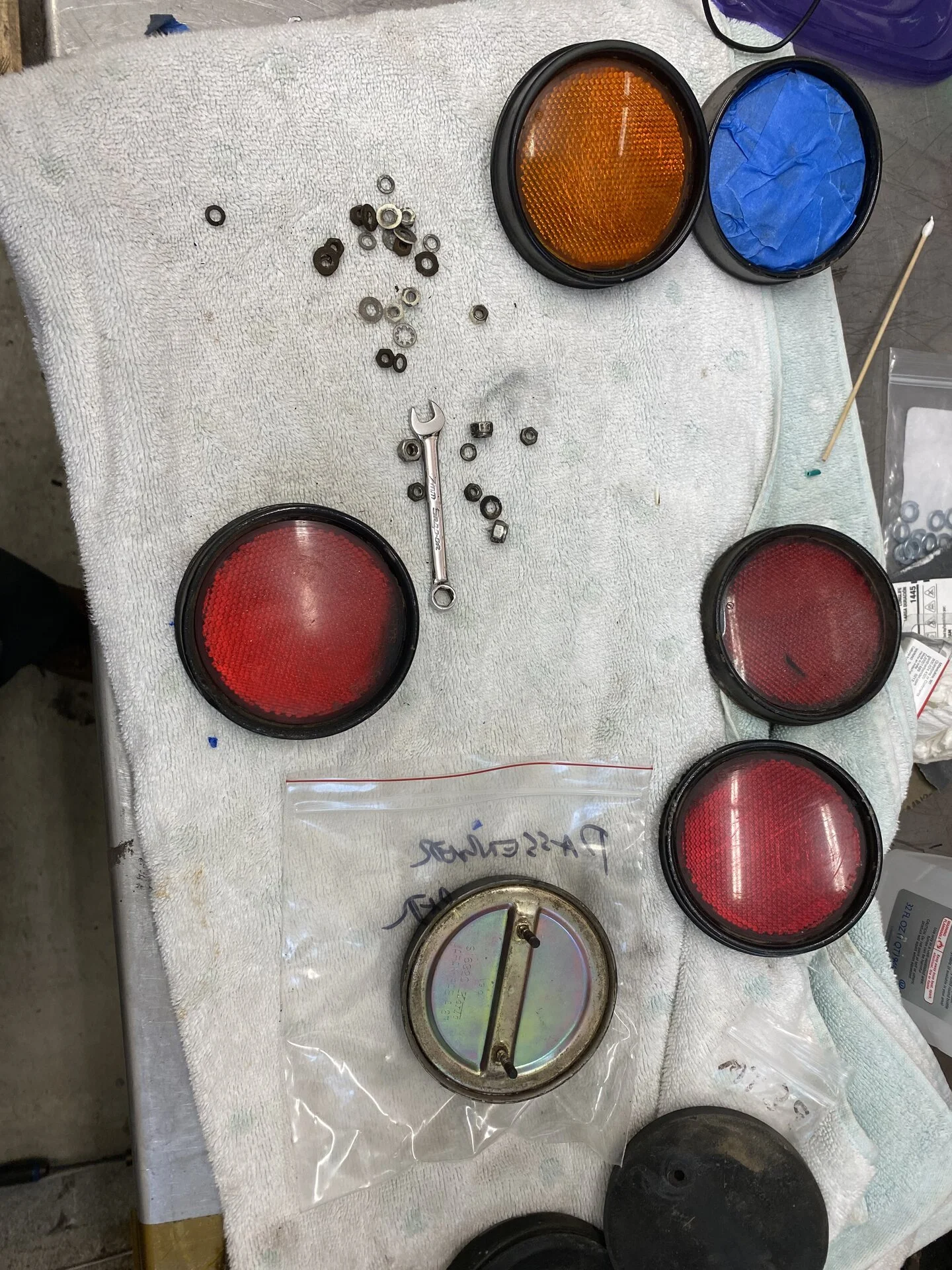

Also got to work on cleaning up the reflectors. Just going to paint the bezels and polish out the lenses. Luckily I have them all and the front gaskets are still good.

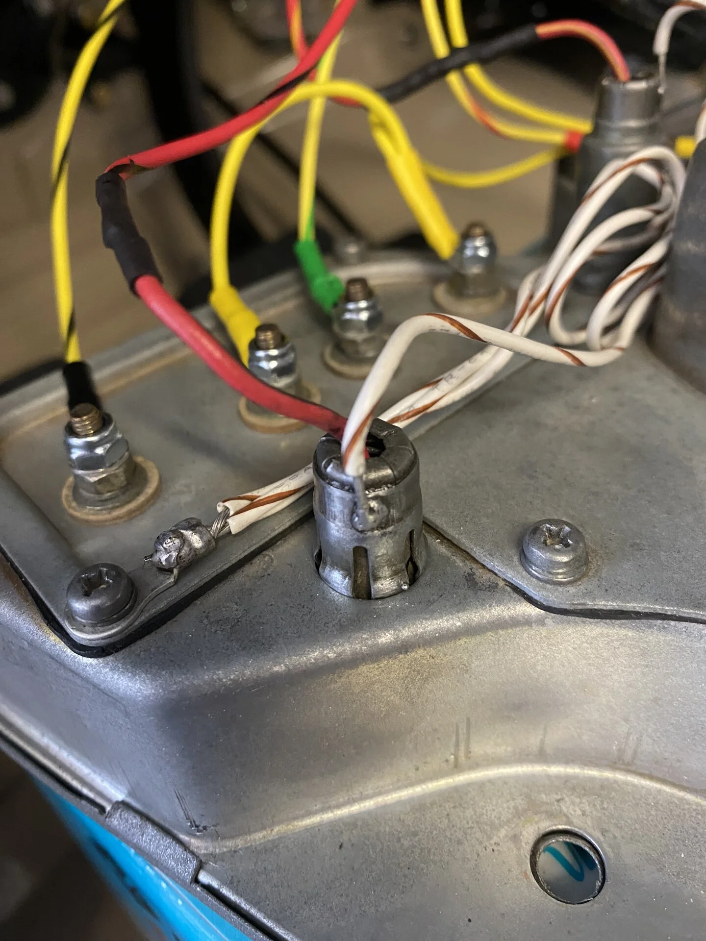

For the gauge cluster I was having trouble getting good grounds to the lights. I ended up soldering ground wires to each housing, which worked. Now I see that my high beam light is super hard to see through the blue cover…

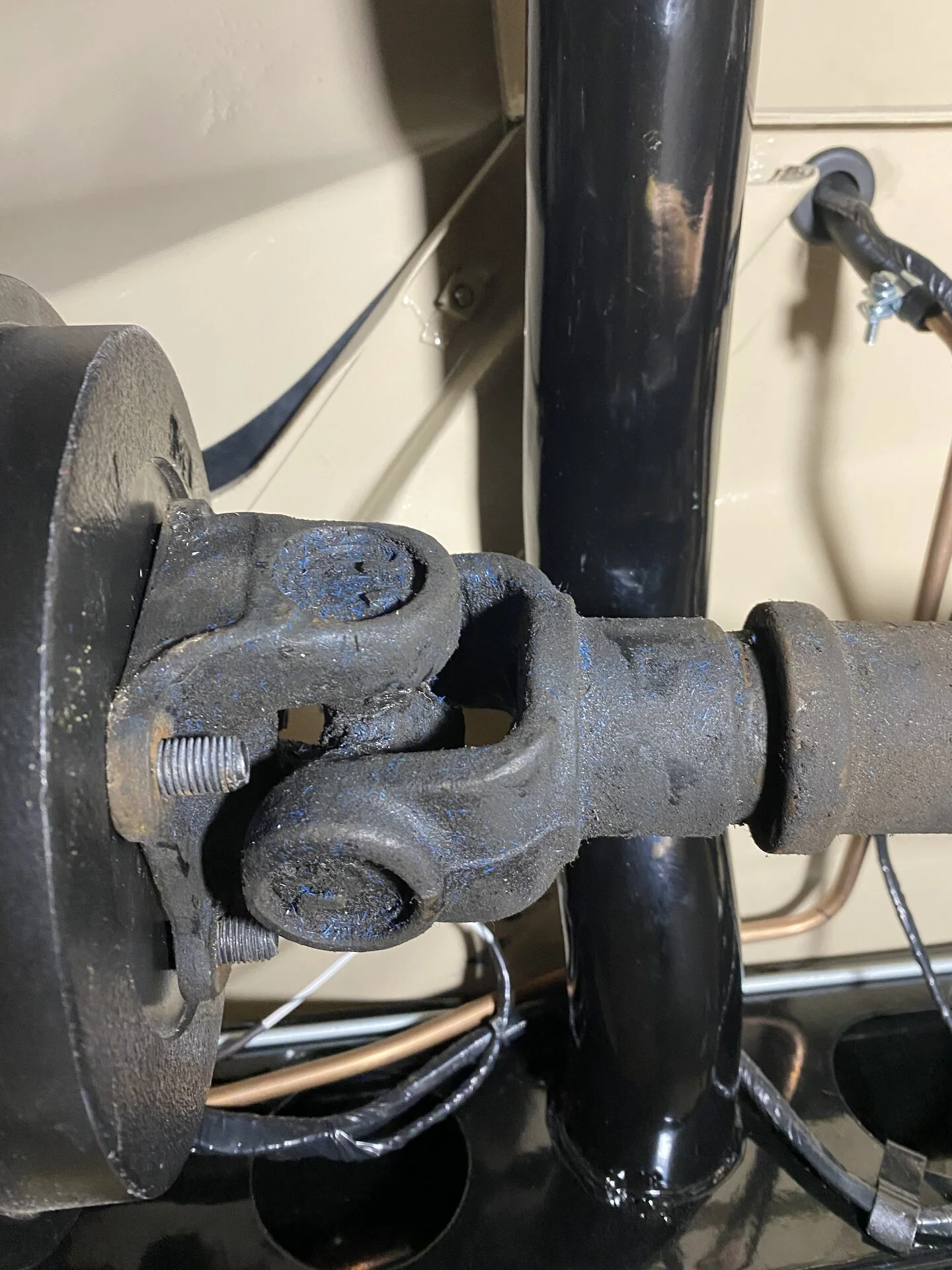

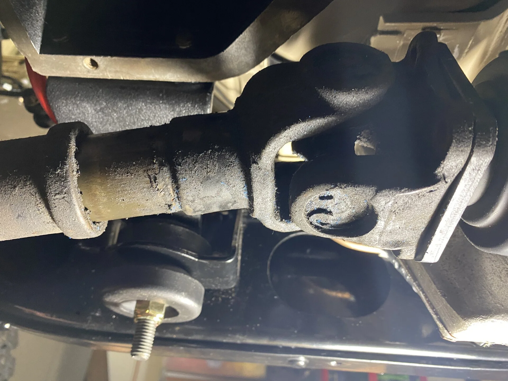

So Mark @65swb45 i forgot the truck had that overdrive unit in it when I bought it. So the rear driveshaft is a shorty.
When I fit up the front driveshaft, there’s about 1.5” spacing to being compressed (first picture). Too much?
the rear spacing measured about an inch shorter than the front. I fit up the front driveshaft in the rear and as expected was much more compressed, very little gap (second picture).
Looks like at the least I’ll need to source a rear.
