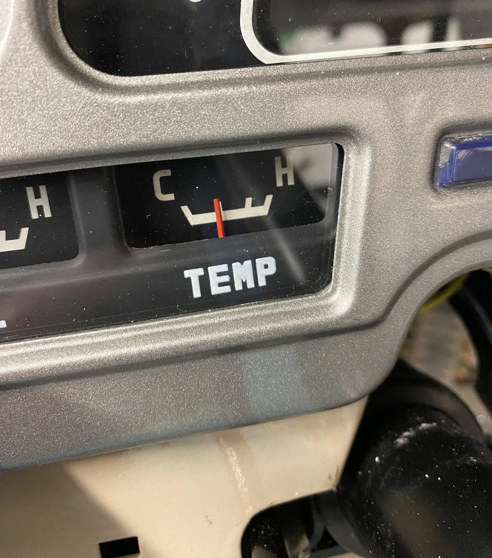

As far as your temp guage, where does the needle sit cold, key on?
Turn key on and no movement for 10 seconds, then it only gets to here with cold engine. Seems like a calibration issue? I can try adjusting it.
Yup. Needle should be on C when cold.

Now that I have a handle on my temp I’m good to let it run.

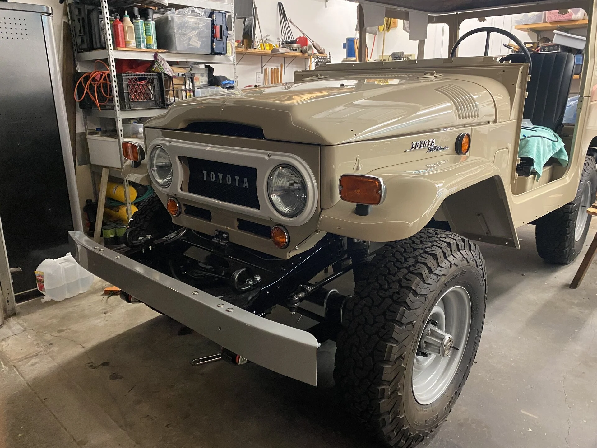

Weekend update:
I got the valves adjusted; warmed up the motor and checked them all before adjusting. Most were pretty tight, like exhaust closer to 0.009”than 0.014”.
I fired it back up but I’m still not tuned up correctly, so I decided to move on and save that for another day.

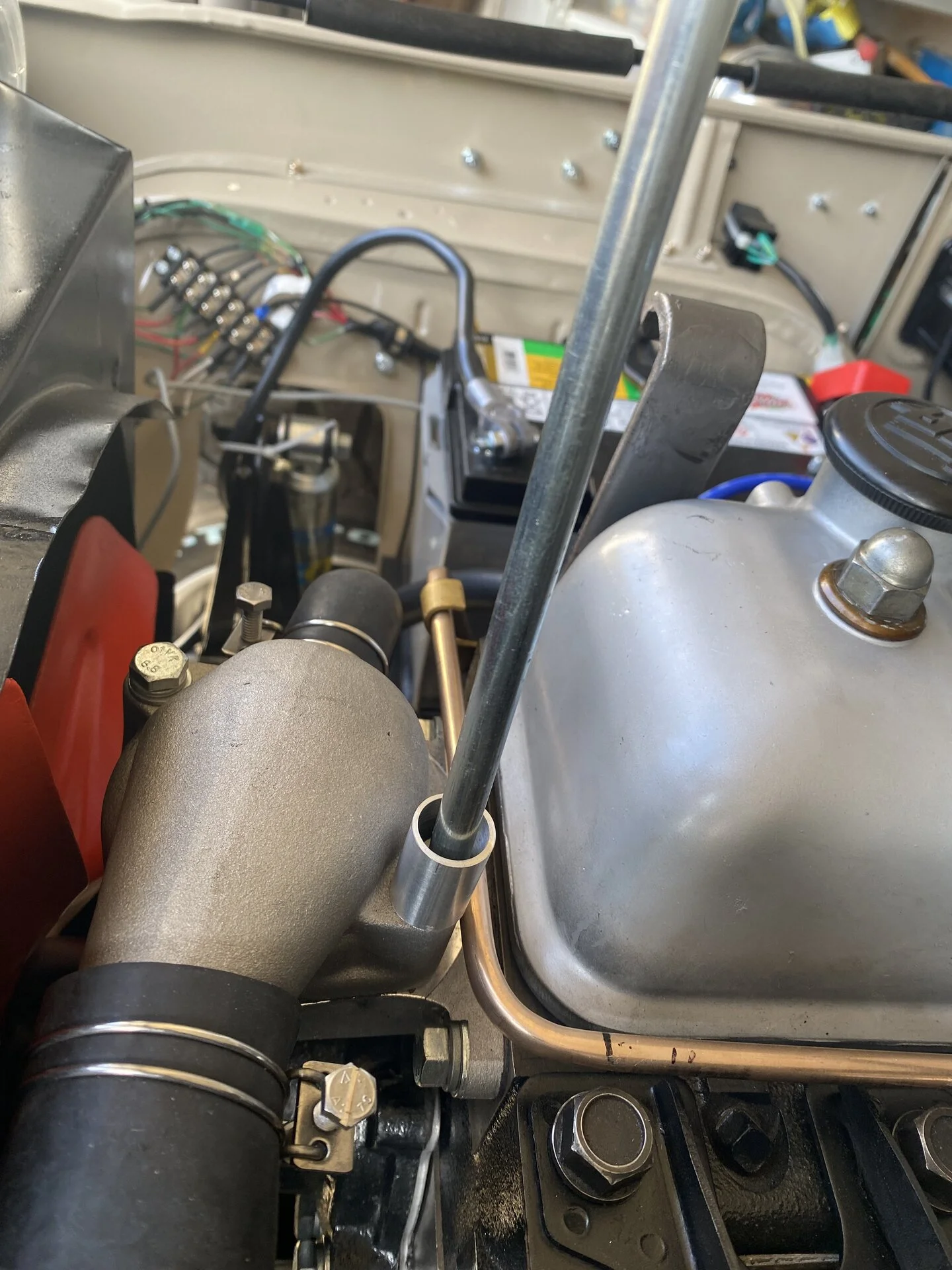

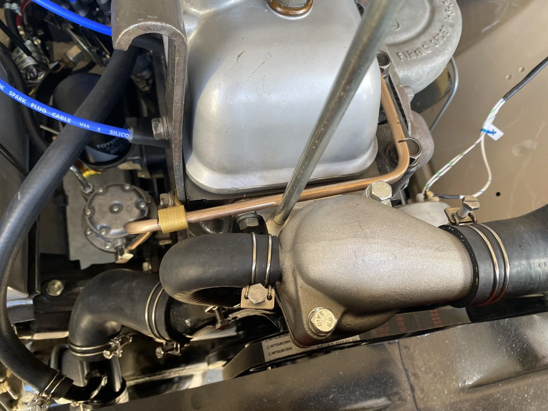

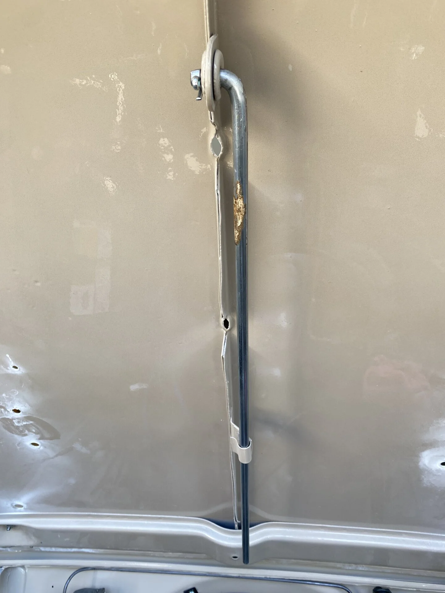

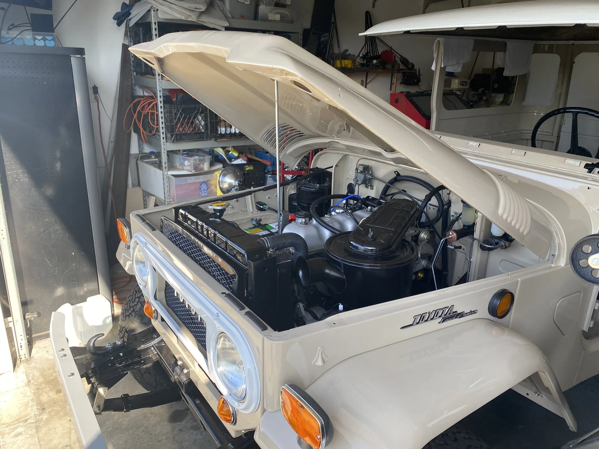

I got the hood on and made a support rod. By the way 3/8 rod is a good fit. I don’t have a good solution for landing place for it though. Maybe a bracket over the thermostat housing? Hood could line up better but I don’t have the energy to mess with it at the moment.
I got the brakes bled and found a few fittings that needed to be tightened. Hopefully that was the extent of it. Note to self, unhook the battery when working on the truck. I shorted from the positive cable in the started to a brake line…
Also got the clutch adjusted per the FSM so fingers crossed that works well.
Going to try out this support rod cup. Turned a piece of aluminum on the lathe and swapped out the thermostat housing bolt with a socket head cap screw, slightly longer to make up for the thickness.
I put it in the closer bolt to not have a big moment arm on the housing.
Also verified the tranny spins and front drive shaft all working. Very tempting to just take the top on and drove it around :)
Also got the air cleaner on and just need to find a hose clamp at the carb interface.

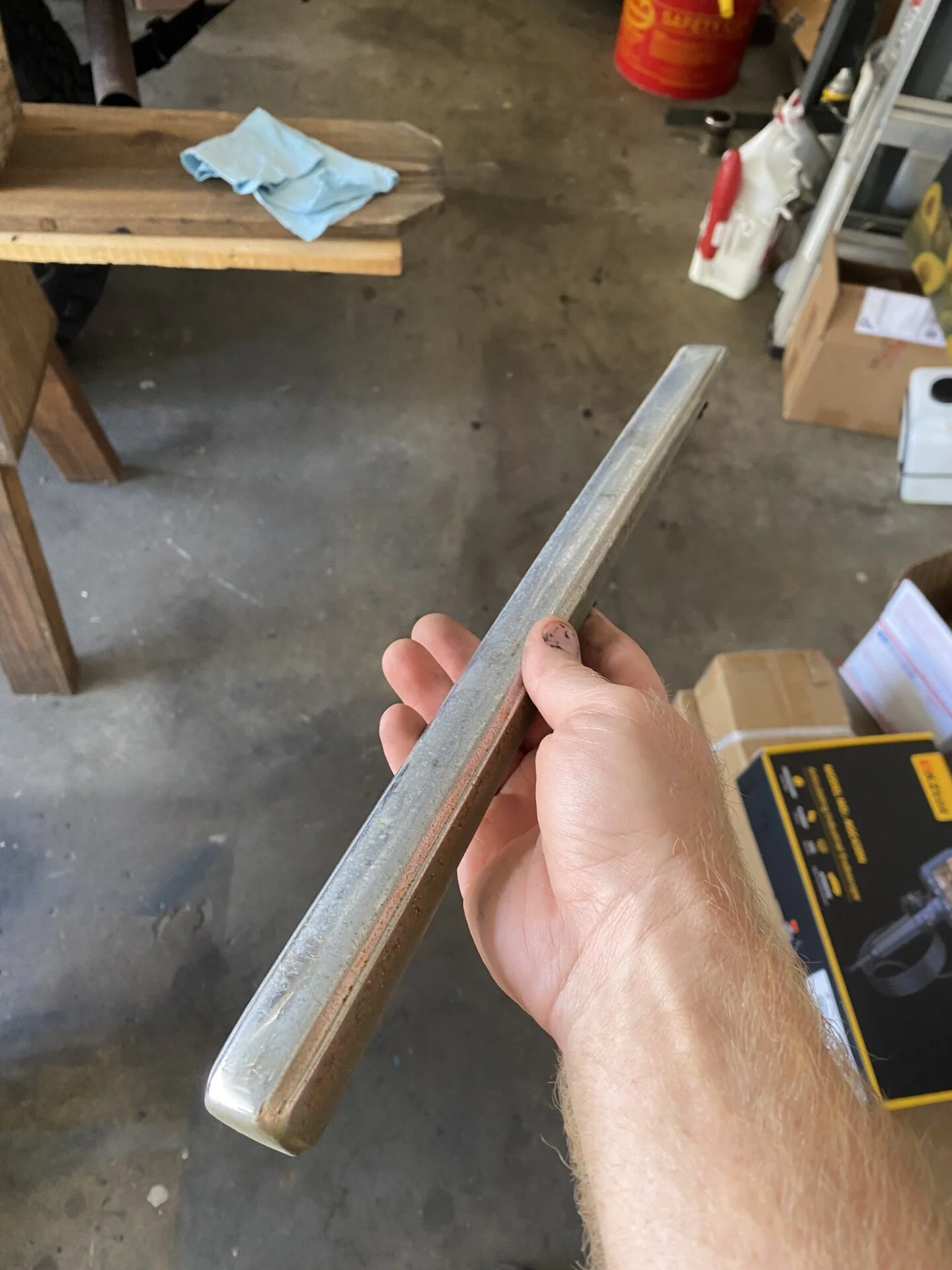

Also found the box of parts with hood and door hardware and it had my hood spear! It was good day - now I can take a few parts for chrome.

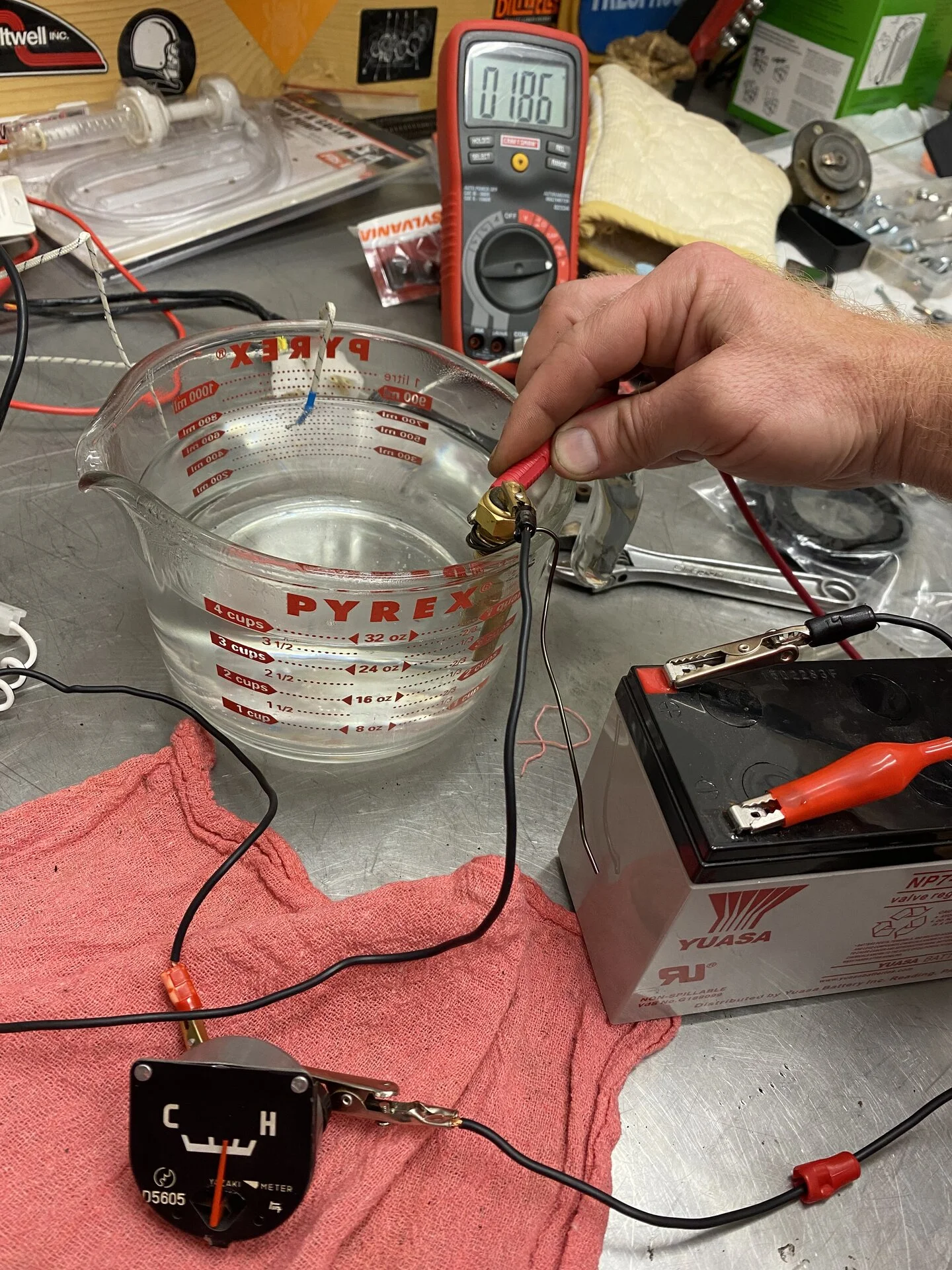

Catching up here with a couple odds and ends. I did some calibration of my temp and fuel gauges with senders on the bench. I think it worked pretty well; fuel gauge works now and haven’t tried the temp gauge yet in the truck.
Keeping the water at a constant temp in the Pyrex would be nice, maybe a hot plate.

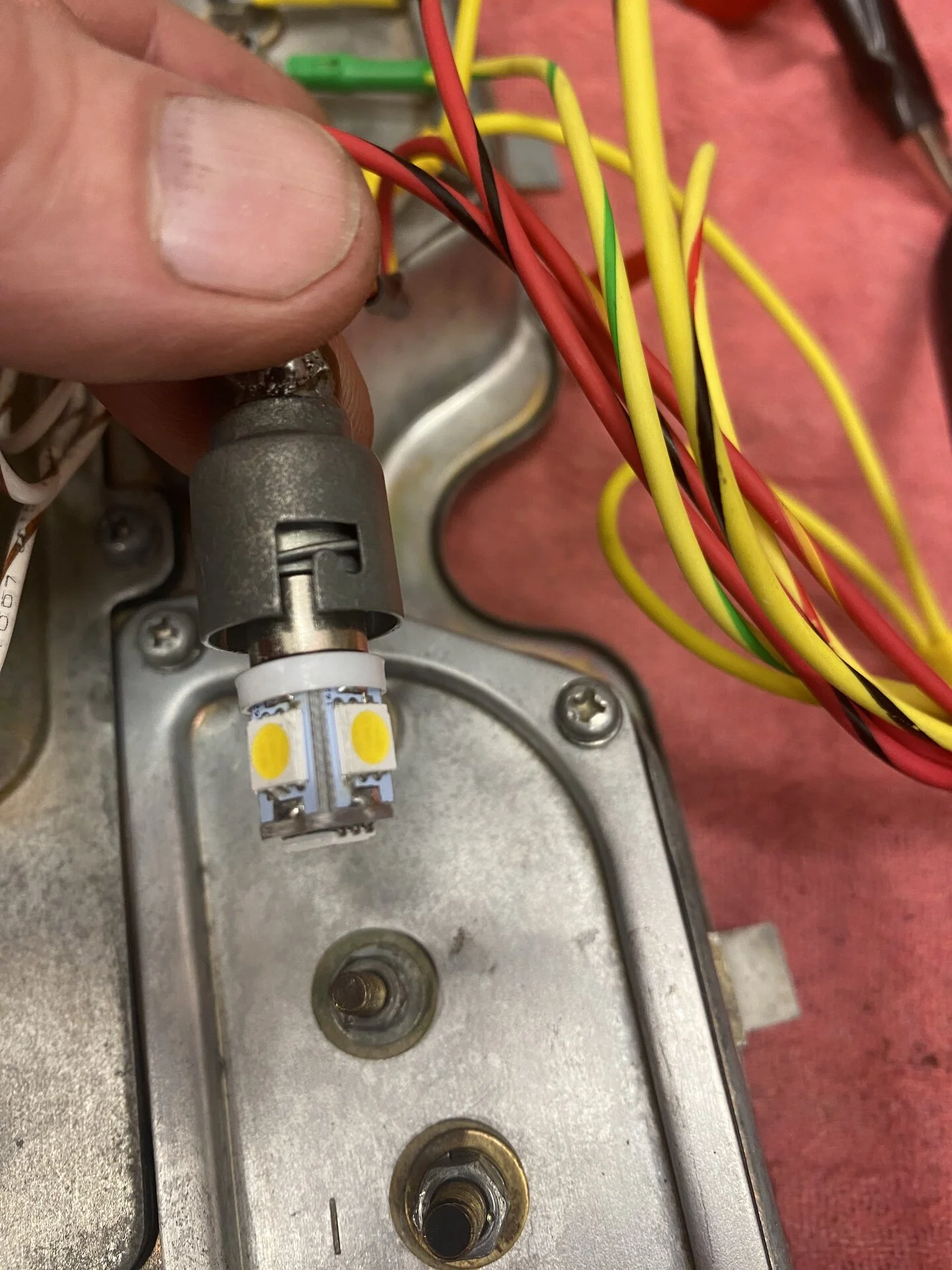

Also, the LED bulb from West Marine worked well for my high beam indicator. I can see through the lens now :)

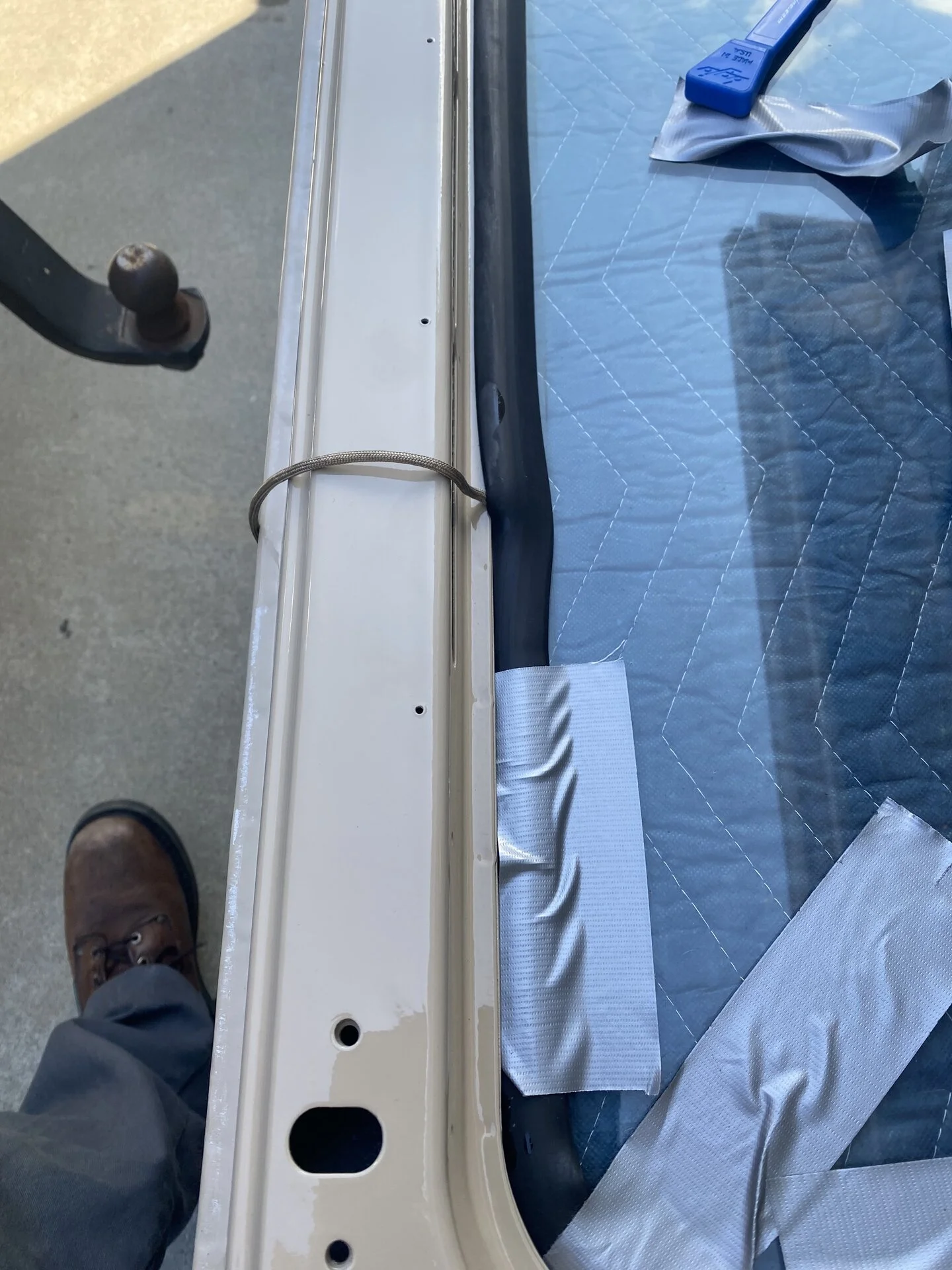

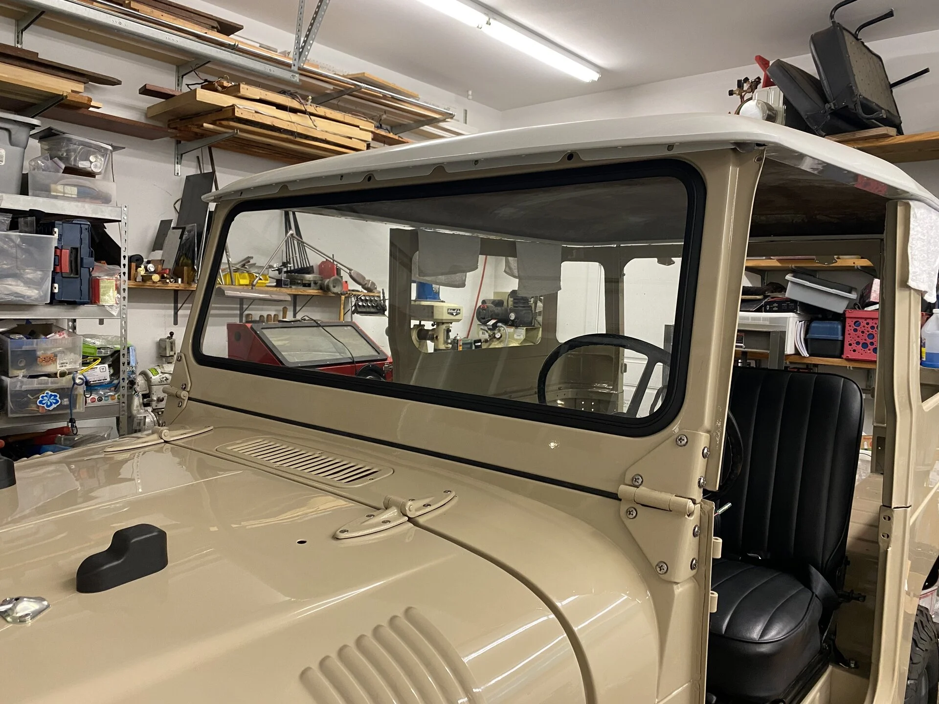

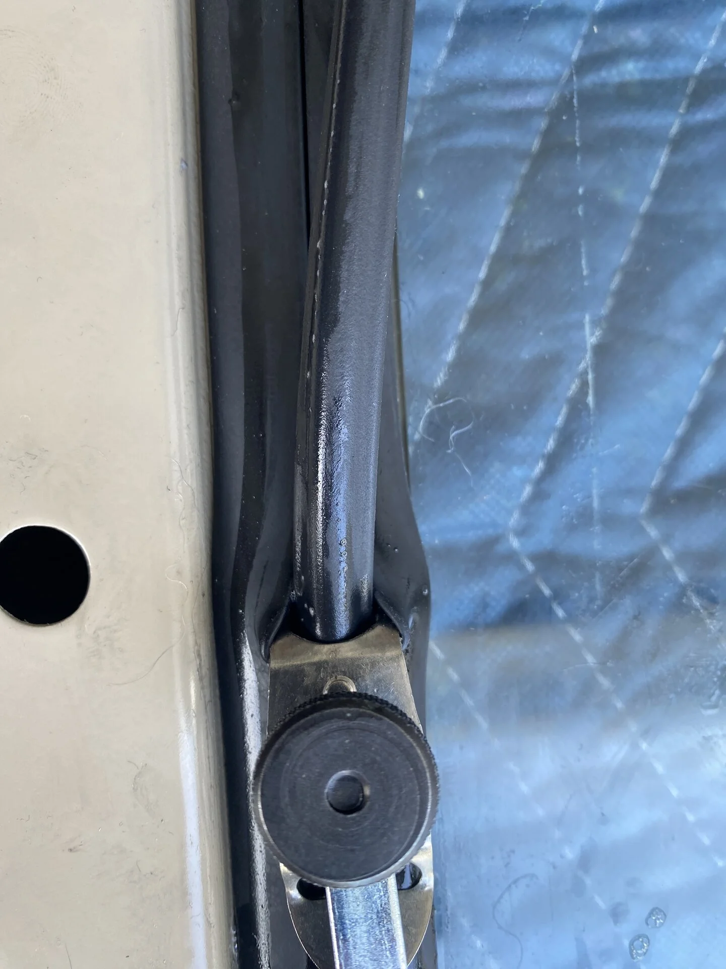

And today was the windshield. Man this tested my patience. I thought I was prepared but it took me hours…
The rope method worked well until the last 9 inches or so when I wasn’t paying attention and it pulled out. I eventually got it and now just waiting for the tool to put the lock cord in.
Churning along. Got the lock strip installed and I have to say that tool is fantastic.

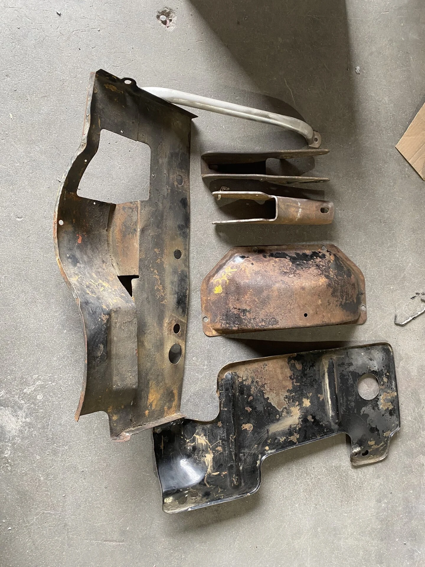

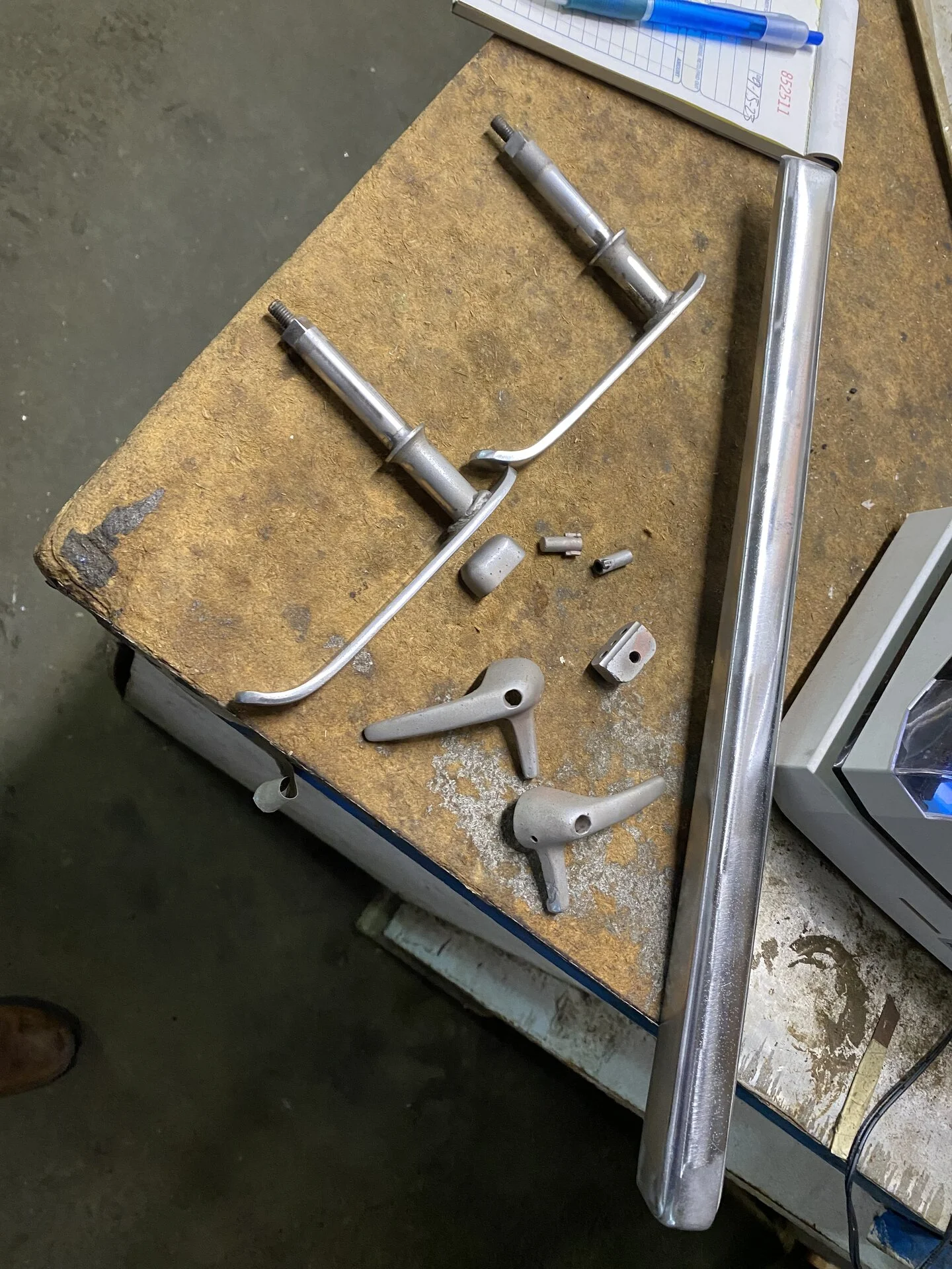

Dropped off the underside plates and some other items to be sandblasted and powder coated, and some parts to chrome.

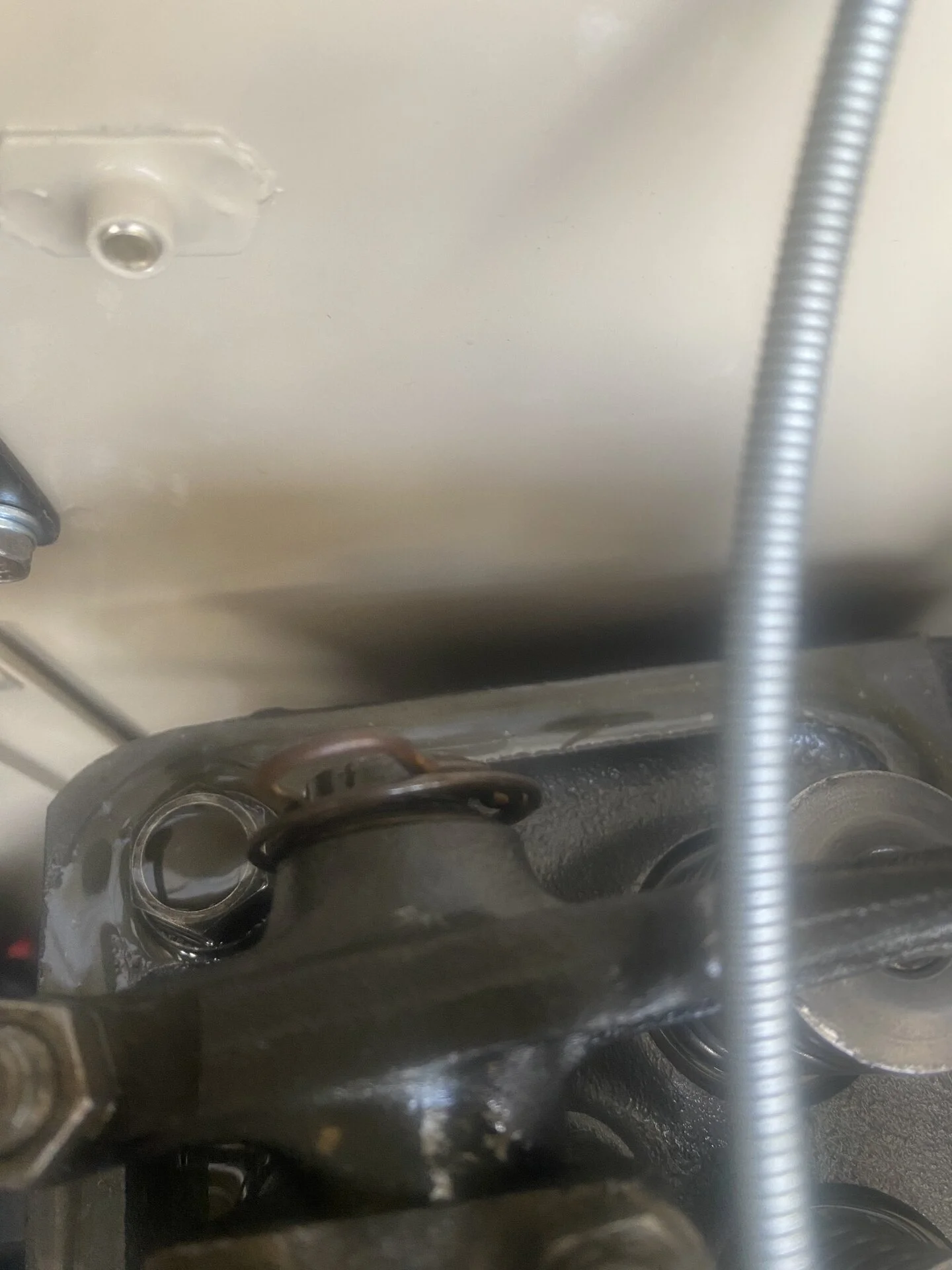

And long story short, when I was adjusting valves I noticed the last rocker had a lot of play and saw that there was no spring. I got that part from the outfit that did my engine and got it installed, but yikes, that wasn’t good.

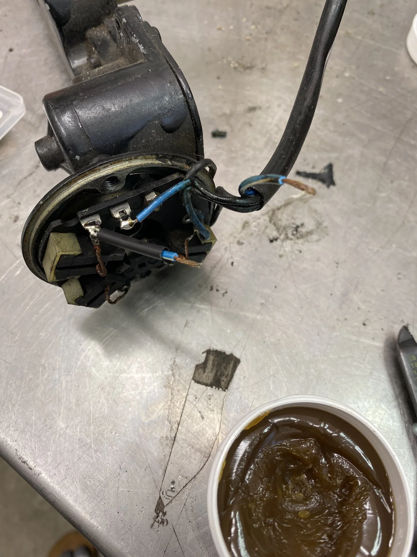

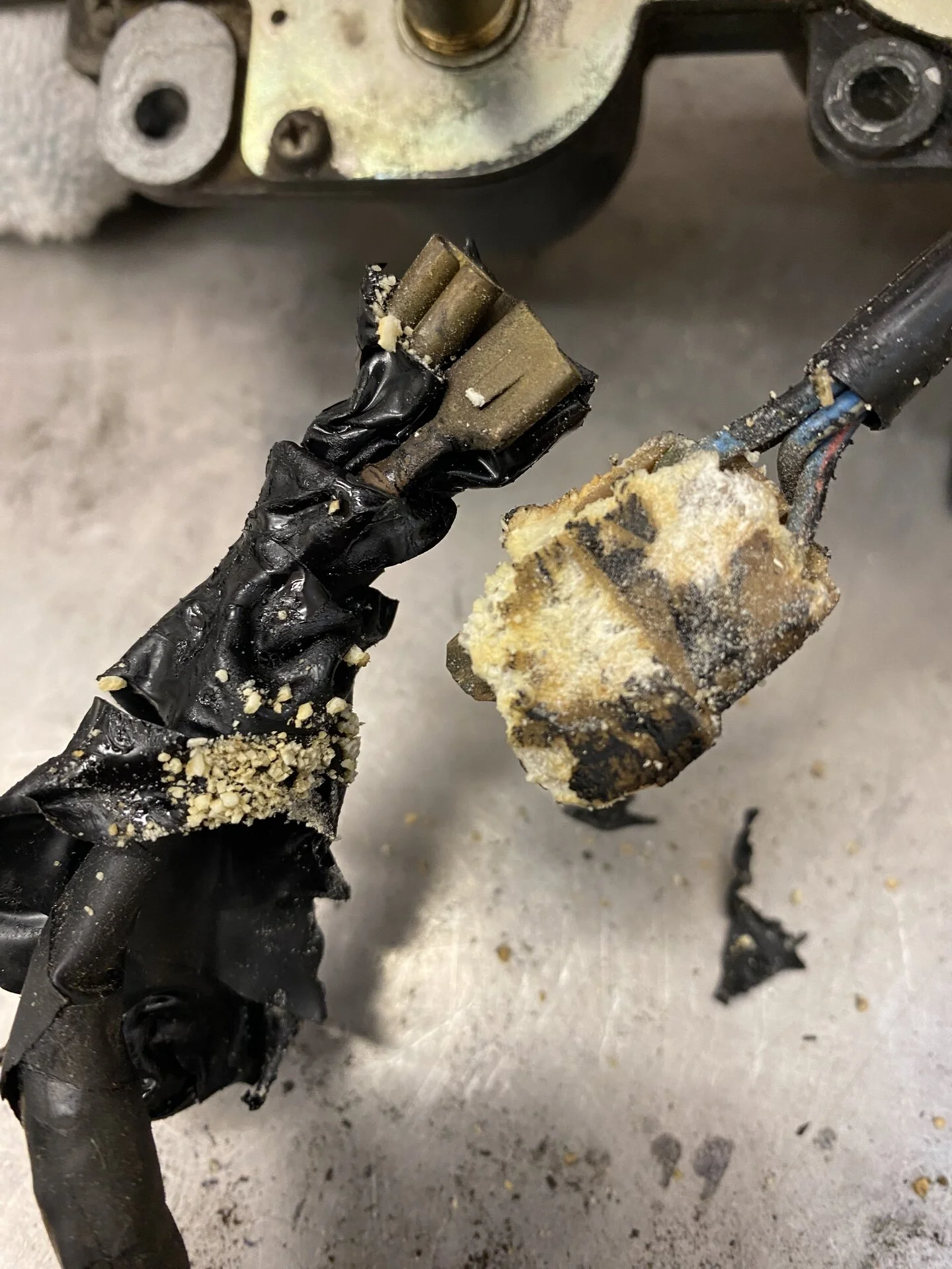

Next up is that crusty connector on my wiper motor.
