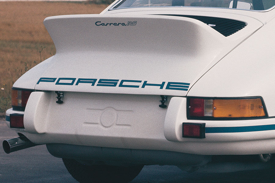

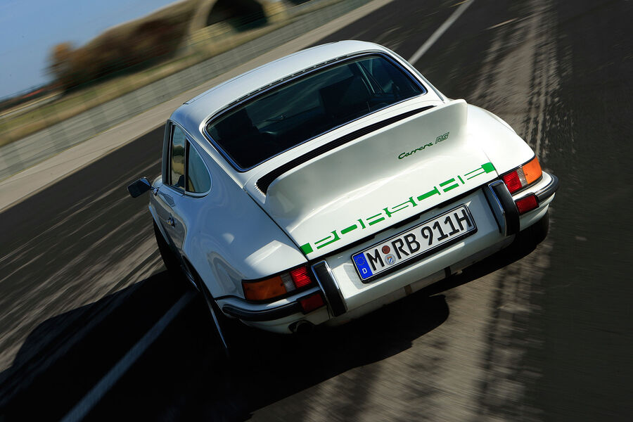

911 RS
Peter, this one is for you. I am already planning my next project. Yea, I know, but don't rain on my parade. Anyhow, this is off track, but, hey it is my thread so I am allowed. I will be building a 911 RS replica. This car is similar in theory to the Icon product built by J. Ward in that it is a re-creation of an icon with some modern updates. Any how enjoy.
Singer Vehicle Design
Peter, this one is for you. I am already planning my next project. ....
Not bad :clap::clap:....
...but first finish your LV project :D
You do a perfect job on your LV restoration !!!! :clap::clap:
Cheers
Peter
Peter, great video. I agree, Duck tail is the only tail for my early 911. I do want to finish the LV, but with the economy down, now may be the best time to buy a early 911. I had a 1973 911S and really miss it.
