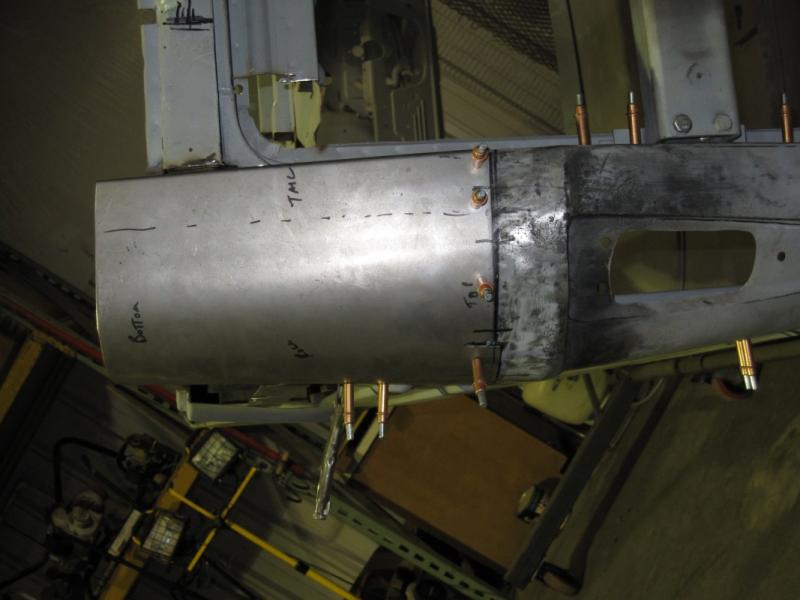

Worked about 4 hours on Thursday beating the PS quarter back from nothing. Then spent another 6+ hours today fine tuning it and working on the lower quarter panel. It may not look like much, but given what I started with, I am very pleased. There will be very little filler. After blasting away the bondo, the qtr was really smashed in. Took lots of time working the metal to get it back to specs. Great upper body workout. You can really tell these trucks were all hand built. The original part was hand hammered IMO bc the entire piece has hammer marks all on the inside, before I started. I included some before pics.
