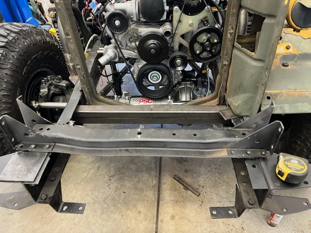

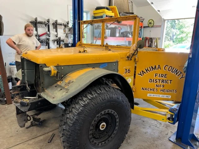

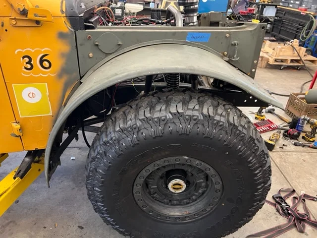

Okay, working on locating the radiator so I can get a final size and get it ordered. Which means getting the fenders on and in the right place - since there's nothing left to locate them anymore, I was floundering until I found the picture I took with dimensions - thank god. And that showed me that where I thought it needed to go, where it looked good was 3" back from where it should be. It's so flexible, just a giant curved piece of sheet metal, it doesn't 'know' where it wants to live.
Originally, which I had to take the massive front cross member out for the front axle and steering, I put a temporary cross member in place just to hold the frame together, and it is right where the U needs to go. The two bolts in the bottom of the U that bolted to the lower cross member should be at the right edge of the temp cross member. So, it has to move.
So, the question is, what do replace it with. This is an important cross member. It holds the entire front of the truck together and in place. the next cross member is for the transmission. So, I need something substaintial.
Options are, move this 3x3 piece of box tube. forward on the frame about 4" (figuring out how to temporarily brace the frame). Get a bigger, beefer 4x3 box tube and put it about 4" forward. Or modify this stock cross member by cutting it down and bolt it in. The advantage of the stock is it's low profile. My concern is would twist a little under load. thoughts?
If I got with box tube as the most structurally rigid option, is the 3x3 enough? Or is it worth it to go to 4x4. My only concern is I have no idea what might want to live there (like electric motor for winch) in the future. Real chicken and egg problem.

When I kinda did what you're doing with an M37 I left the entire clip attached to the cab and it went up and down with the cab sitting on the 2 post lift arms. I don't do bodywork stuff so I guess I have that luxury to just leave it alone.
I thought that front single rubber body mount was the cheeziest thing. If I didn't have to use it I'd have chucked all that garbage and mounted the body like a normal vehicle.
As far as a crossmember goes it needs to match the rest of your frame's design. Is your frame bendy loosey goosey? Then you shouldn't make any one part of it super rigid- It will crack right where you do that. Is your frame super stiff with crossmembers all over and a cage tied into it? Then keep that trend and build it stout.
When I reconfigure a frame I put crossmembers where the frame will be acted upon- Where links and springs connect. Where the body and powertrain is being supported.
How you size and construct your crossmembers has to do with the rules of good weld joint design. The material thickness of your crossmember should be the same/similar as what you're attaching it to. If it needs to flex, don't make it super beefy.
the frame is boxed from more or less the radiator back to the rear ORI hoops. So that's stiffened it up. there's a cross member at the trans, after the rear output of the transfer case, and the very rear of the frame. A lot fewer than there were originally. I'd always assumed once I knew what was where, I'd have to go back and put more support in. There's nothing around the motor mounts or front ORI mounts because there's no real estate to work with. the upper links are right up into the frame at full stuff.
So, this is going to handle all the frame torque from the trans mount to the front of the frame. Right now, I'd say it's pretty loose, as even though the frame is boxed, there's not a lot tying the two sides together. the trans mount is holding the trans and keeping the frame the right distance apart, but it's not doing a lot to make the frame more rigid.
Okay, the fenders are back on and I've gotten them in the right place - finally. After some searching I finally found the right radiator from champion (easier to find on ebay than on the champion site). they say it will come Aug 2, which is quite a wait. But ... this was one of the last steps that I wasn't sure about. Now that I know it all works, I can plow ahead with hydraulic plumbing, brake hoses, clutch hoses, drill the knuckles out to 3/4's of an inch, figure out to get a steering wheel on. And I think I'll be able to start it and pull it out of the garage.

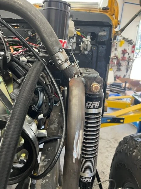

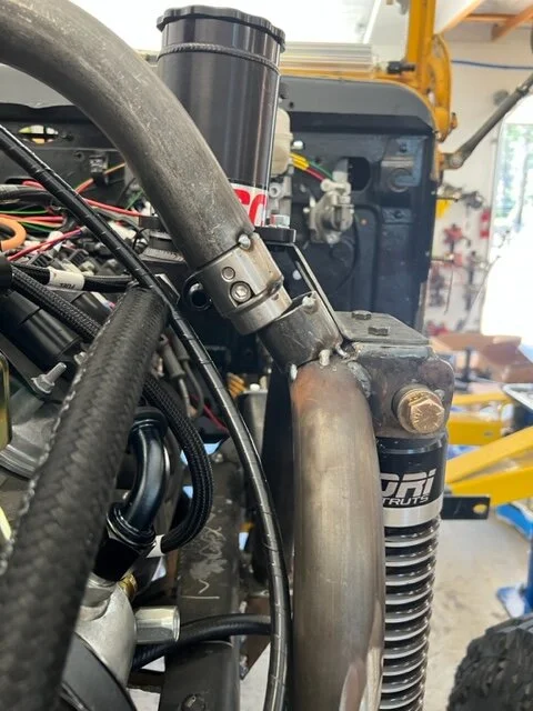

So, was working on they hydraulic lines and had to pick the rig up and it went from this - at full stuff, all weight on the ORIs and hoops. See how the cross bar is in the right place.
To this as soon as the ORIs were unloaded and the weight was back on the frame.
Broke the tack that was holding it.
To this when all the way up and the weight of the axle is hanging from the ORIs and the hoops. It's a little more out of whack.
I'm guess that I should break the center join of the cross bar, which is only tacked, and reset it so when the load is neutral on the hoops.
I just thought it was an interesting example of how much movement there is in a frame - even when the rig is sitting stil.

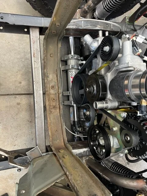

PSC full hydro plumbing. It took 2 calls to PSC to get this right. Here's how it's supposed to look (and I didn't find any examples on Google that were right.

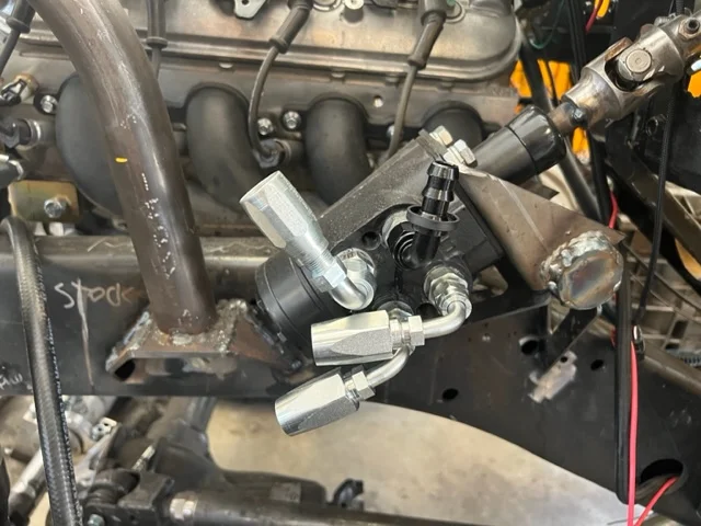

This is the full hydro kit with remove reservoir and upgraded to AN -8
So, the big connectors - the AN -8 - are for the supply and the return. You get two high pressure AN -8 90 hose connectors, one for the orbital (upper left) and one for the PS pump. And 3 lower pressure AN -8. one for the orbital, upper right, and two for the cooler.
The small AN-6 connectors are for the lines going to and from the orbital and ram. They go on the bottom or driver's two ports on the orbital and each end of the RAM.
Orbital. Top right is return - so it's low pressure AN -8
Fortunately, these sit right between the oil pan and the harmonic balancer.
the reservoir get the AN -12 connector for which there is also one on the top of the pump with 3/4 hose. For me, the straight and the 90 they sent won't work. I have two AN -12-3/4 barbed fittings coming for that. The other connector on the reservoir is AN -8 low pressure that takes the return from the cooler.

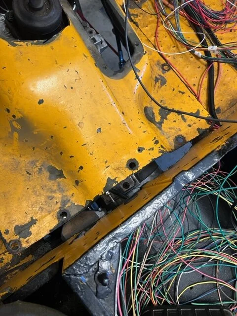

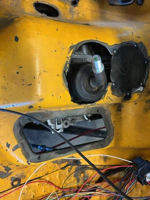

So, while I'm waiting to figure out the headers, or for the headers to figure themselves out, I decided to work on the cab and getting it back together. And ... the transmission hump is going to require more than a little massaging. the transmission is much wider and a little higher than the original and a couple of inches to the passenger side. and the second shift platform, which I'd hope would be perfect for the Atlas shifters has to go 2" to the right as well - and it has to accommodate 3 shifters.
So ... I'm trying to decided if this can be modified - and they would be major modifications, or if I just build something from scratch. Either way, this is a several day project. It's hard to tell, but at the rear, the hump is about 2" off the floor.
Didn't it have 3 shifters plus an E-brake lever before?
The one I did I used an NV4500/NP205 with twin sticks and installed the NP200 e-brake on a 1410 yoke on the 205 and retained all the original shifters with rod end linkage.
