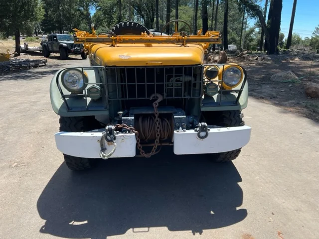

1953 Dodge M37 wheeler conversion
Sep 17, 2006
500
3,171
Santa Rosa, CA
So, I'm starting a build thread for my M37. The last thread was contemplation and planning and it seemed to make sense to start a fresh thread.

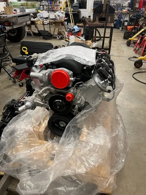

The plan is ... 6.2l LS3 from Chevy Performance. Which is here. Tremec 4050, which will be here soon. Atlas 4, which will be here in 16 weeks or so, Dana Pro 60 up front, which was half off and is here. And 14 bolt that WFO is building for me which will be here in a couple of weeks. So, in 2 weeks, I'll have enough of the drivetrain to start looking at engine and transmission placement and axles to start looking at axle and suspension. I had been looking at keeping it leaf springs, but looking at the age of all the hangers, I've decided that it will be the same amount of work to go head an 4 link the rear and 3 link the front. We are going to full hydro this rig, so maybe we can 4 link the front? We'll see what the packing looks like. the frame is very much like an fj40. It's very narrow up front. I'm assuming it will have similar trade offs.
The first task was to get the bed loose. Which it is. Once I can get the bed outside, I'm going to have someone come and sandblast the inside and I'll bedliner the inside, leaving the outside the same. Every single bolt had to be cut off the top.
Actually the very first step was to get the massive Barden winch off. I found a guy. The idea is to rebuild it and convert it to hydraulic. It's possible, it's been done. The rig just doesn't look right without. So, planning on running it off the PSC pump that's going on.
Next step is to take the entire front clip off in preparation to remove the drive train and all the crazy electrical stuff.

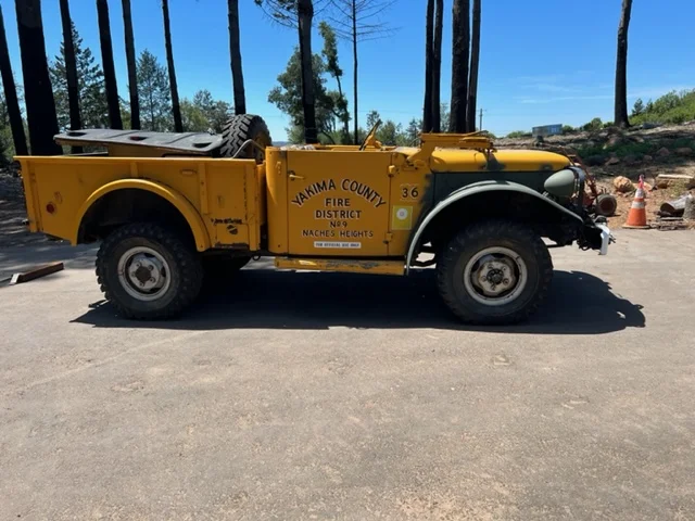

Amazingly, I got connected with a guy out by Lake Berryessa who restores 40's and 50's power wagons most, but some of these also, for a living. He's going to rebuild and convert the winch for me, but also, in 2020 his shop was burned to the ground with about 40 power wagons in various states of restoration. One of the ones he lost was for a Vietnam vet. He's coming to come over and help me tear it down in exchange for getting the drivetrain and axles to build a new rig for this vet. So, I'm very happy to make that trade and get access to his knowledge and expedience.

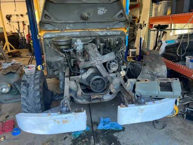

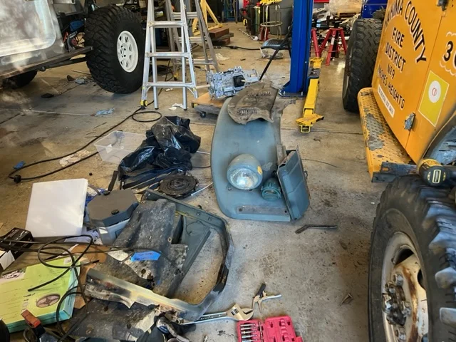

The front clip is off because I found the guy in the next county who restores M37 and old power wagons and he wants the entire drivetrain for a charity build he's doing for a Vietnam war veteran. So, he and his son are coming tomorrow and are going to spend the day taking the entire drive train out, down to the axles, and take it with them.

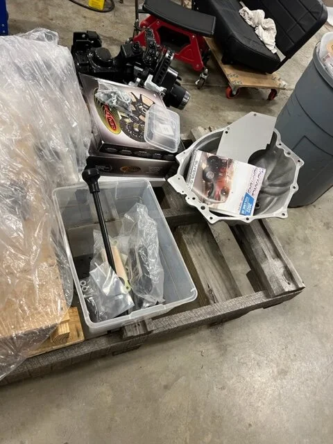

I'll end up with body and frame. Tremec transmission arrived and there's a 14 bolt waiting for me in Auburn when I have time to get it.
Peter, looks like another fun build. I want to run a tremec 4050 in my 45, but my atlas is 32 spline.I understand the tremec is 23 spline. Wonder if I can swap my 32 for a 23 input gear?
Yes, I'm sure you can - just call AA and they can send you the right shaft. Only pain is you have to tear it down to swap it.
Okay, so, this guy Fowler out of Napa county near Lake Berryessa who restores old 40's power wagons for a living showed up with his son and over 2 half days they ripped out the drive train and the axles and left me in good shape. Also - 40'S SHOWED UP!!!

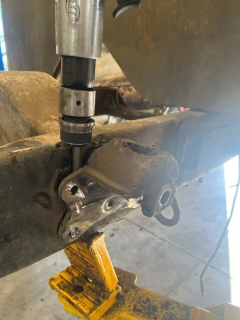

Sandblaster is coming next week, so I've got to get the frame fully stripped, which means breaking a lot of rivets free - and not the cheap ass rivets on an 80's truck, but real rivets - and the cab off.
That’s when the rivets were made outta real steel. Great start I look forward to see more…
Oxy torch with a scarfing tip makes pretty quick work of rivet heads and just needs a quick touch with a flap wheel to clean off.

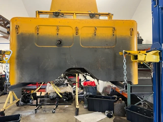

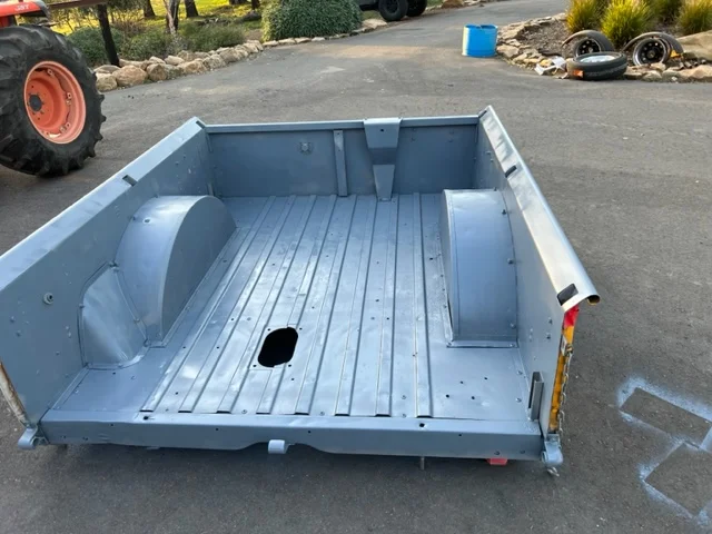

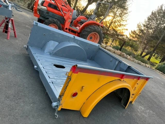

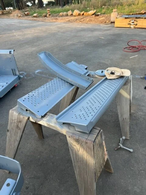

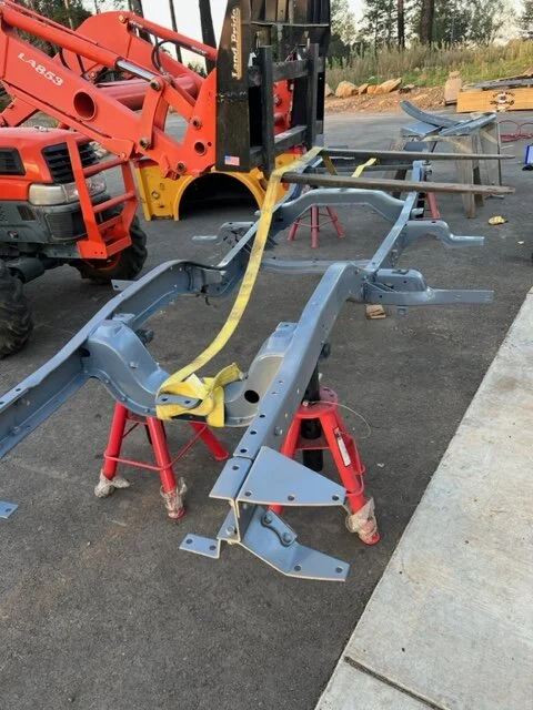

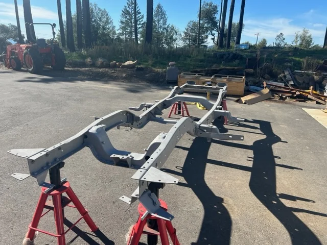

Okay, the cab is off the bed, the frame is stripped, and bed and frame and a few other parts have been sandblasted.
70 years of grease and old paint removed.
I hopped right on it and put 2k primer on everything - it's Raptor primer so the bed is ready for raptor bedliner

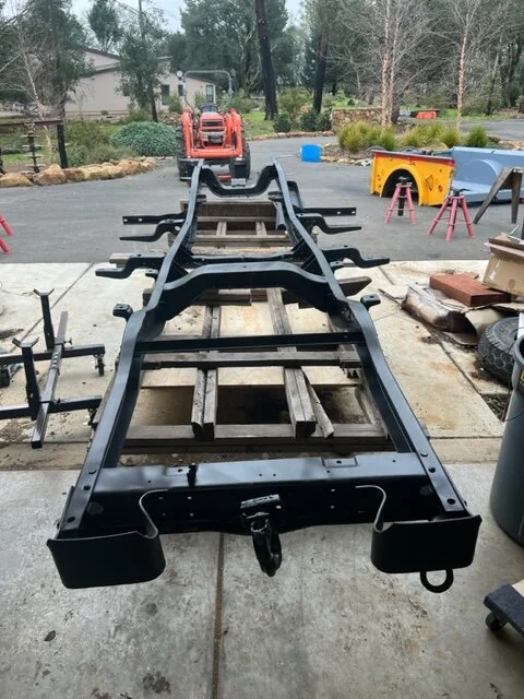

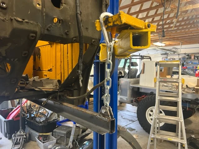

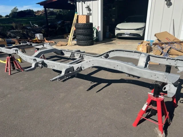

I got POR 15 on the frame, and had to figure out a fixture to lift the cab up. I did not expect that to be quite so complicated. But, now I can lower the cab to check fitment as things progress.

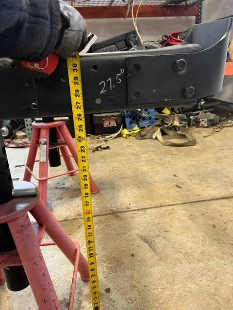

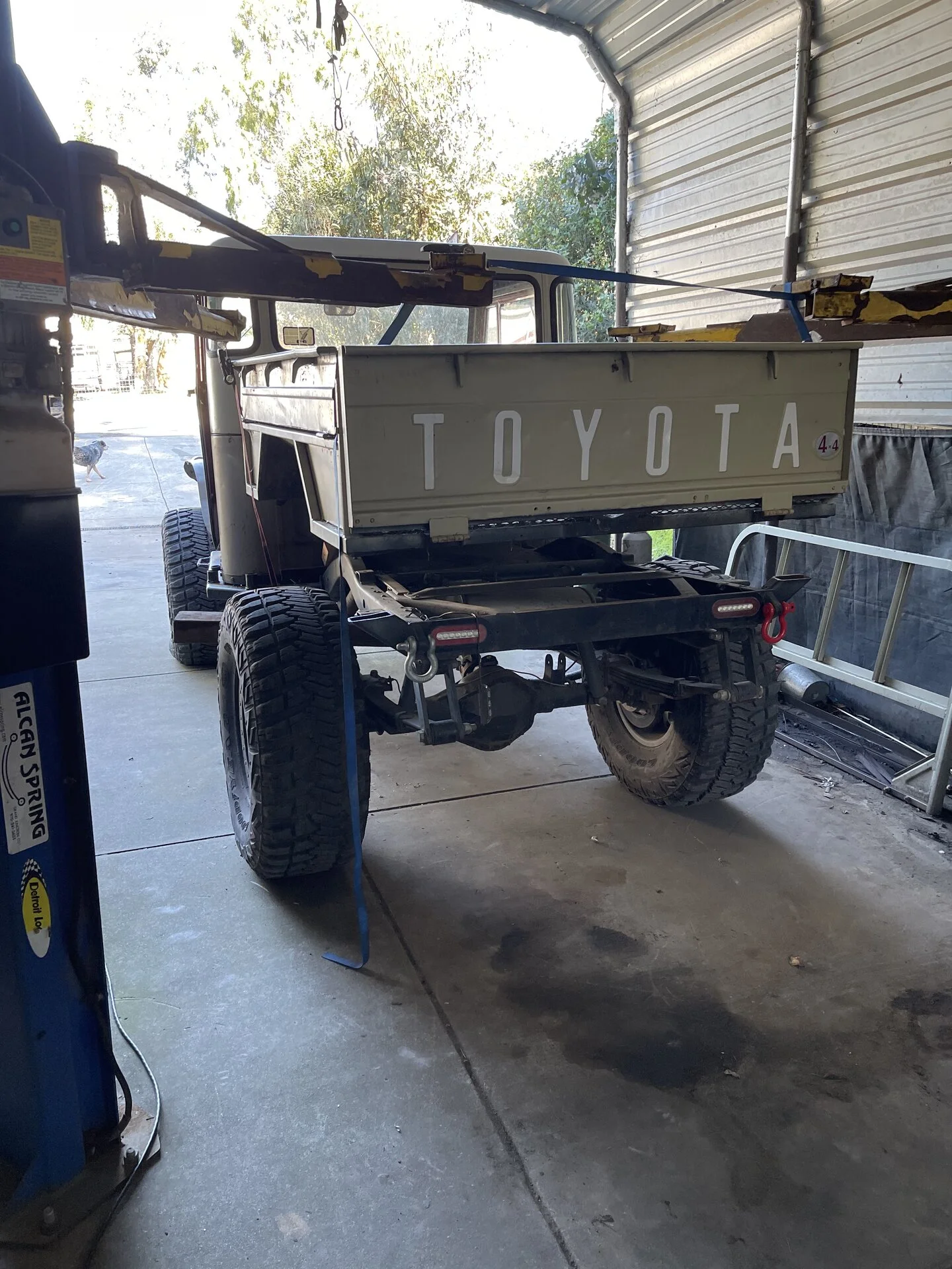

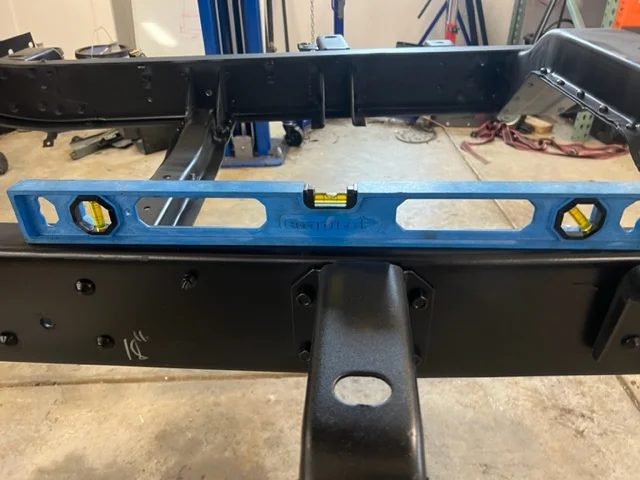

the frame is back under the cab. I put the cab up backwards, so I had to put it down, spin it and put it back up. I have the frame set level and roughly at ride height.

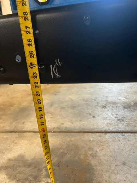

However, I'm trying to figure out what ride height was.
In the back, it was 17.5" now it's about 26"
But, with the frame 'level'. the front was 22.5", but now it's almost 31" over 8" higher than it was.
The center was at 18", now it's at 22", 4" higher than it was
So, it was massively sloped forward.
So, the question is, do I need to continue that???
In my limited experience, I like the bottom of the frame in the middle about 20" clear. So, I'd come down 2" from where I am right now. the front is still way in the air. Right now, I can't think what problems that would cause. In fact, I think it would make sticking the panhard bar easier, but the angle woudl be severe (or require tall brackets) and I'm going to need a big drop in the pitman arm.
