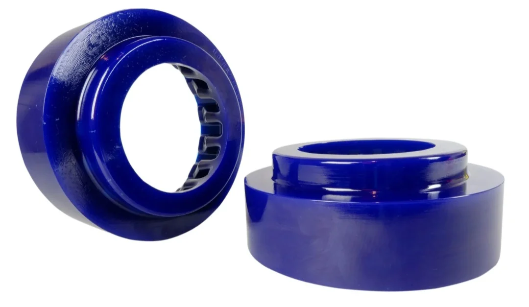

Those spacers look to be made specifically for the Sequoia?
I've seen guys brake the 5100 shocks when adding lift if they don't use shock extensions on them.
Yeah, I was thinking about the shock extensions. Thanks for the heads-up.
Yes, the spacers are specific to the2G Sequoia.
I've seen too many problems with PU spring pucks. Everyone ended up redoing their lift correctly, without anything attached or touching the springs.
