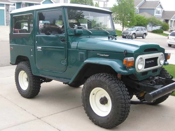

My factory chromies are in excellent condition but I was (even) thinking of going with a non-steel that could be painted. I've been looking around for a spoked design that had as few "spokes" as possible. I guess a star design would be a better description.

you want rims from: Stockton Wheel
Jacket here on mud has them on his rig see link for more details:
https://forum.ih8mud.com/40-55-series-tech/223758-belated-intro-76-fj40.html
see post #5
these stocktons are quite rover looking...... see link for a comparison: LANDROVER SPECIALIST SIMMONITES WHEELS
the nato rims or Wolf rims have way too many holes for my likeing ;)
Thanks JonnyC...I agree about the holes on the Wolf's. Too many holes for my taste too....Yes, that 40 is what I'm thinking about....Also, thanks for the info concerning the split wheels !! :clap::clap:
