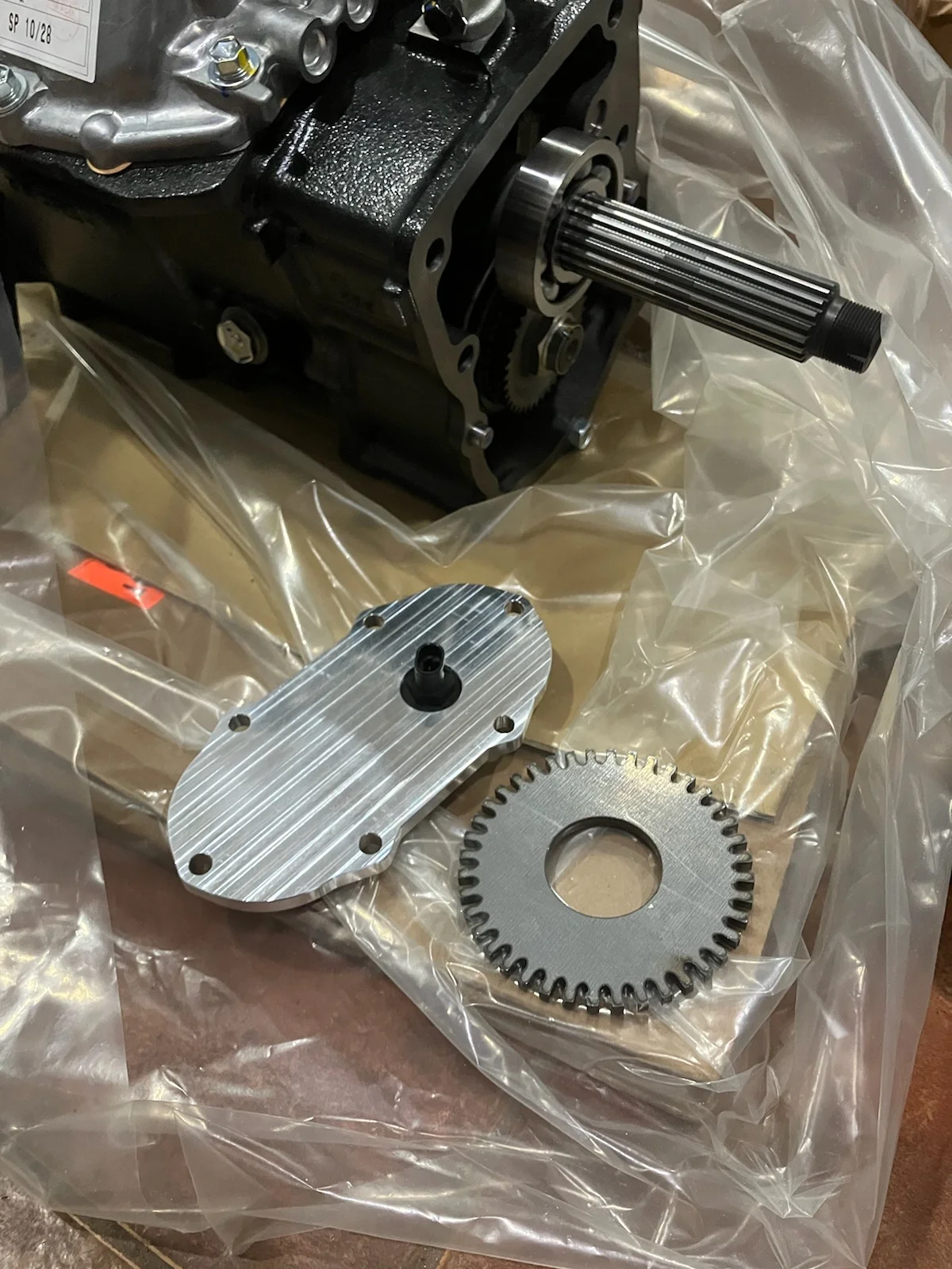

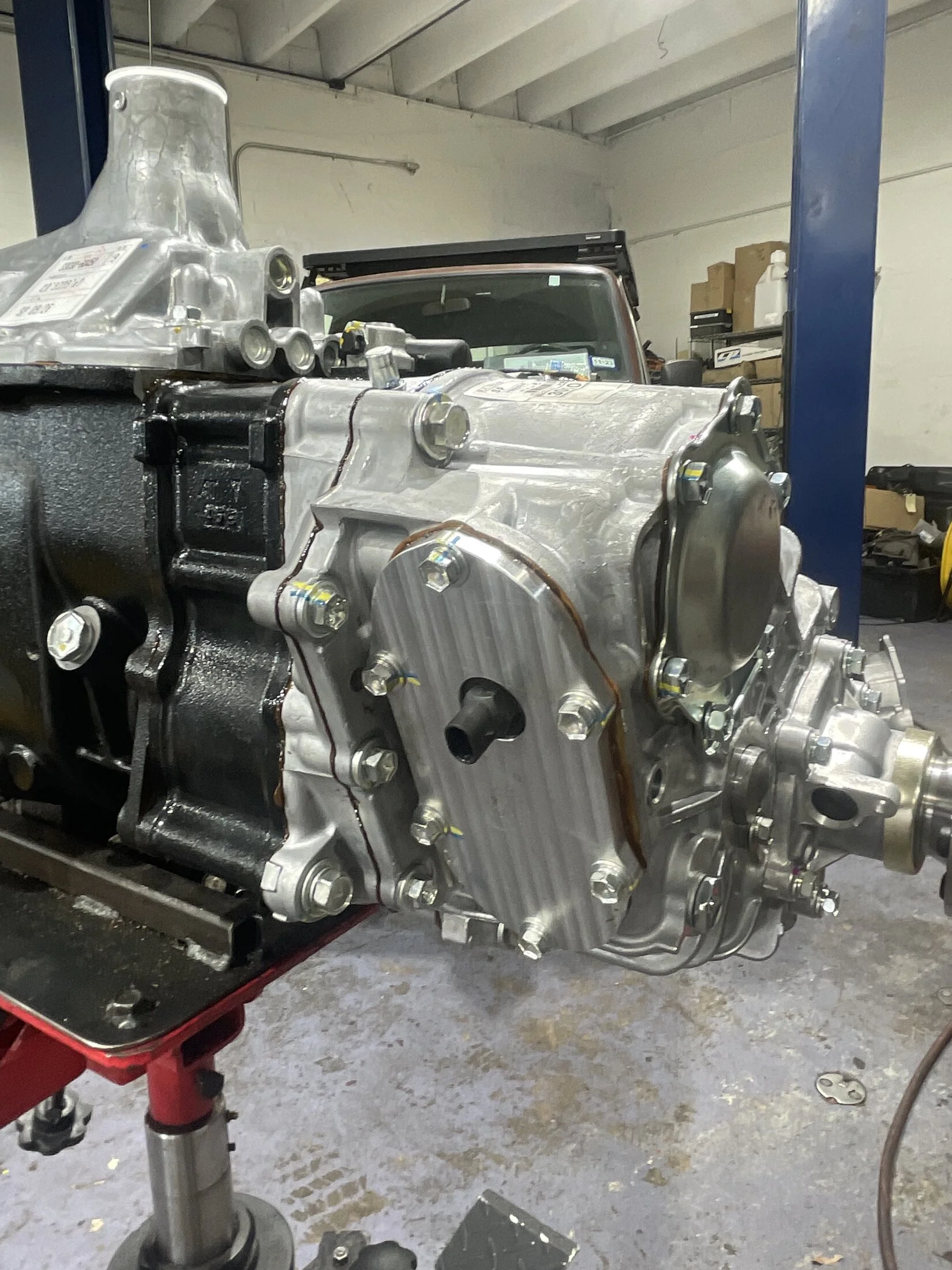

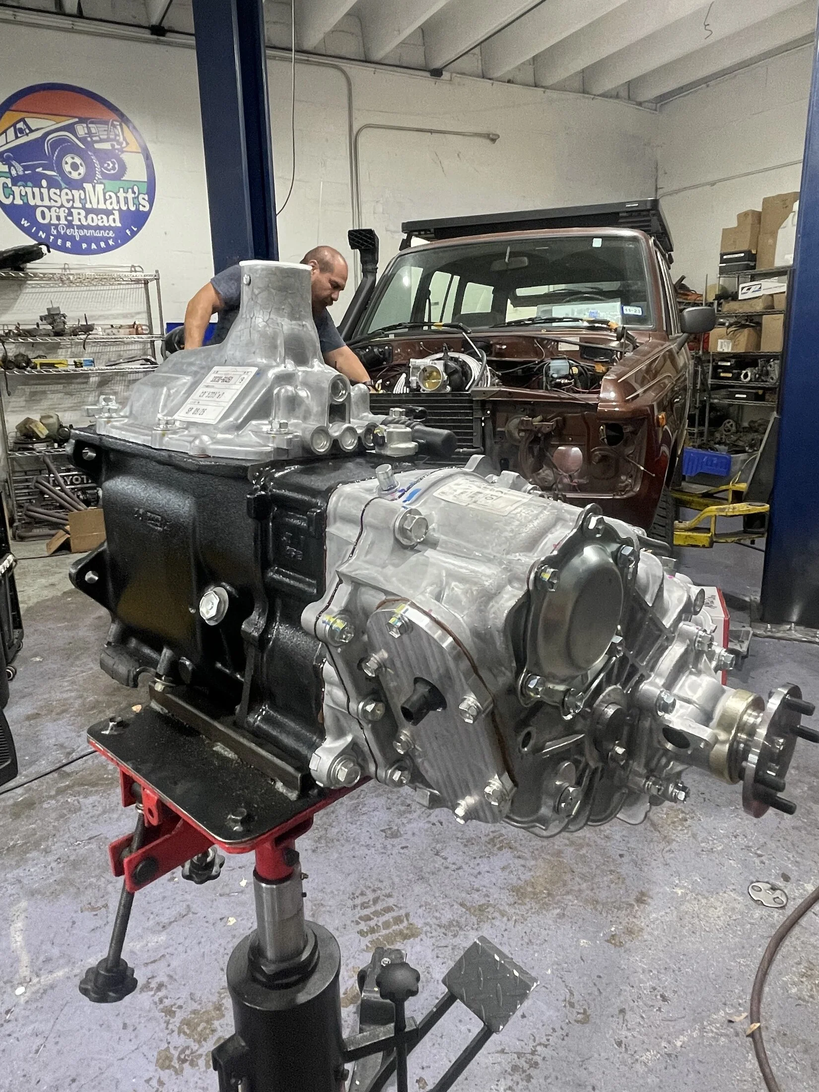

We are selling tons of swap kits for Gen 3 LS conversions to owners retaining their H42/H55f transmission so I came up with this as a bit of a cleaner (and a bit more budget-oriented) solution.
They are designed to read off the PTO gear or off an optional weld-on tone ring for those with long-spline input gears.
We still have some testing/install to do before releasing to market but I was excited to share. :)

Have you welded a tone ring onto a long spline input gear yet? I'm honestly curious to see a visual.
Smart thinking too with having it be able to read off the PTO gear.
Yes, that's what is inside the case pictured above. I'll see if one of my guys got a picture

Kits are tested, in stock and ready to go, with the exception of making the jigs which will be included) for setting the height of the weld-on tone ring for those running long spline input gears.
I would want to take some example pictures of that process as well
