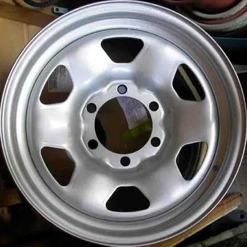

Well, I'm looking for a set of steel wheels for my fj62. Been considering Fj40 15' steelies, Non usa spec 16" splits, and then I found this wheel. I can't find a picture of it anywhere and not sure if it will fit.
Its a toyota pickup 16x6 steel wheel. Anyone know anything about these wheels? Its got a toyota part # on it. Called a local dealership and the wheel didn't even show up in their system but did come up when I gave them the part #.
Anyone know if this wheel looks like the FJ40 steelies and the Non USA split wheels?
It may be great for people looking to run a simple 16" wheel but don't want to fool with the danger and hassle of the split rims.
i had the part # somewhere but lost it... it's a basic wheel 5 or 6 spoke but looks cool... came on lower model trucks..
4-5" bs////the part # in the faq under wheels and tires after market wheels

Thanks for the input guys and replies.
I've got a stock set of chrome ones on my 62 right now. I'm really looking for a set of 16 inch non split wheels that look like the fj40 solid steel wheels that take the hub caps or the split rims. But it appears that these wheels dont exist, at least I cant find any.
I thought that the 16x6 steel pickup wheels would be styled like the fj40 steel wheel but it appears that they are not.

Most of the Toy pickup wheels, especially those meant for IFS trucks will have serious backspacing issues, You'll have to run anywhere from 1 - 1.5" spacers to get them to not rub.

Nope, those are the 16" Toyota "Skinny Steelies". I have them on my truck, they are the same as Brownbear's, fit the 60 and the 80 series just fine. Perfect for 235/85R16s. Available in Canada for around $80 at the dealer, but about $130 in the US, I suppose they are made here in Canada, otherwise how can you explain the price difference?
Although they are not chrome, they look pretty good nevertheless. The coating has survived one salty canadian winter with only a very slight staining at the interior seam where the disk welds to the rim itself, but it's very slight and can probably be controlled with penetrating oil and vaseline...
They are almost identical in backspace (I believe by 1/2 inch) and width and they fit on the BJ60 so in essence, yes they should fit.
If you insist I'll take a closer look and measure, I have one of both lying around.
