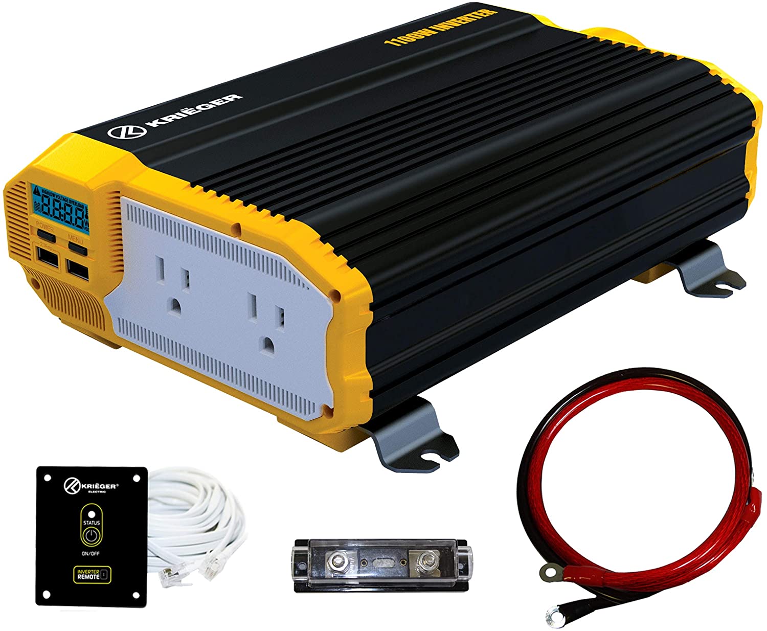

For those that are running 12v - 110v inverters who are you using and why? I am trying to find something similar to the Krieger system. I am not a fan of the external LCD display as I plan on running something that will mount to the plastic 1/4 panel. Also looking for options/opinions on 110V plugs that can be installed in the plastics of the 1/4 panel.

I've got something similar to this:
Its mounted behind the panel in the rear on the driver side, hardly ever use it though. Accessable by pulling the jack access cover.
Thank you. That is close to what I am looking at with the Krieger inverter. And I think I have found the right adapters to accommodate the 110V plugs issue.
