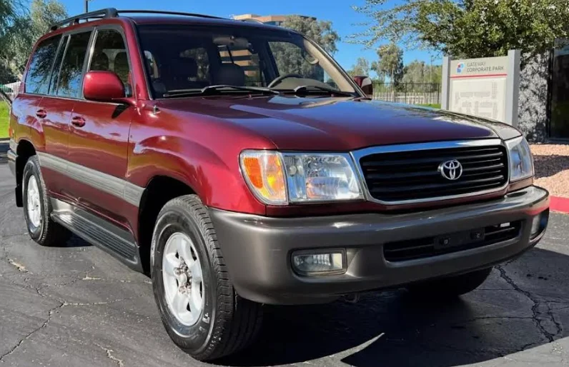

I just bought a 2000 LC that is in great condition with absolutely zero rust or mods. It has 218,000 miles but a robust service history. I love the Land Cruiser, and especially the 100 series with the 2UZ-FE motor because of its bulletproof reliability.
My question to the forum is, if money were no object, what needs to be included as part of a lift to maintain or improve factory reliability and ride?
Right now, I have the following parts list. Please let me know what I'm missing. I don't know much about this and I'm trying to learn all I can so I can do it right the first time.
Lift with factory reliability? The answer is actually "Body Lift."
Anything adjustable or changes the CV angles will be less reliable. Anything that changes the spring rate without additional weight will not ride as well.
I am planning on adding additional weight. I have a set of Dobinson's drawers, a Front Runner roof rack, Slee slider steps, and a full steel Slee skid plate kit that I am going to move from my 1999 to the new one. I am also considering front and rear bumpers but am unsure right now.
I don't pretend to understand the suspension system on the 100, but I have had lifted GM trucks before and there were kits to drop everything down to maintain factory angles. I was hoping that what I listed above would serve a similar purpose on the LC.
I hate when things break and I want to keep it as reliable and comfortable as possible while improving capability where I can.
