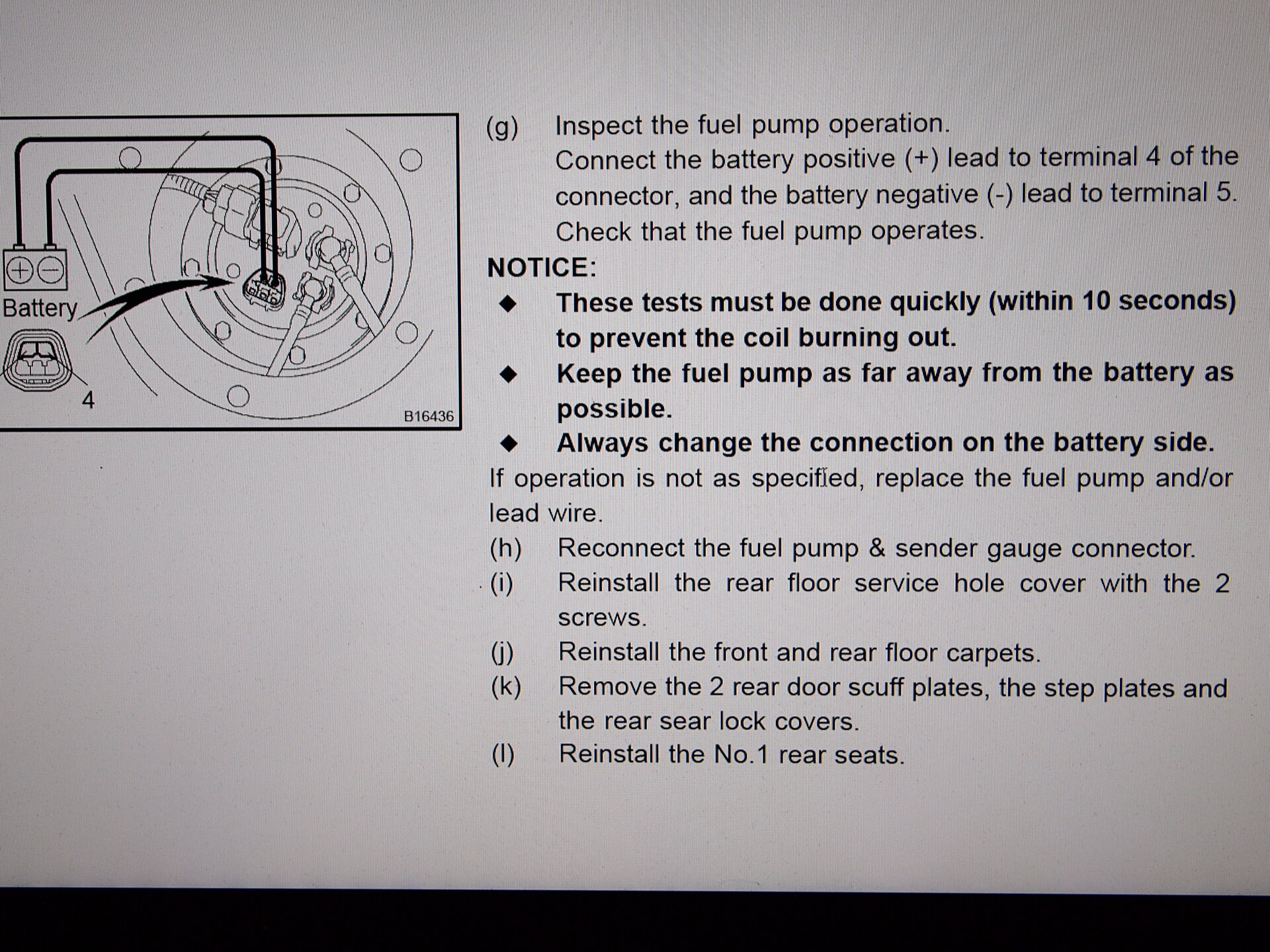

I'd jump the pump with 12Volt. Make sure it's working. Then move on to end to end fuel circuit testing. this is best done using the FSM (factory service manual) step by step tree.

As I suggested. Testing fuel pump is where I'd start. Making sure I can hear pump run, fuel flows from filter and pressure within spec.

Thanks for the connections needed to power the fuel pump and confirm operation.

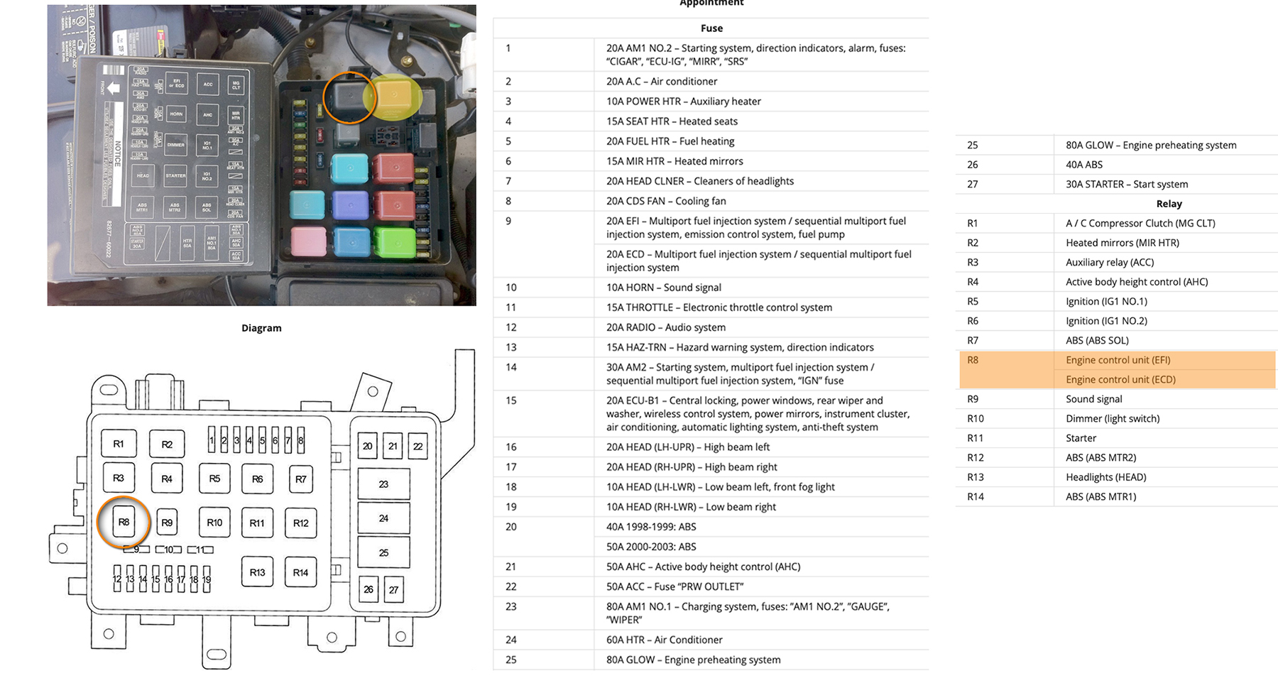

Would a cooked EFI Relay in the Engine Room Block Assembly disallow "signal request" being sent to fuel pump?
This one...(Orange circles/highlighting - not yellow oval)
Forgive me if that's a stupid question...
I would ass-ume we need a functional EFI relay to power the pump.
