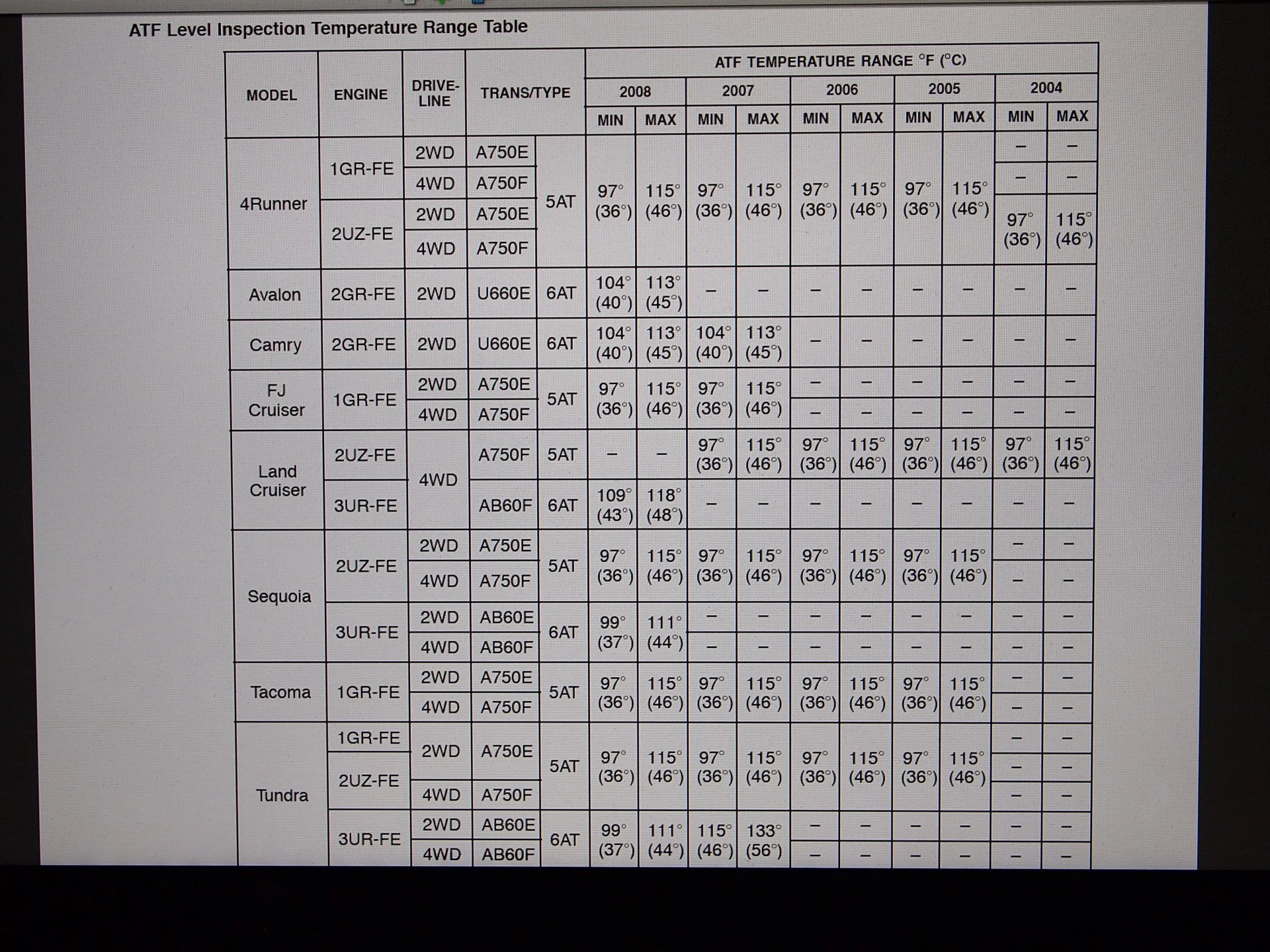

Warning.: The dash light paper clip method will not work, as it is set at old "higher" temp (lower fluid level). You need to read temp, which is best done through tech stream.

Toyota has a TSB on 04-up transmission in the 100 series, which changes ATF temp used for topping. New temp is 97-115F.

You must read ATF temp, to set transmission level. If you do go to the Dealership. Make sure they know about the TSB, some don't.
