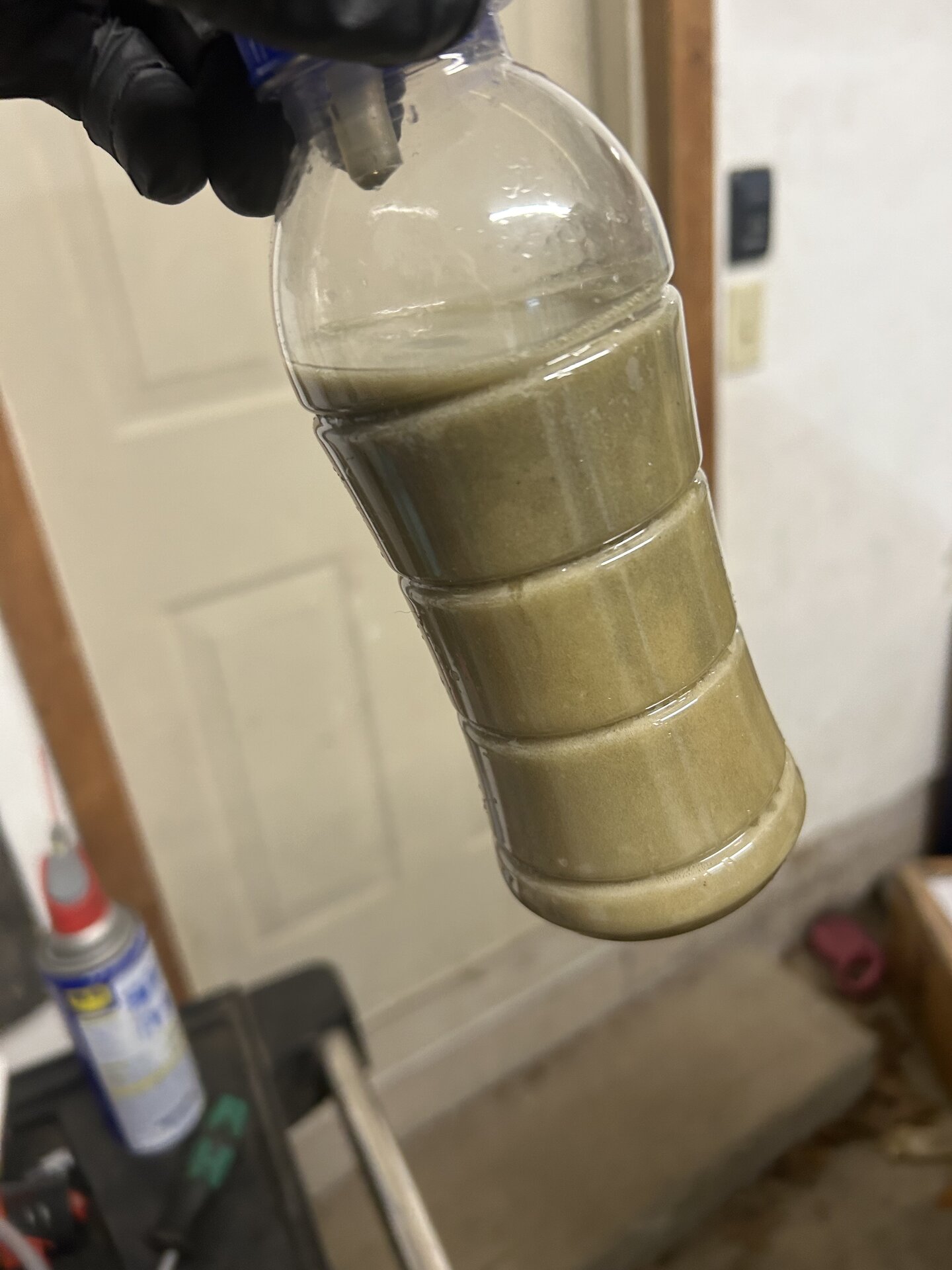

Initial maintenance that we have already done: Oil change and filter, transmission fluid flush, radiator flush, power steering flush plus replaced lines, replaced timing belt and water pump plus pulleys and tensioners, replaced serpentine belt. AHC fluid was nasty and low. AHC would not go to high and showed an "Off" message. Replaced with new AHC fluid and bled. AHC now works. Replaced spark plus. Replaced heater-t's (good thing we did this as one was disintegrating). Cleaned the throttle body and the mass air sensor. New air filter. New battery. I can now confirm that my father does not know how to maintain a car. See the pics of some of the fluids.

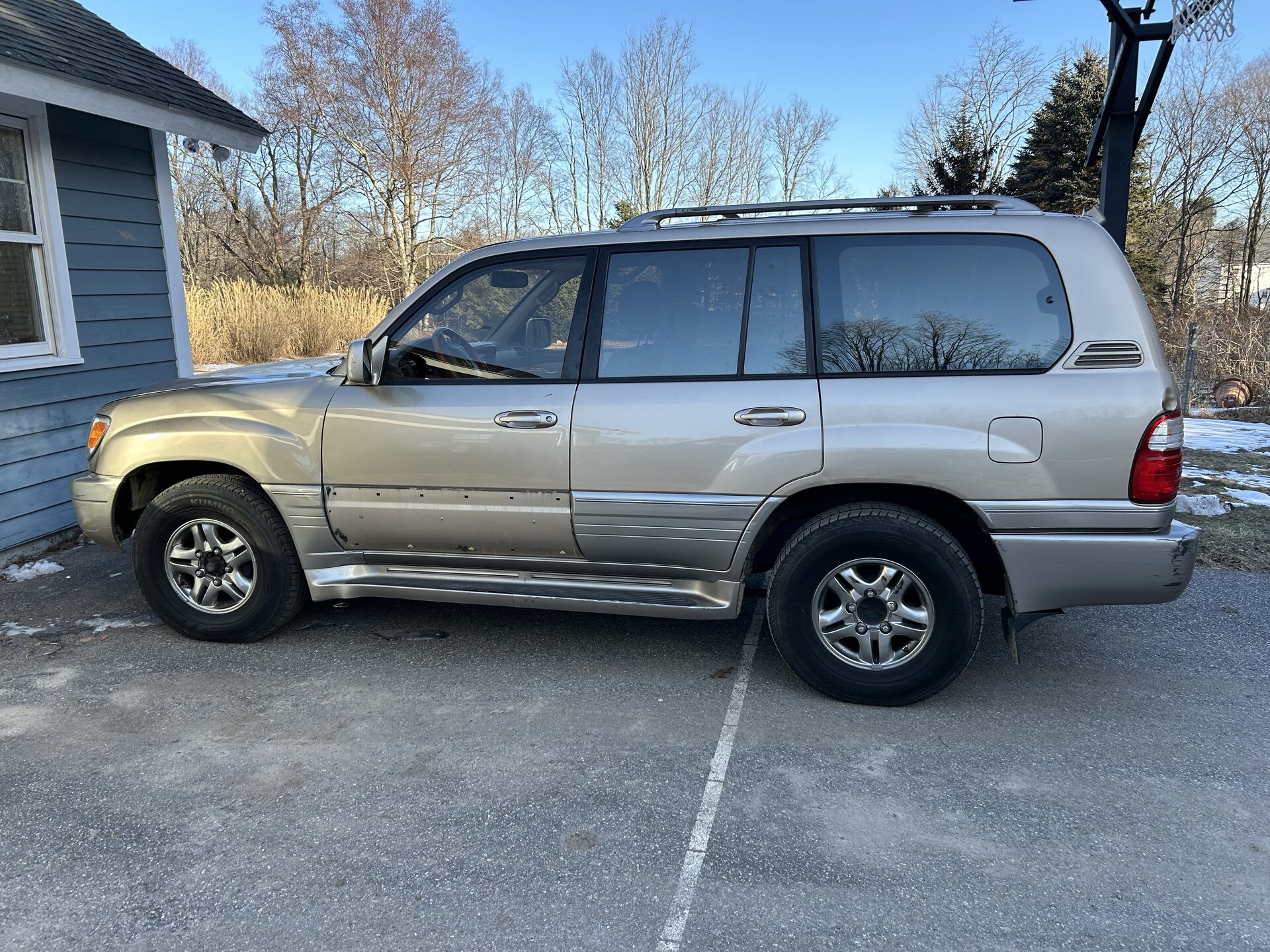

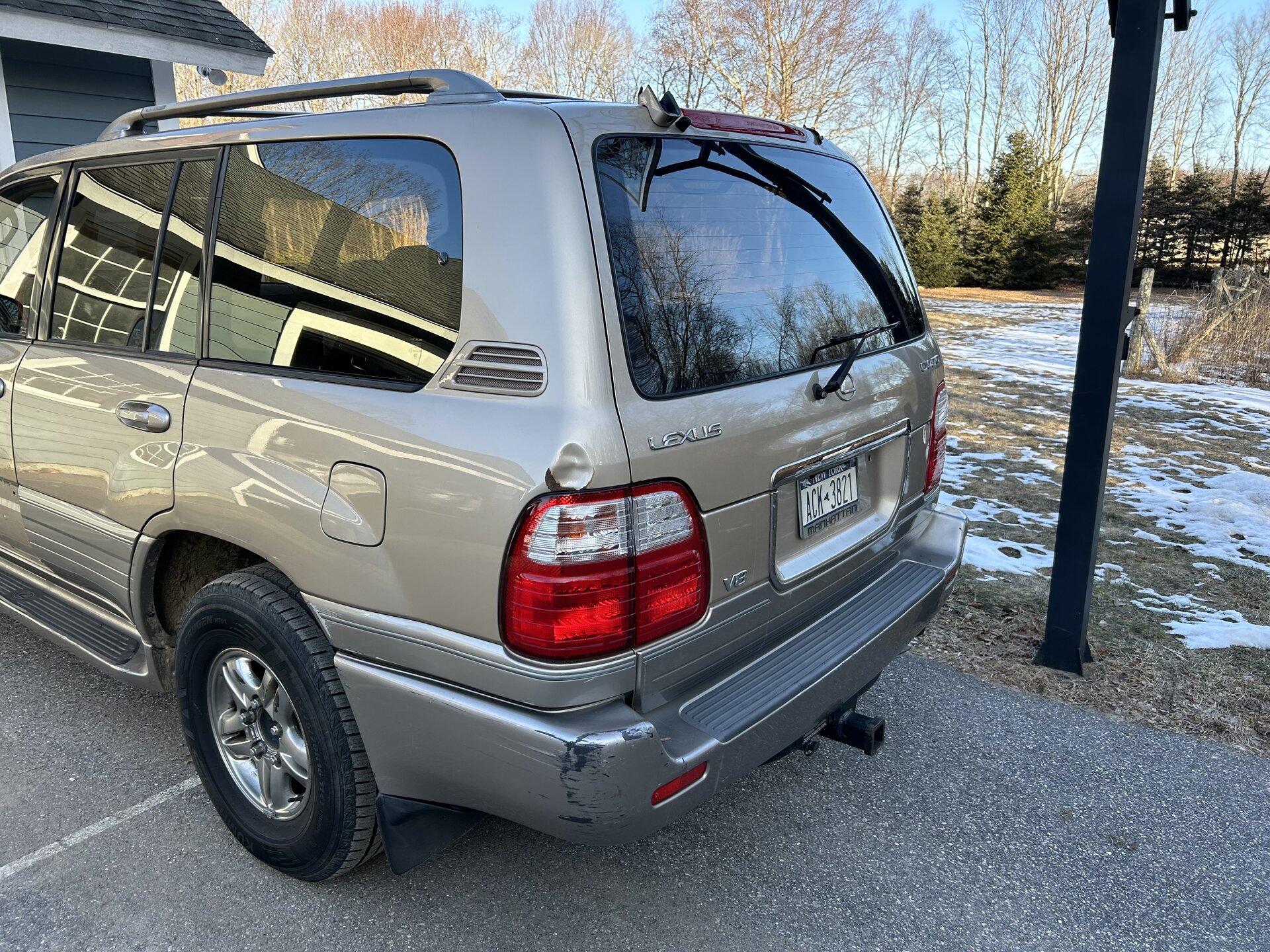

Exterior: haven't done much yet. Just removed one piece of cladding. Lots to fix in this area. Some starter pics below.
Stuff I need help with: The passenger side view mirror housing is cracked and separated. Very expensive to replace the whole unit. Any ideas on getting just the housing? The dark brown leather at the top of the doors and on the steering wheel has areas that need to be dyed back to color. Does anyone know the color code for this? Any mechanical/maintenance stuff I missed?
