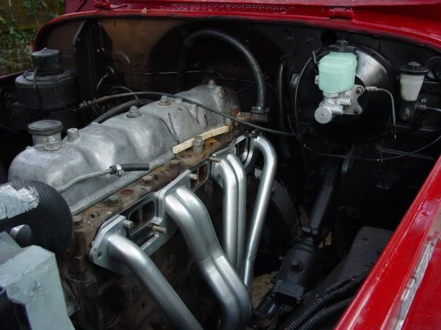

2f 1 piece headers. The old one leaks bad out the exhaust and I'm dieseling. Whats a good replacement.

Well I'm pissed. I just put in two stacked toyota gaskets and I still have the leaks in the same place. I even used copper sealant and it still leaks.:mad:
I guess new headers are in my future.
Mother Mary and Joseph :eek: Double G's and goo and it's still leaking. Pics or description of just exactly where the breach is occurring. But I think if the double G and goo failed that little bastage gotta be warped. When you get it off, put a straight edge across it....should confirm/coincide with the leak...get it machined flat and reinstall with double G and goo.

well I found the problem. when i broke 2 motor mounts wheeling. the engine was flailing around inside the engine compartment. it must have torqued the header. i should have known to check to make sure it was flat when i had it off. stupid me. i cut a couple of small wedges of metal a pounded them in between the 2 gaskets. will work until i can get one from marks off road.
