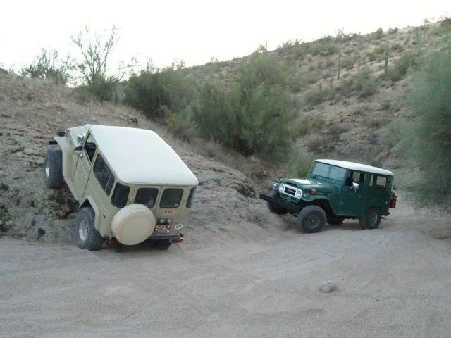

Mikes goal is for an old school look (uncut) with a nice ride and creature comforts. Running 33” pizza cutters we found he could stuff the front to the factory bump stops with stock springs and no contact. The rear needs about 2” of lift to level out the cruiser and keep the tires from bottoming out on the tops of the fenders wells. By using pizza cutters tires he will not need to cut the rear sheet metal at all. The skinny tires run deep in the sand and was real happy with the PS upgrade and will add a needed PS cooler before summer. The new cooling system also proved itself perfect lugging the cruiser thru miles of deep sand. Mike is on his way to meeting his goal.

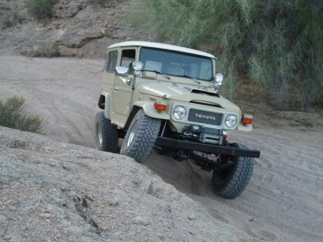

I recently upgraded graded my shocks to Bilsteins and the ride is soft, smooth, and provides full use of shock travel available with ease. With my current shock mounts I can only get shocks with 9”+- travel and for now that will be just fine.
