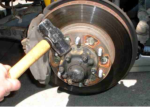

Won't a drift or a brass hammer help with loosening the cone washers. The FSM shows using a drift IIRC.
I've seen pictures of guys doing it with a steel hand sledge here, but that seems like a good way to mar steel parts.
Charlie
Charlie
I always just use a metal hammer at a nice 90° angle to the hub, like in this picture taken from George's site:
Just loosen the nuts a little bit, but keep them on the hub bolts for two reasons:
1. Keeps the cone washers from flying off when they loosen up.
2. Keeps you from marring the bolt threads if you should slip with the hammer.
