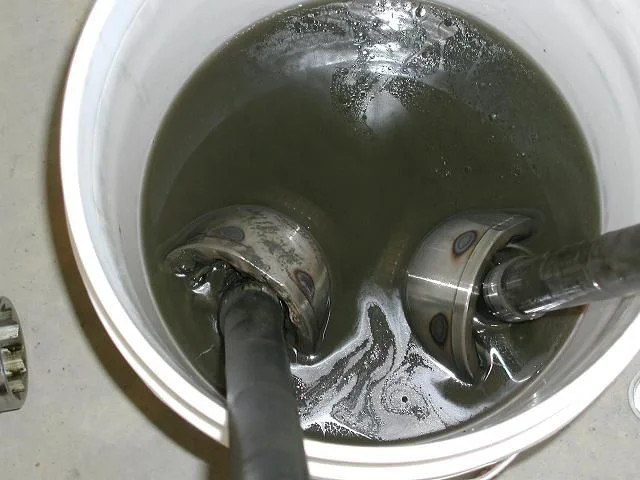

Get lots of part cleaner too...I usually get the 1-gal. container's from Advanced Auto (other places probably have them too). Clean everything nice and well. IIRC, I left my birfs. soaking in diesel overnight to get them really really clean.

Also, did I mention, clean everything really nice--bolts, nuts, hubs, scrape off the paper gasket from the hub real nicely (use a wire brush)...here are some pics for you....

I don't know if anyone has mentioned it, but make sure the flat on the birfield is at the top before you pull it out of axle. you can see the flat on the birfields in the bucket picture
