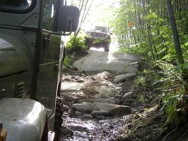

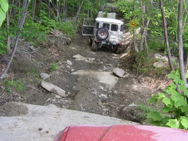

So I’m going down this steep rock, all of the sudden I am out of control. Rig went to the right and up embankment, (hit right at the yellow sign)…was riding on left tires and really thought I was rolling. I yell OH ****!! Really thought I was going over. My dog jumps in my lap, she thought we were done too. Then it went back left and came to rest against the left bank. May not look steep but it is. And the embankments are at least 3feet high.

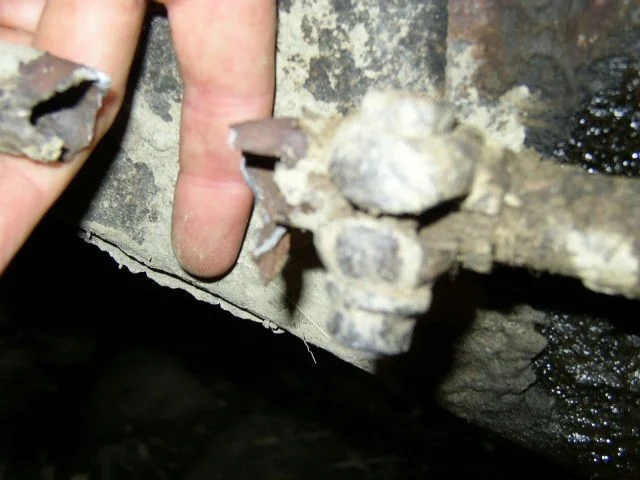

Steering wheel just spins freely. Something definitely broke. Upon inspection I see broken steering rod, right at the end connecting to pitman.

Here is a view looking up the rock. It is fairly steep.

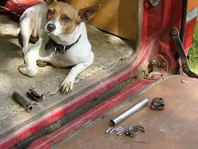

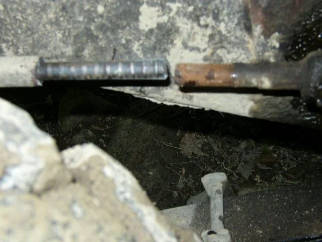

I cut off the end of the rod. Filed down a piece of rebar and hammered it into the end. I then cut a piece of pipe and slipped it around the rebar and end of the pitman link. Tried to clamp it, but clamps were no where near strong enough.
After a couple of hours of trying to band aid the *****, I realized I was not gonna get it done.

Looking at both failures, it looks like both of them broke at the end of the rod where the slots are. Is this because it was rusted out from moisture getting in there, and do you think you would have been noticed it during an inspection? Could it have rusted out from the inside without showing any signs of it from the outside? Especially the tie rod pictures, there doesn't appear to be any damage on the outside. I just redid my steering, but didn't really look at the rods real closely, I'm gonna have to go double check now.

aah yes so it is.. i added my pix as a reminder that it might not appear to be suspect..
the issue was rust with my tie rod, I have done a lot of beach work and it was easy for sand/mud/moisture to get into that slot, which rusted it from the inside out. the tie rod appears to be pretty thin walled tube to start with which didnt help.. either way.. glad you came out the other side unscathed.
